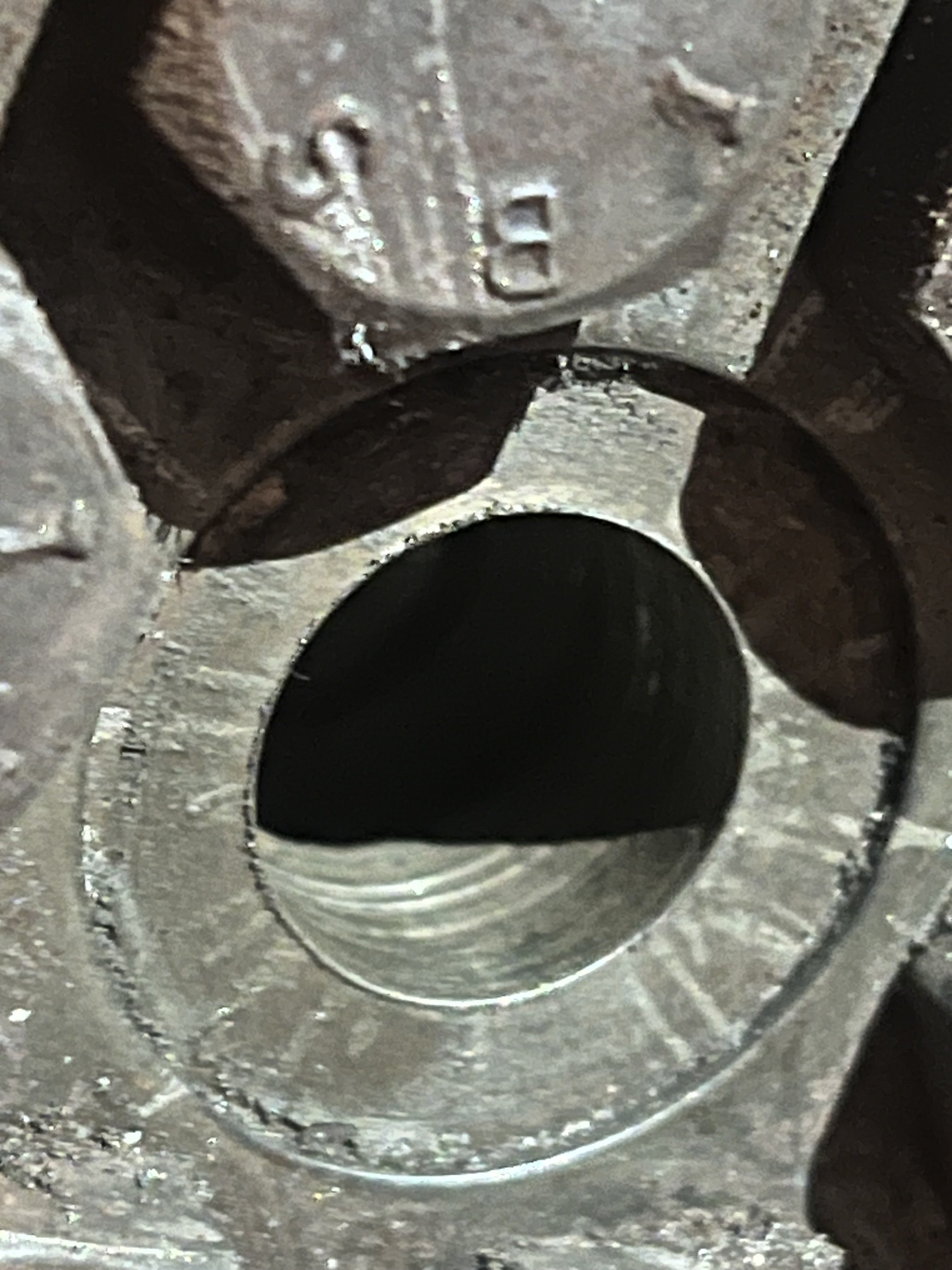

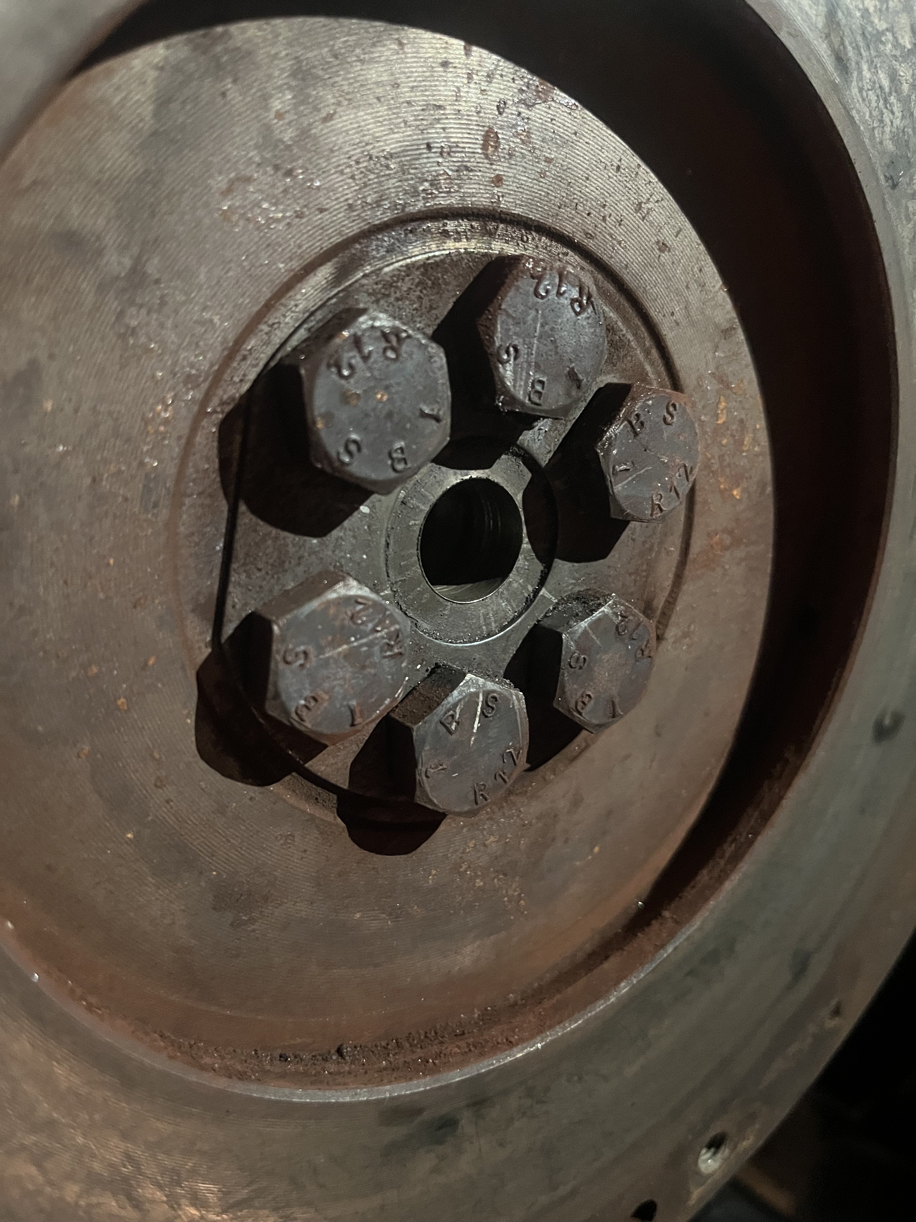

But one thing that came to my mind was;
Last summer I changed the clutch.
I saw that the bushing in the flywheel was really worn.
It was like 2mm bigger than the shaft on the gearbox.
Do anyone know if there is any new bushing to fit?

In the 60s we were often replacing those bushes, we used to pack them with grease and use a tight fit punch or an old clutch aligning tool to drive them out by hydraulic lock principle.
I would have thought most small engineering shops or someone with a lathe could soon turn one up out of bronze/phosphor bronze, then lightly oil or hmp grease it. It doesn't need to be too tight as that will cause a noise when you dip the clutch, which is actually the only time it gets any load on it.
Most modern cars don't even support the first motion shaft in the flywheel, the shaft ends with the clutch spline.:)
Having said that the 1.9 05 Doblo I had with 220K miles had the front bearing fail in the gearbox and it took out the gears inside it was wobbling so much when I bought it. Luckily at the time I got a s/h gearbox that had been reconditioned and only cost me £70.:)

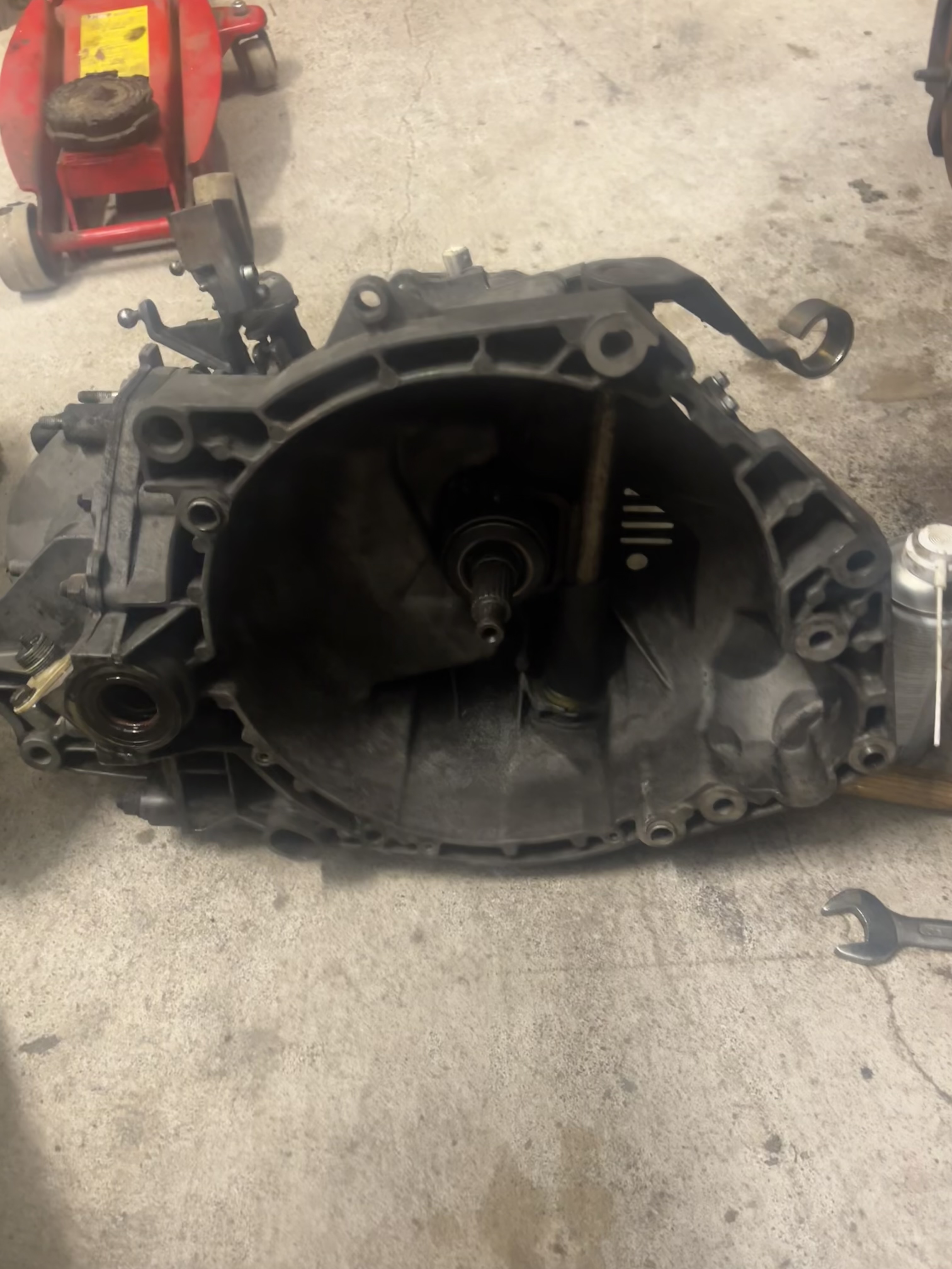

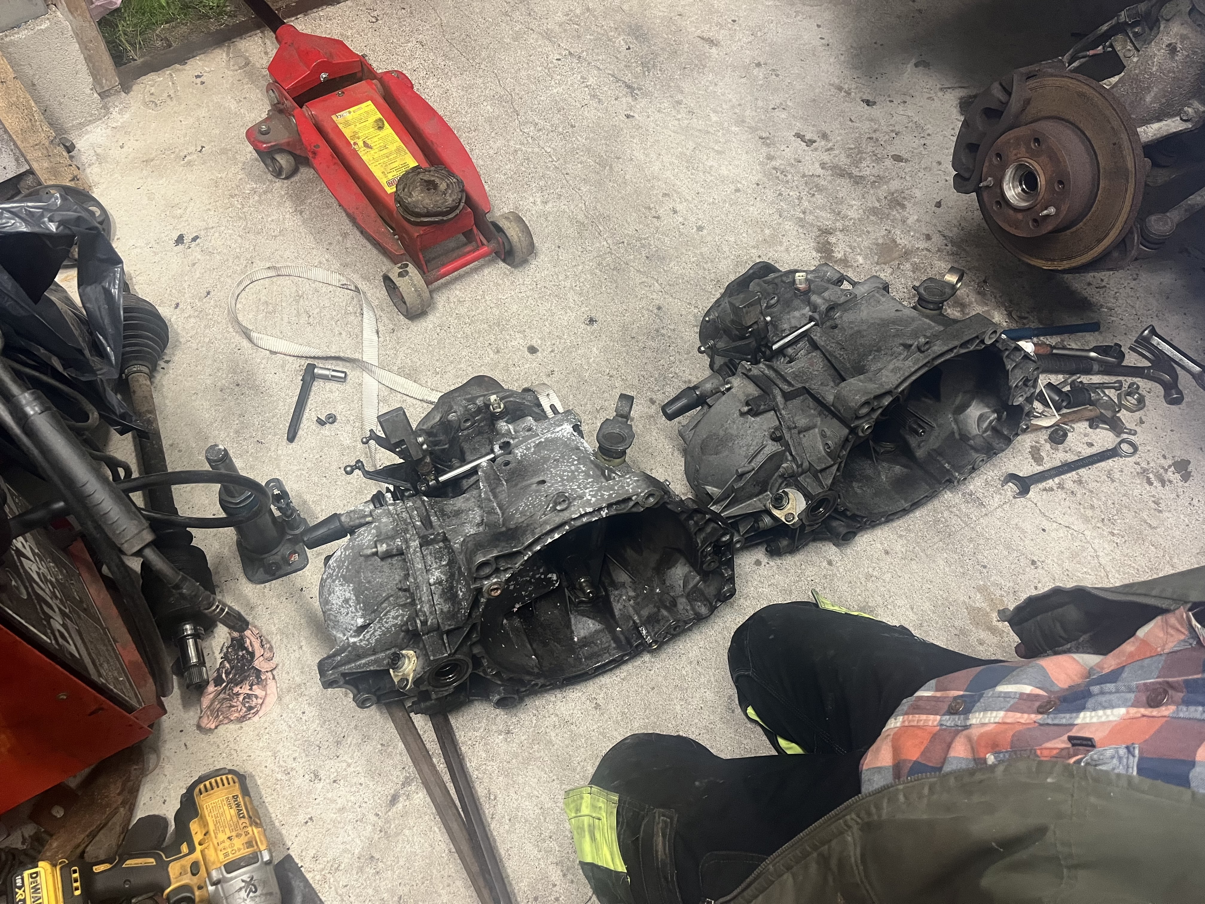

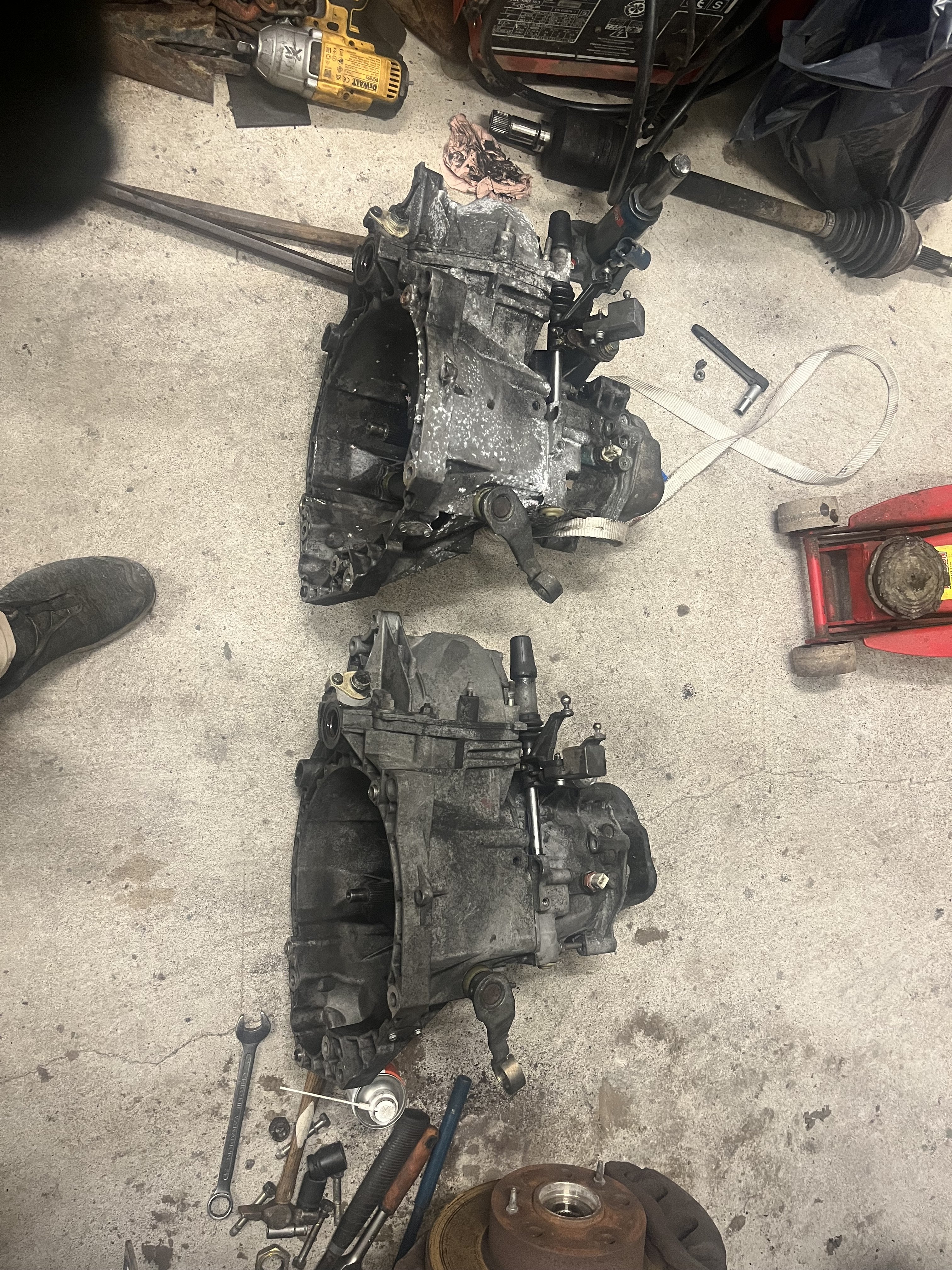

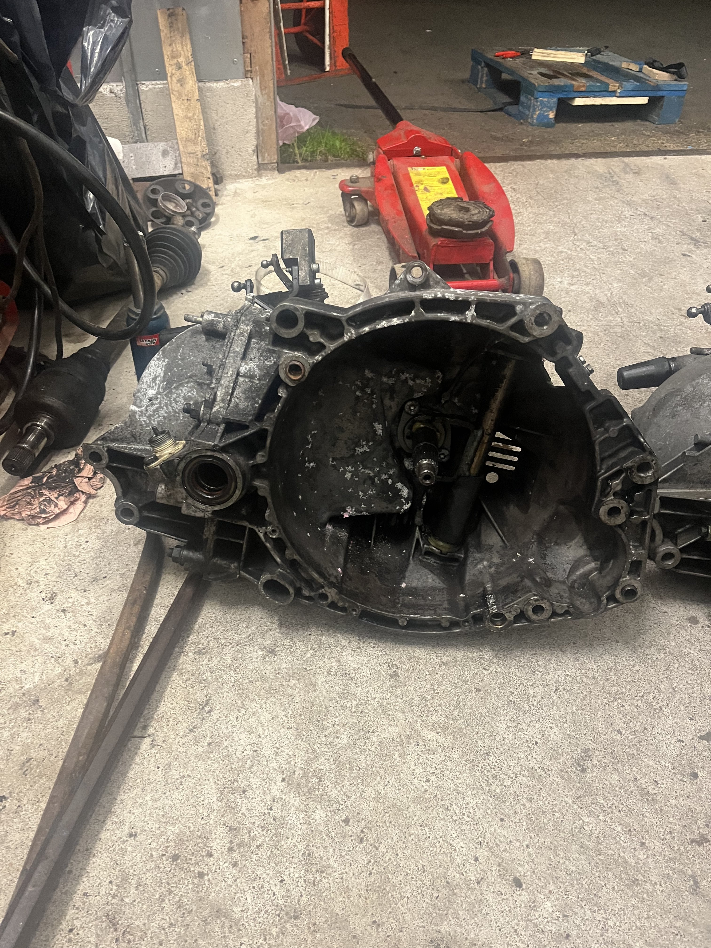

Status UPDATE.
Due to the cold weather I’ve waited to change the box.
With my luck, I was 100% sure that it would not fit or some other complications.
But it actually went smooth and works perfectly.
No more chrunching.
Success!

Good news that you were able to get a good suitable box for that age of vehicle.
Looking at the cam cover in one of your photos I see it is a genuine Fiat engine, some of that era had Peugeot based engines, another clue I believe was that they had a rubber "mushroom" plug that held the speedo cable into the speedo drive instead of the threaded screw on connection. From memory they were XUD engine Series.:)
