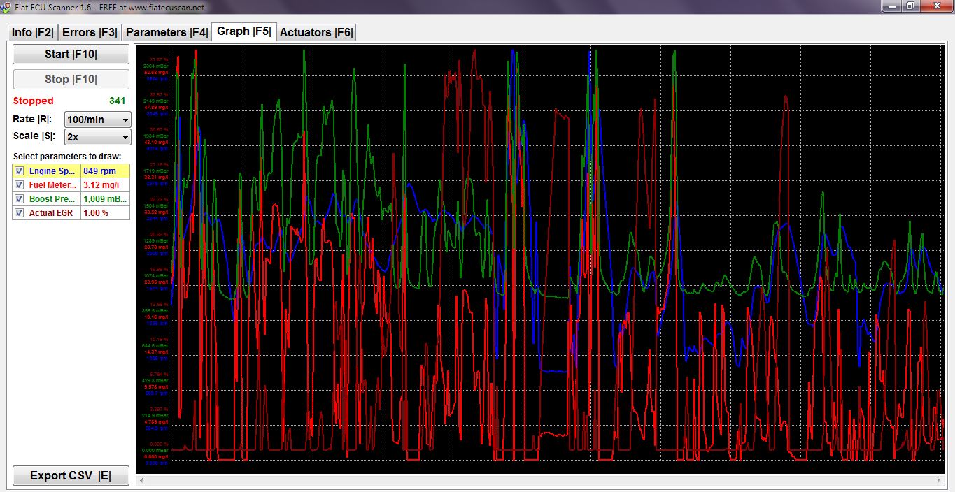

Edited to add a screen grab from the "yani" ecu scanner
