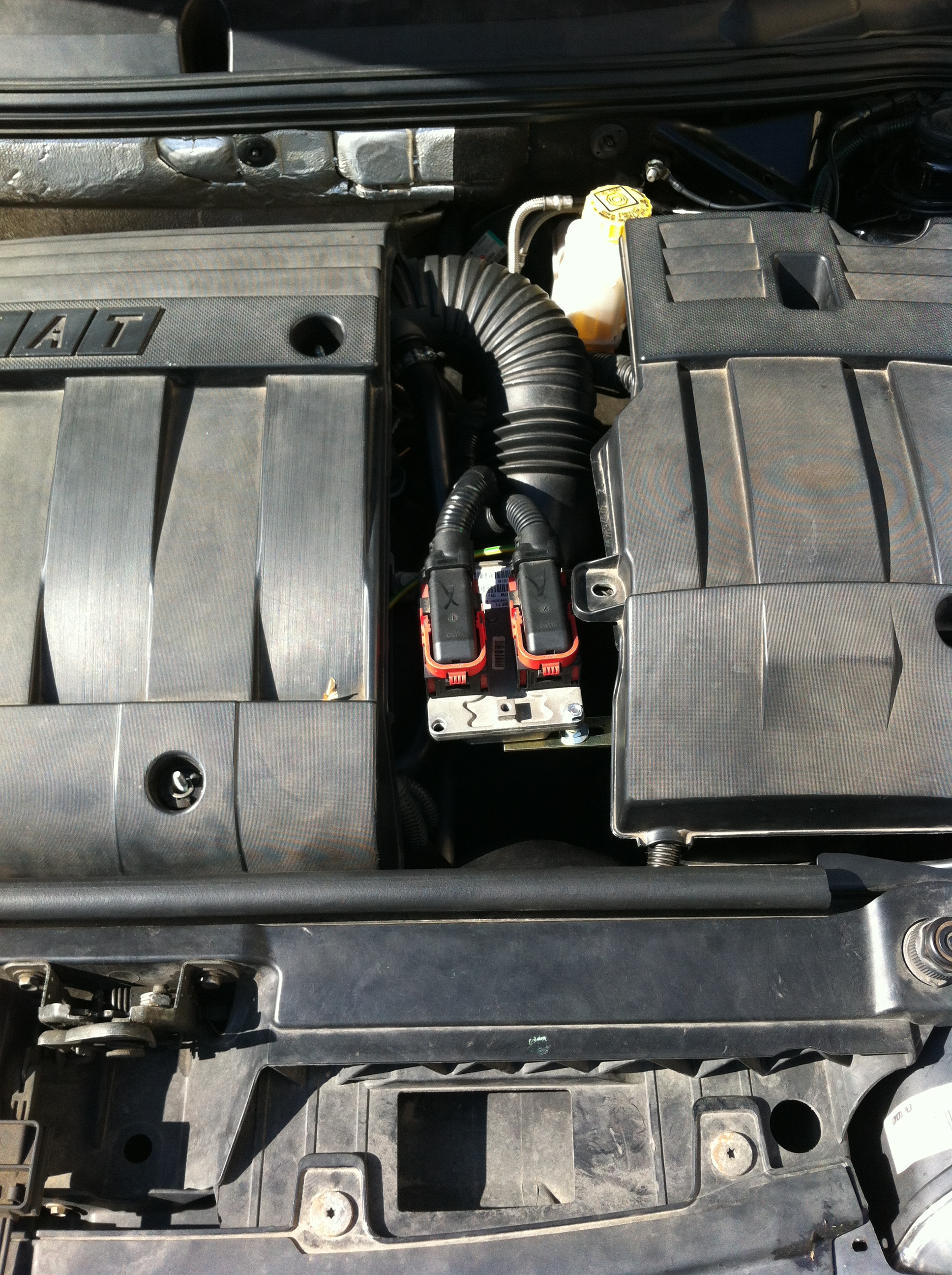

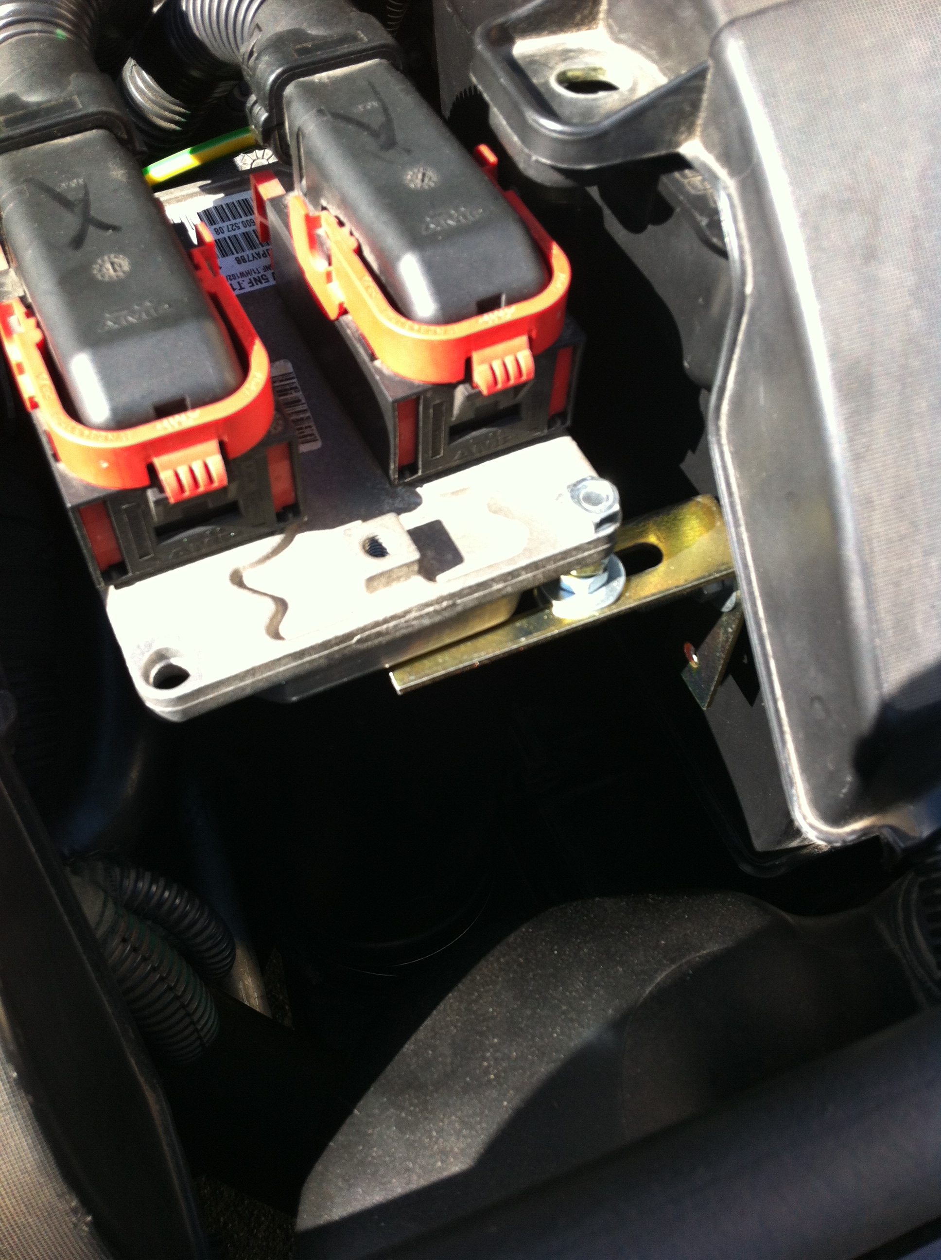

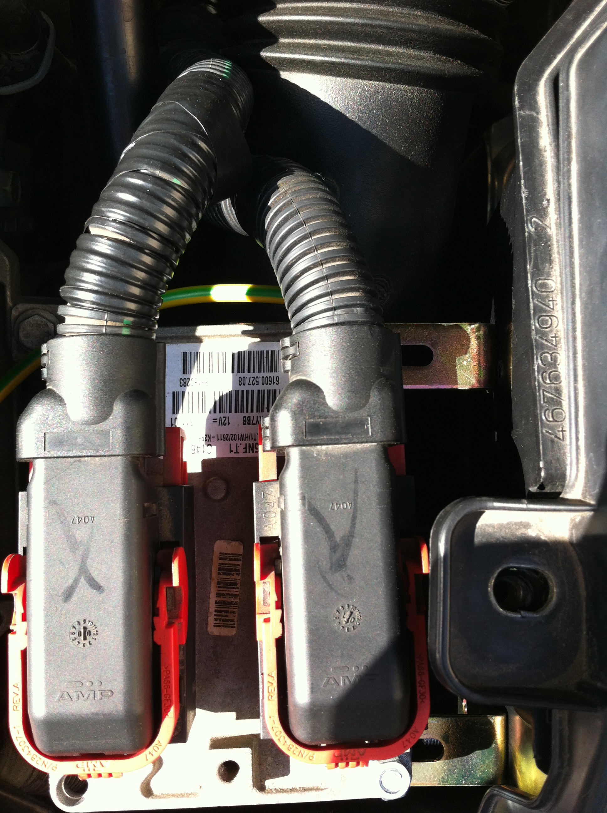

I have/had the same problem asr,esp los connection. It is a connetion problem(loose connection) in the ECU, when the motor is hot the ECU becomes hot and the car receives the asr, esp loose connection.I dont know if someone can 100% test the ECU in the same extreame conditions like on the motor(over 90°).
For me the solution was to change the position of the ECU to the battery case :) hope it helps you to.

adisor , i was wondering if you can post a picture of the relocation of the ECU so it gives me some sort of idea ?? I would deffo be interested in doing this as they dont come cheap
moschino 02 I'm glad you solved your problem with the ECU :)
Here are the pics that you requested, the last days I drove 300 km without a problem.I hope it remains this way :)

Excellant :thumb. Thanks man
Was is straightforward? DId you do it yourself or pay to do it?
