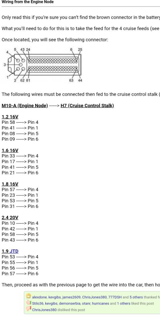

Hi, I am searching for the wiring diagram from the engine node to the cruise control stick on a 1.4 but can't seem to find it anywhere.
My 2005 Stilo does not have the cable by the stalks under the steering wheel and is also missing the brown connector by the battery. (I've searched everywhere).
The guide on the forum does well in explaining everything and contains wiring diagrams for all BUT the 1.4 engine. Any help please guys? Here's a link to the guide for reference.
https://www.fiatforum.com/stilo-guides/55049-cruise-control-installation-gars7.html
Thanks,

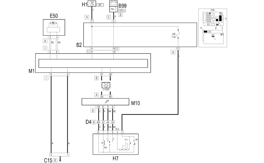

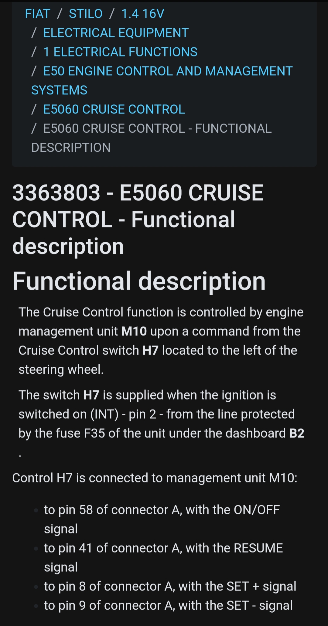

You can try this. I hope that is correct because it is for 1.4 16v

So the 1.2 and 1.4 have the same wiring diagram for connecting the Cruise control to the ECU. Can anyone confirm?
