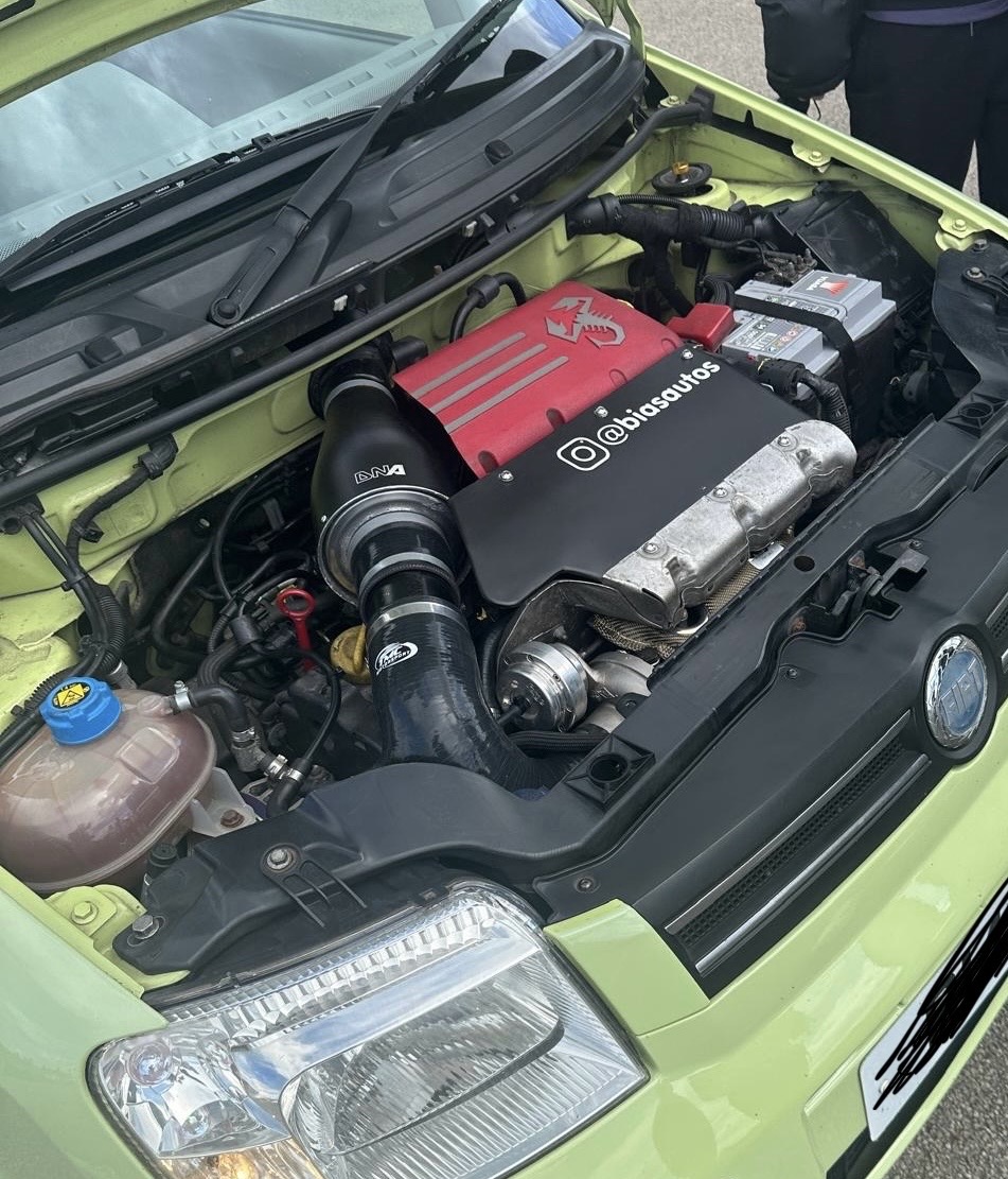

This was at an abarth track day earlier this year, might be able to search up the instagram name to get some info 👍🏻

That looks like a MK2/3 Panda, which I believe people have managed with. I’m looking for MK4 specific info, thanks though 👍🏻
