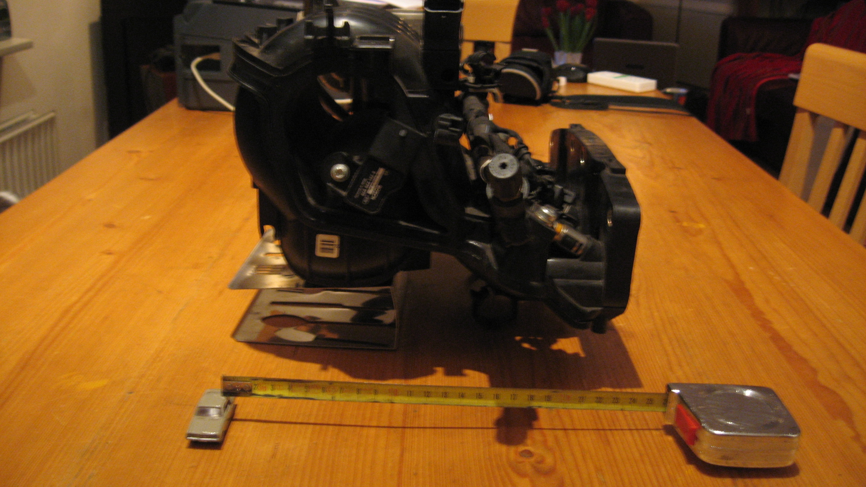

I am afraid that the original 1.4 manifold is too big for my cinq engine bay (especially in the direction of the firewall). The 1.4 manifold measures about 24cm ( I refuse to use inches!) from mounting surface to the back of the manifold. The P75 manifold measureas about 24cm too, from the mounting surface to the brake servo pipe. And here is the problem, I know that arc had placed his brake servo pipe to the side of the manifold because it interfered with the fire wall.
(see pictures)
(The 1.4 manifold is about as high as the P75 manifold plus tb.)
Maybe I would have to remove my strut brace. When it doesn’t fit I will just use the P75 manifold. I think the 1.4 manifold is better for low down torque though.

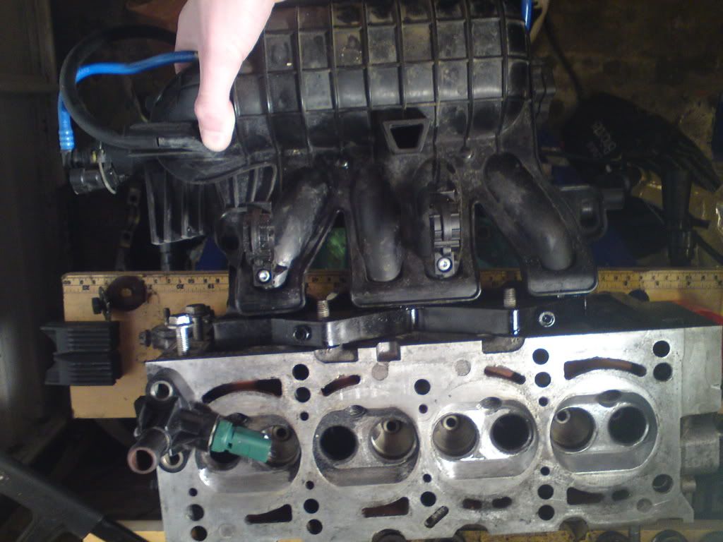

I have some pics of the port matching, they don't detail very well but they are spot on the money.
You can see where I have had to cut the mani for the water sender. Thats is on top of the head by the way.
