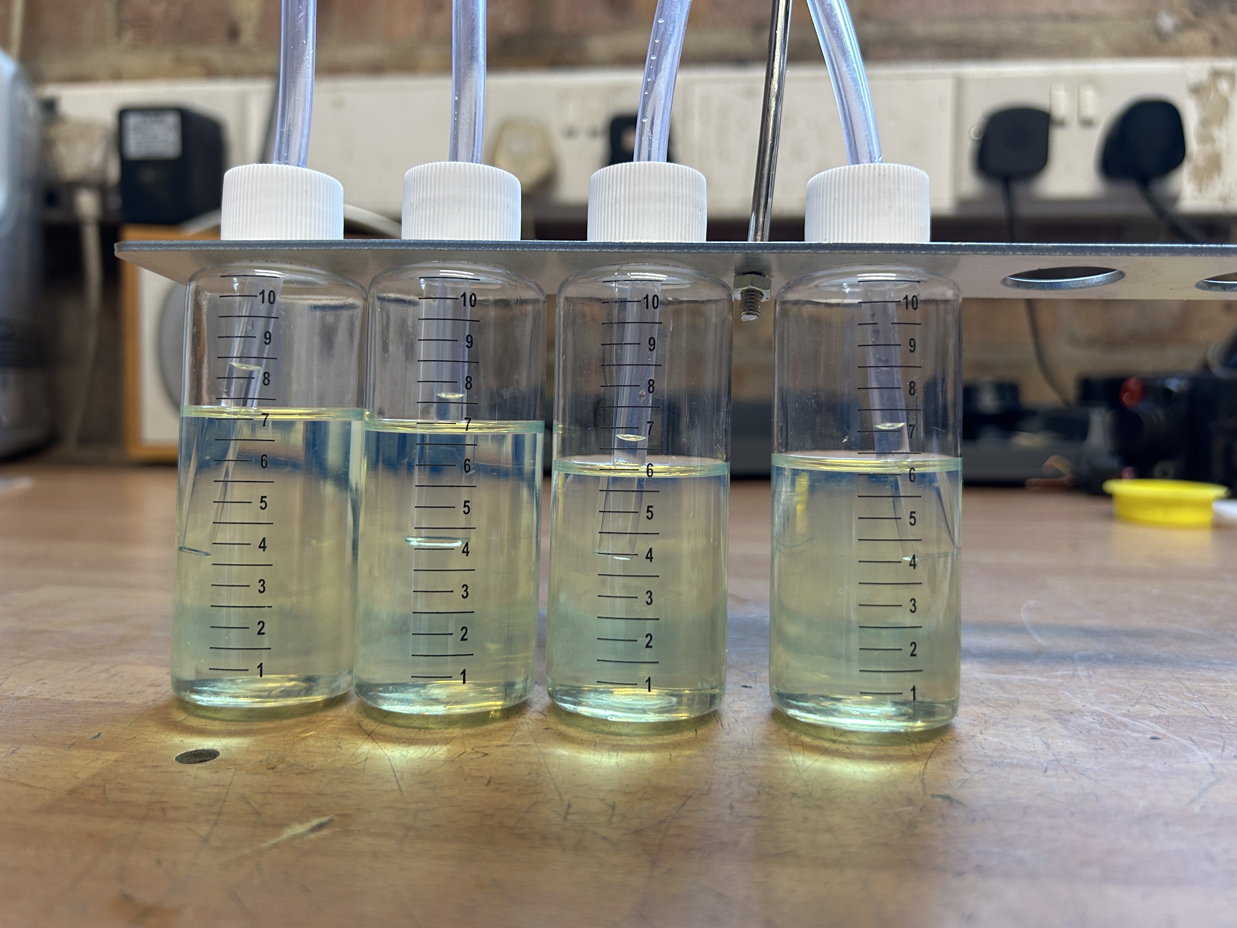

Does anyone know if this looks about right for my engine? This kit is the standard one available on ebay and is not calibrated in any standard units but I have accurate measuring beakers and the 7 mark works out at 35ml. I ran the engine for 3 1/2 minutes on tickover so this works out at 10ml per minute. Does this sound about right?
Cylinders 1-4 left to right.
According to some tests this appears slightly on the high side, but not excessively so.
Some suggest 30ml. So not conclusive either way.
Ideally I would look for one reading much higher than the rest.
Where as yours is fairly even , has it done a few miles?
Was there a particular fault you are trying to locate?
"Good injectors should not leak more than 25ml in this test. Looking at my results from left to right the first one is an original factory fitted injector in this car and shows a good 20ml result."

can't tell any difference from engine note. Carried out leak off test. Amounts look a little high but pretty
even across all injectors.

The compression kit I had bought proved to be of no use as it had no adapter for the Bosch injector, only fo screw in types. Considering how well the car had started in the past I decided that compression was probably not an issue so instead took the injectors into work for a cleaning session. Each one was dissasembled and put in individual containers and then into our ultrasonic tank for 20 minutes. I checked each injector nozzle under the microscope before cleaning and all had carbon build up and some spray holes blocked. After cleaning they were rinsed in acetone to stop flash rust. I checked the nozzle pattern and all were perfect so into some fresh diesel they went while I reassembled. Injector nozzles were re-torqued to 65nm.
Back in the garage I spent another couple of hours cleaning out the injector bores before refitting with new copper washers. I fully reassembled the car and started it up. Took a couple of tries but then started ok.
Unfortunately the smoke was back... So, decided to take @bugsymike advice and concentrate on the DPF. I let the engine warm for a bit and then started holding at 1500, 2000, and 3000rpm in the garage. Slowly the smoke began to thin out over a period of 8-10 minutes and the lumpy running dissapeared as well. I haven't moved the car for about 4-5 weeks so decided to risk backing it out and trying some more engine revving outside. The car behaved so I connected up MES to have a look. First thing I noticed was the injector corrections had gone from -1.5, -1.3, 1.4, 3.9 at idle to all -0.3 so the cleaning must have had an effect. I then looked at the DPF and clogging level was at 112%. The differential pressure was 70mbar at idle. I was pretty happy at this and resolved to take the car out for a short run the next day (today).
So, on to the test run, driving down our track to the road it was immediately obvious that the engine was running much smoother. Once on the road I decided to just barrel up and down a half mile each way just in case it played up. As I started to accelerate smartly through the gears the car began to throw out unbelievable volumes of smoke - couldn't see anything behind! I got to the first turnaround point and decided to just keep going and sure enough, giving it some beans it slowly started to clear. On the final two runs and trundling back up the track, not a bit of smoke anywhere.
Once back at base I plugged in MES which reported that a regen had just taken place and the clogging level was now 21% with the tickover differential pressure being 19mbar.
The car now pulls much harder with no hesitation anywhere in the rev range - lovely.
Thanks Mike, I don't think I would have got there without your pointers(y)
Very pleased with your success and surprised with that percentage of 112% clogging that it allowed a Regen:)
Many people report that they can't even " force a Regen " with much lower % so a good result.
It may be worth using DPF cleaner additive on every other tank of fuel, also giving it that good run say once a month to allow it to Regen when it needs.
The other thing I may have mentioned is the problem of town use for modern diesels and checking if engine temp quickly reaches 90 degrees, centre of gauge as cold engines aggravate the issue.
Re the extractor tool, I had that issue with the first one I had to do some years ago and having to remove the top nut on injector dislodged a tiny ceramic ball valve, I know to watch for that these days, but it did cause a lot of work at the time.
Would you be able to recommend a brand? I have never used an additive and it seems a bit of a minefield...
I am also going to keep a close eye on dpf clogging in future as well.
Wynns or STP DPF cleaner fuel additive seems OK. Basically stick with a brand you recognise.:)
That and the other advice on vehicle use.
I had 2 injectors stuck solid. The copper seal had been leaking, caused a carbon build up that jammed one solid and its partner pretty badly. I used a puller type extraction tool that screws to the injector top. And I’m glad I did because it needed serous force to get it out.
I stripped and cleaned all injectors and reassembled. The rebuilt engine ran fine afterwards. It did develop problems due to my rushing the valve lapping but that wasn’t an injector issue.
