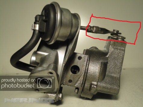

however, eml light is still on, but this time its saying its the boost pressure sensor. now from what ive read it the wastegate getting stuck, so i tried freeing it. however mine wont budge. not even slightly. ive tried going from underneath, but the car is deceptivly low so thats a no go. any other tips for me to try?

so what does this mean? i thought i had been pushing on the wasetgate to try and get it to open? ill attach the bit i've been trying to get to move.
i've attached the image i've been using to help. i have been trying to free what is highlighted in the red box

Hi Limpyjet (or whoever is hidden here),
the picture is from 75hp 1.3 MJT and is actually a wastegate turbo. The one that is used with the 90hp engine has variable vanes and even if it looks similar it's totally different inside and the way it's managed by the ECU.
It has the same kind of rod connecting the actuator to the moving plate inside the turbo which can also get seized. If this happens OR if you miss the vacuum (pump, pipe, accumulator, E-valve, actuator), the boost will be too high for a moment and the ECU will switch to limp mode, and stay there if the fault is not fixed.

okay, i should still attempt to free the actuator? or is there something else i should try?

Check for miss of vacuum first, go the easy way:
- from the actuator there is one small pipe going to the electrovalve
- from the electrovalve there is another one that goes at the back of engine
- at the back of engine there is the accumulator
- the accumulator is connected to the vacuum pump on the battery side of engine
Check for any of those pipes broken or badly leaking and repair if found bad.
If all is fine, by-pass the electrovalve so the vacuum will always apply to the actuator (verify this point); now the rod must be completely pulled, if not, the actuator membrane is "kaputt", if the vacuum doesn't pull the rod, the vanes rotating disk is seized in the turbo: needs removal of entire turbo, opening and cleaning ...

Bernie, I am in absolute agreement with your advice and an actuator problem will give the result reported (overboost).
However in Limpyjet's second post (picture of turbo) he/she? seems to be saying that they've been trying to move the linkage manually (by hand)? If the vanes are not seized then the linkage should move relatively easily in this way (done it many times myself) which is why I decided to go for the seized vanes scenario. The only thing I'm a little unsure about is if it's an electric/electronically activated wastegate then can you still move them by hand or would you have to pop the linkage off so you won't disturb the actuator motor - I've only ever "fiddled" with diaphragm types.
