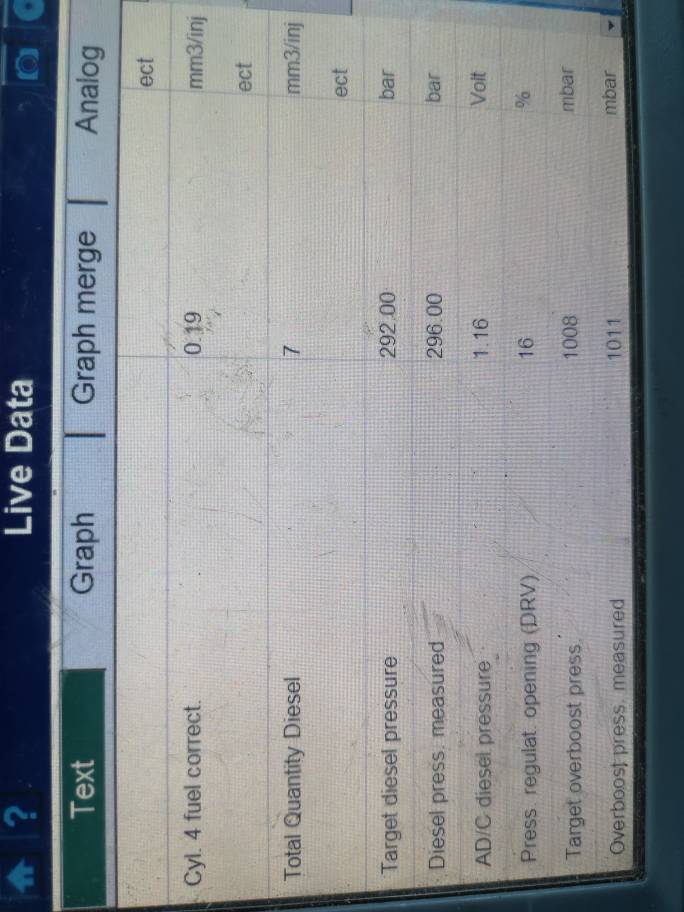

I'm having an issue with it taking a long time to start especially if it's been sat for more than 10-15 mins. If I stop and start again right away, it starts relatively ok. Not great but acceptable.
I've added a few screenshots as I think it is fuel related. This van sat for a bit as it had immobilizer issues.
Once running, it drives fine unless I really push it. If I do, it sometimes throws the engine light on and gives me these codes.
DTCs are P0089 and P0003 with a random U0422.
I'm going to recheck fuel filter, air filter and EGR and give the MAF a clean but was wondering if anyone has experience with this?
Are the injector readings within range in your opinion?
Im concerned it may be fuel pump related though I have no real basis for that. I can hear the pump prime when turned on, I've tried letting it prime a few times before cranking but it's hard to say if it helps.
Many thanks
