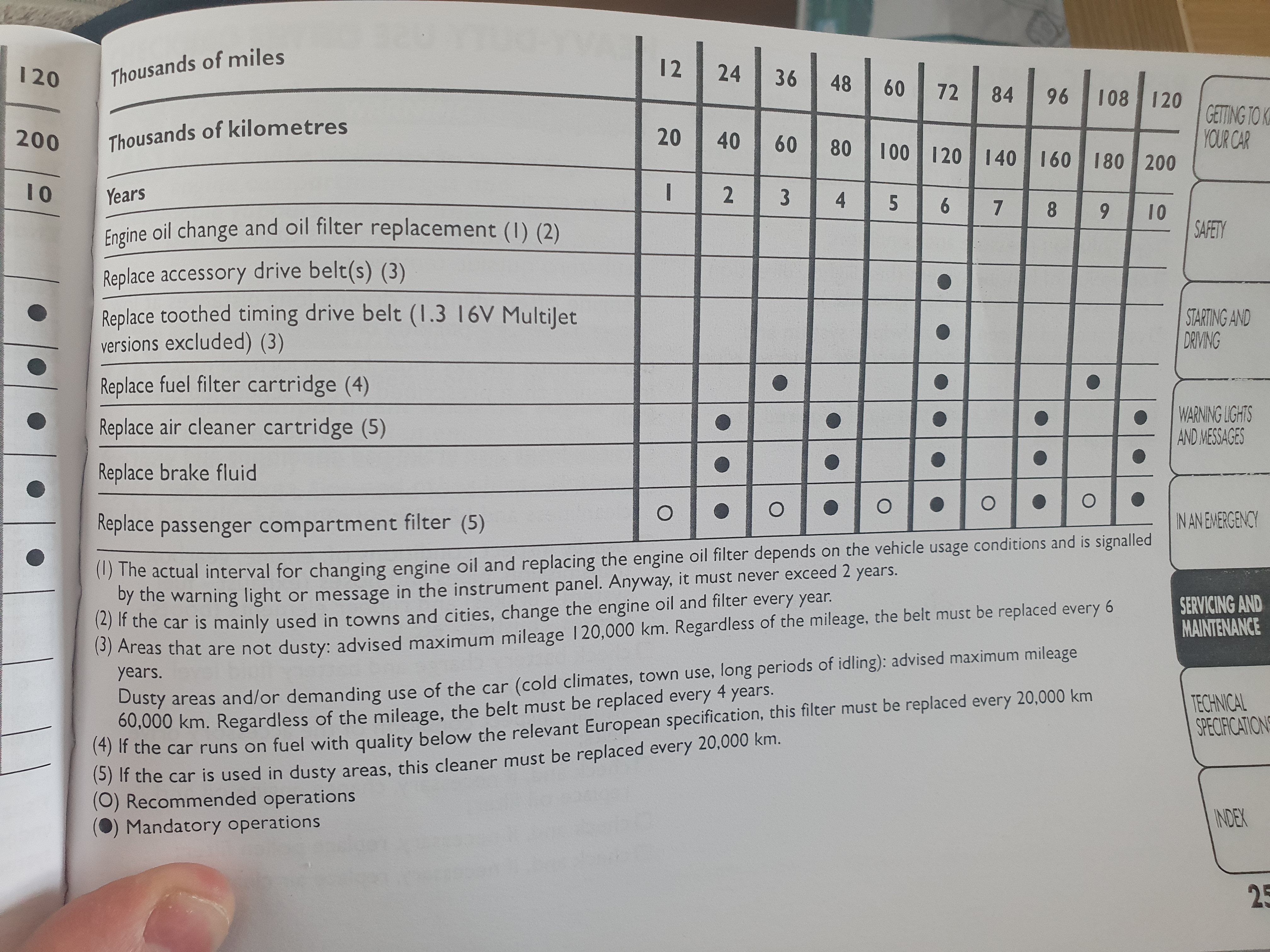

I have just purchased a 2015 500l 1.3 diesel. I'm just wondering about the timing chain/belt. I was told by the garage that its a chain that needs changing around the 130000 mile mark but the manual says its a belt that needs changing every 120000 klm or every 6 years. This is line 3 on the attached picture from the manual.

Read the manual again
Toothed timing belt excluding 1.3 multijet
The garage is right it's a timing chain
And 130k is a reasonable millage to have it changed it as these engines have a habit of snapping them if not looked after
Your totally right, I read it as 1.3 version engines look at item 3. My mistake thanks for clearing it up for me!
