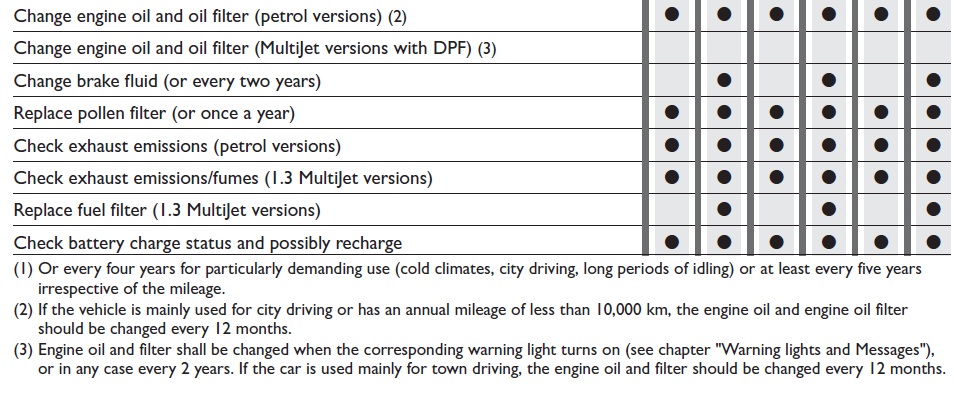

Checking the latest Fiat 500 manual (Click here) it states that if you are doing a lot of city driving the oil should be changed every 12 months - see Note 2 (Note 1 refers to Timing belt & 3 refers to the MJ).
Would you consider going for an early service to include all that is required at 30K km (18K miles) ?
