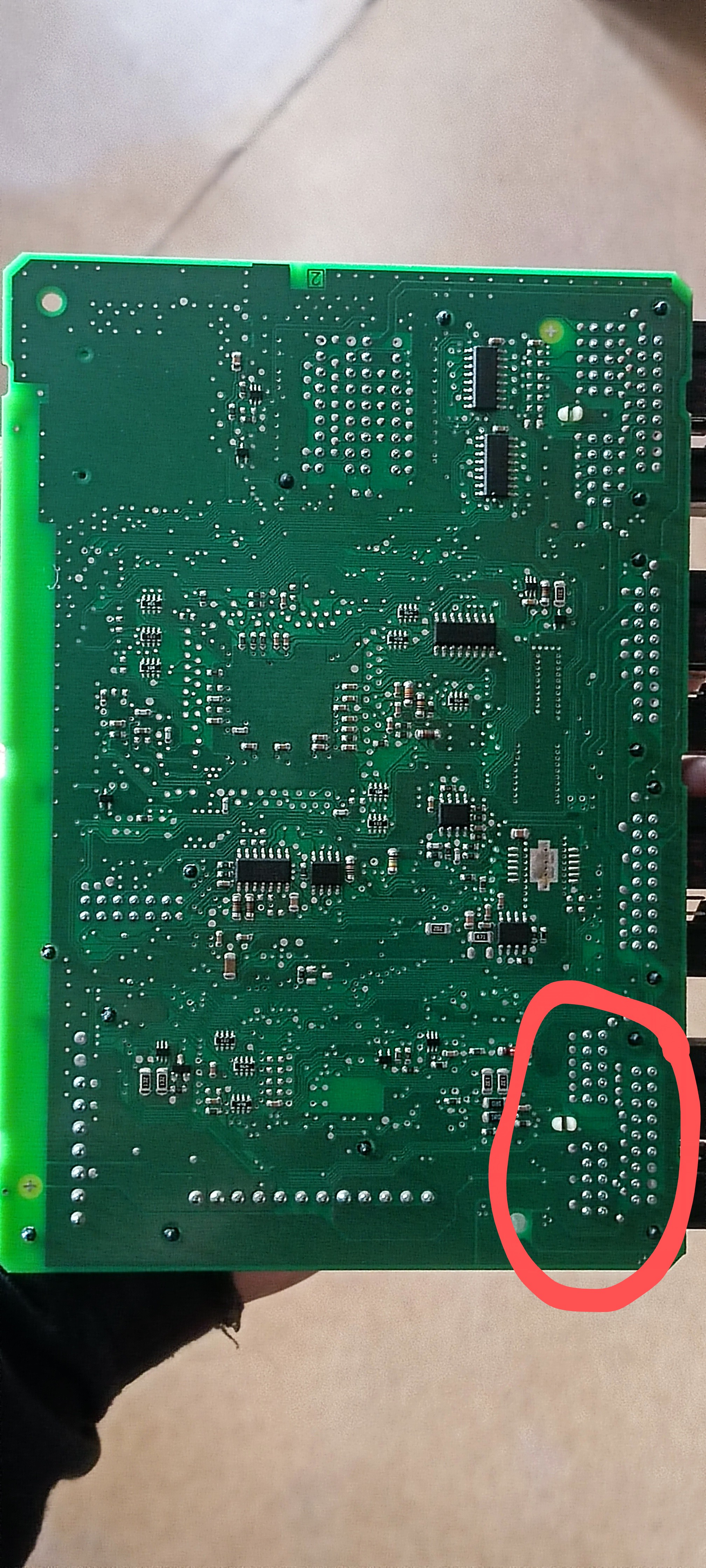

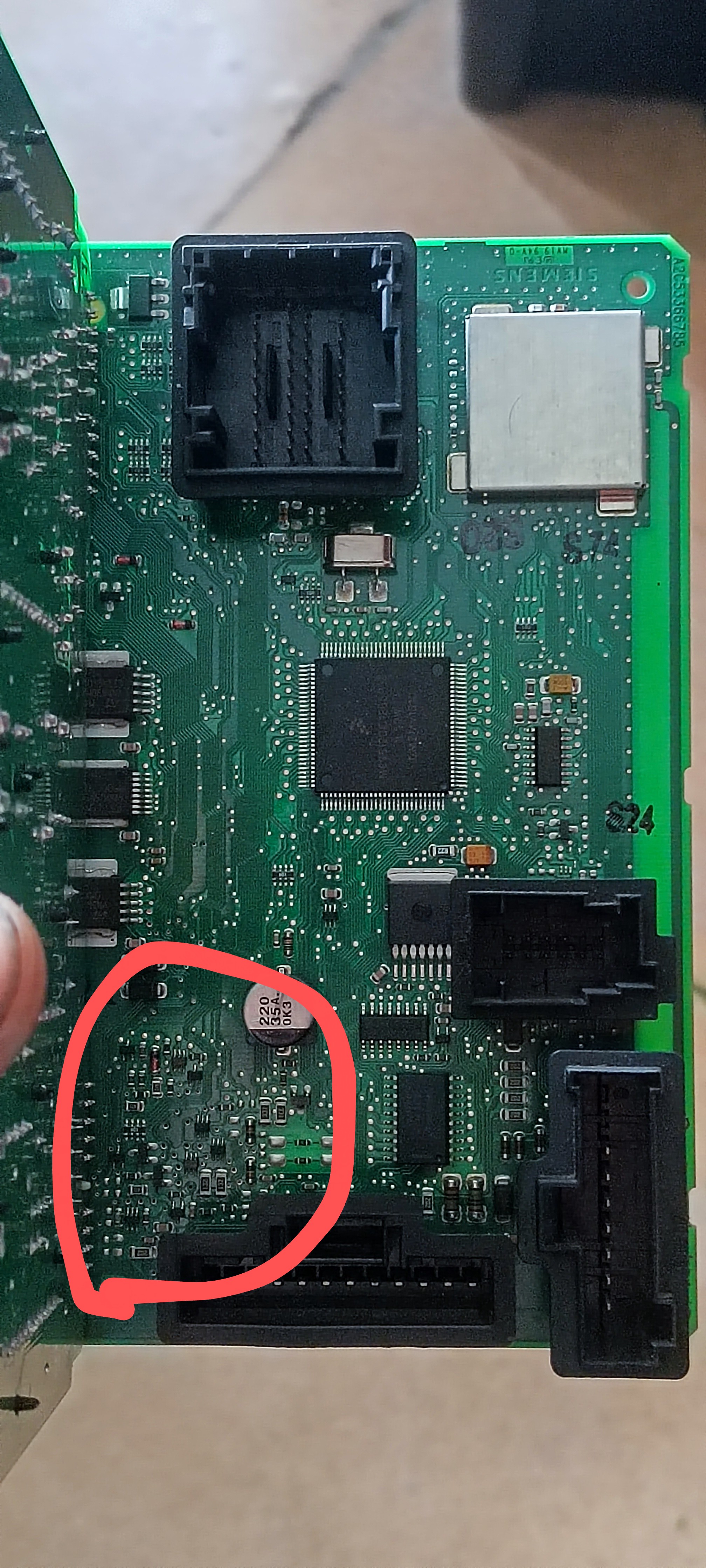

But if the BCM is fine we're going back to the car?
Be worth post a close up of the areas I circled in photos above, while it's apart
This is what I am looking at

We can only work with the information given
Half half hour they're good if not I'll send a picture of where you asked me to focus on

Probably a shadow looks perfectly clean
