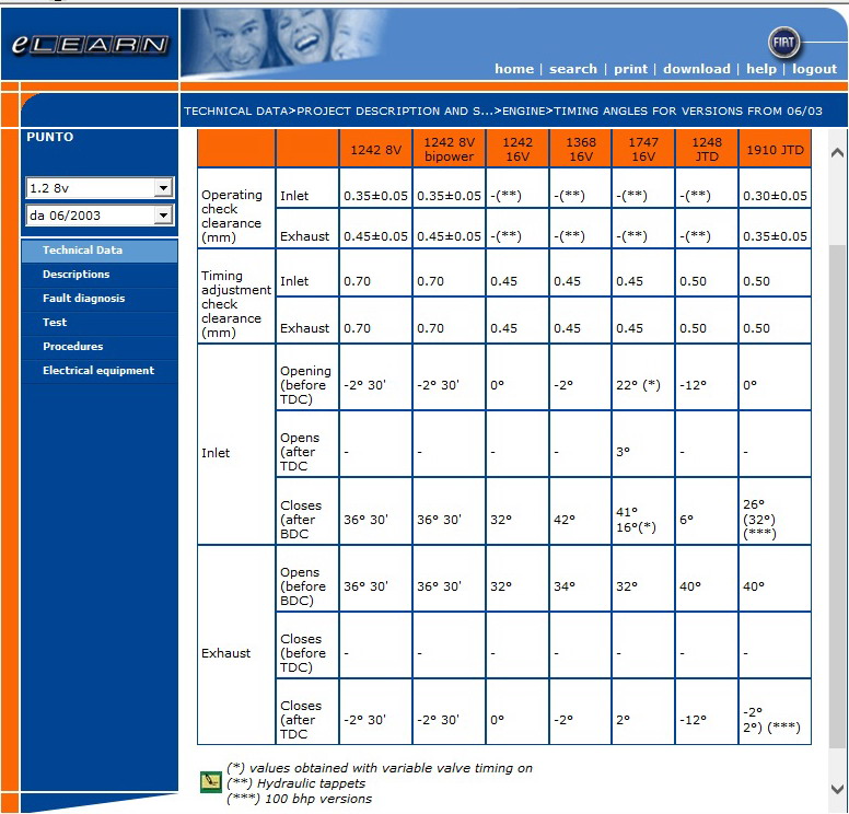

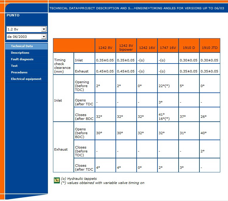

Mike1alike Established member Joined Aug 3, 2017 Messages 809 Points 241 Location Timisoara Jan 28, 2025 #8 The correct clearances are: Inlet: 0.35 +/- 0.05 mm Exhaust: 0.45 +/- 0.05 mm Attachments Fiat Punto 1.2 8V Tehnical Data - From 06-2003.jpg 144.7 KB · Views: 17 Fiat Punto 1.2 8V Tehnical Data - Up To 06-2003.jpg 110.4 KB · Views: 20
