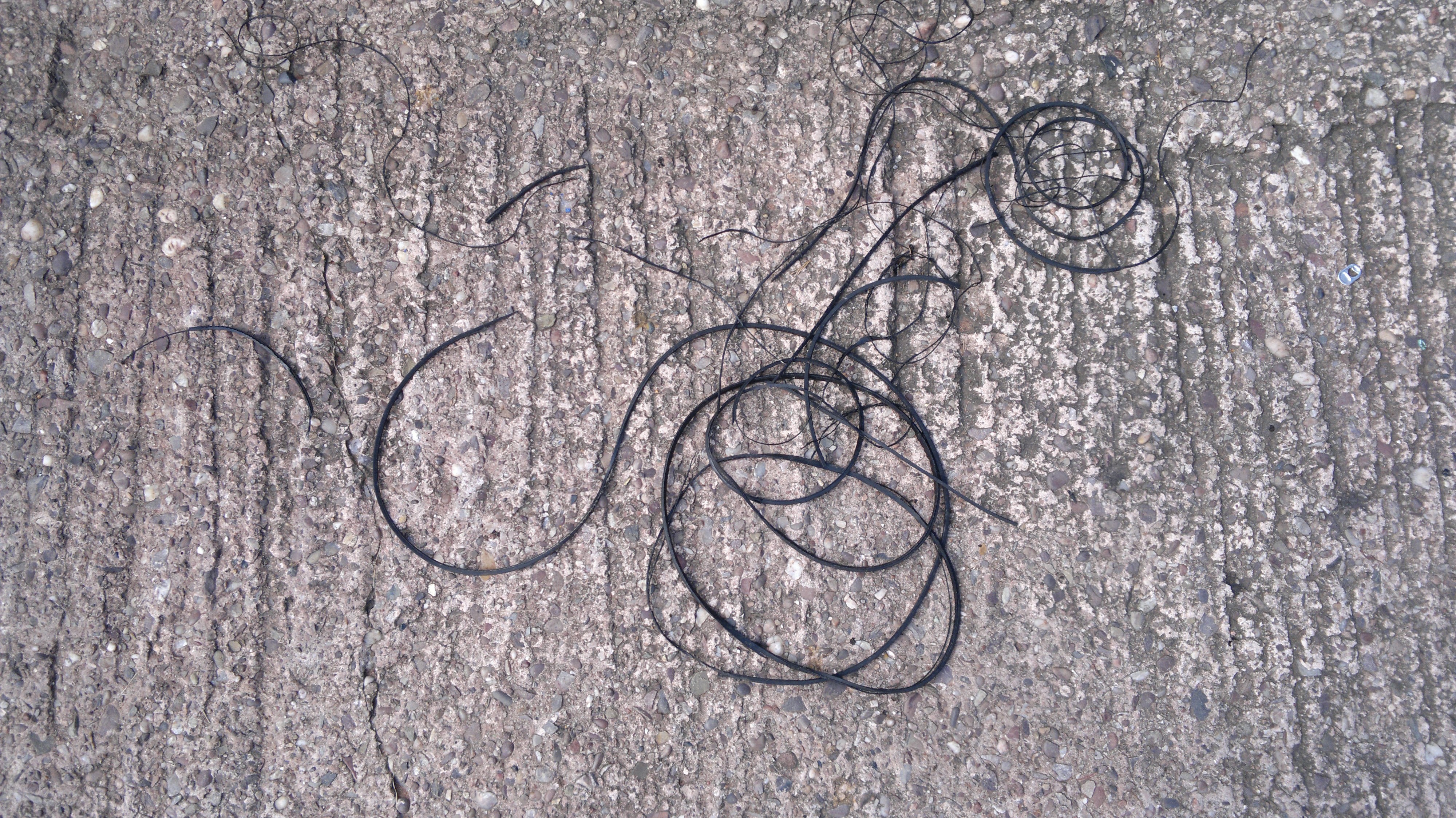

My daughter is on her way to my house to pick up my grandsons.
She calls and tells me there's a loud squeaking/squealing noise coming from under the bonnet and something smells like burning rubber.
She had already pulled over and the smell had gone so I told her to start the car and come straight to my house as she was only half a mile away.
Just as she was turning right onto my drive the dash lit up like a christmas tree and she couldn't turn the steering wheel.
She turned the ignition off, switched on the hazards and bailed out of the car. Ran straight in through my front door and announced her new car was dead! :eek:
Appologising to the que of traffic I took a quick look under the bonnet to confirm it was the Auxiliary Belt then started the car and drove it onto my drive.
A quick trip to Fiat to purchase a new belt and 20 minutes to get the car on the ramps and change the belt and the panic was over.
However, check out the condition of the old belt in the pic below. :eek:
Very lucky. I had a similar happening on a Renault Laguna; replaced the aux. belt and drove down the road only to have a wayward strand of belt, such as on your drive, wrap itself around the crank sprocket and cause the cambelt to jump teeth - only bent three valves!
Moral. Check thoroughly that there are no wayward strands.
