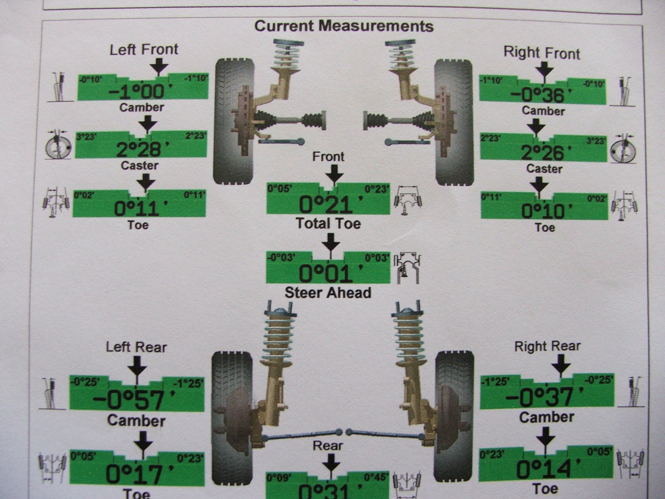

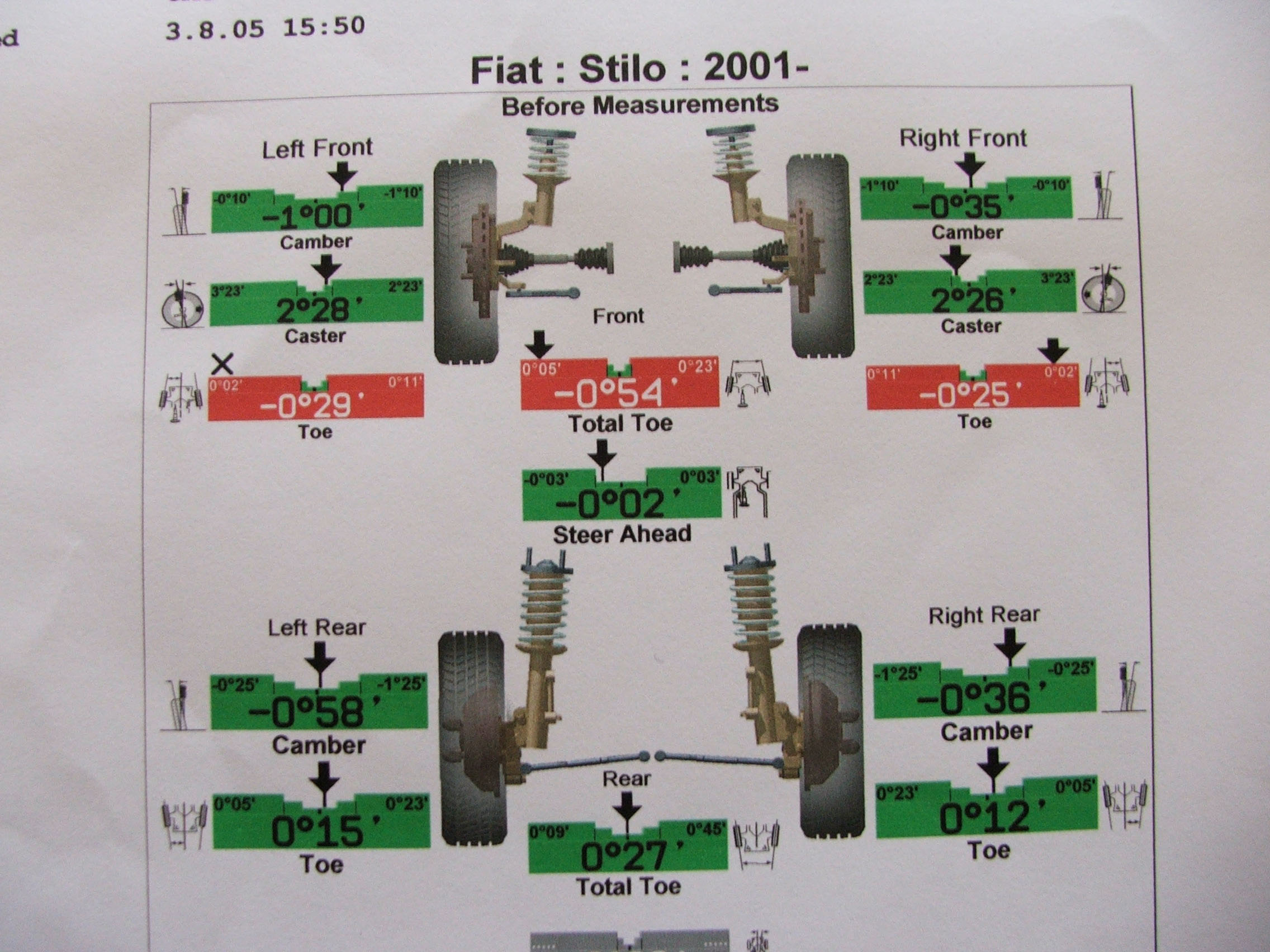

Here's the before and after wheel alignment readout I was given...
The link below with the red Toe alignment is the one before it was done so there was quite a difference considering it had just been tracked at Fiat before this, it shows it needs doing properly.
I left both pictures as large as possible so it was easier to read the numbers.
Before it was computer aligned
After it was computer aligned
