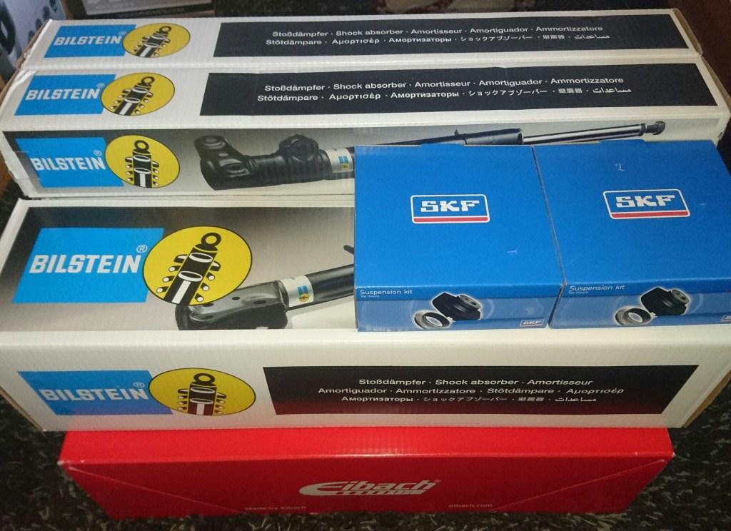

I managed to get back onto this over the Christmas break and ended up stripping back all of the front wheel arch fittings including springs and dampers as there was some surface rust starting to bubble through under there. Looks like Fiat primered the bare metal then covered with a thin layer of seam sealer before a dark top coat so not as easy as first thought and quite a time consuming task even with a wire brush drill bit. Plan to clean, POR15 prep, POR15 piant and you've guessed it... POR15 chassis paint. Should give some decent protection for years to come.
When removing the front spring and damper units I noticed the RHF suspension coil spring was broken (now in two bits rather than one), a great excuse to order a full set of the Bilstein B4 Gas shocks with Eibach Pro lowering springs (-30mm from standard). Correct me if I'm wrong but I understand the Sportings to be -20mm from standard models making this overall a -10mm drop on a sporting if that makes sense... hardly any change from the standard sporting set up so should be good for everyday use and not too low for the bloody speed bumps around Warwickshire!

yes if the springs are sold as s/sx ones then they will lower a sporting 20mm less that advertised. Its a personal thing ride height but tbh i have found i never caught anything with -40/40 sporting springs, was only when i went to 60/60 i had issues but even then it wasn't that bad really, hard and uncomfortable yes but rarely caught anything really but i was careful not to at the same time if that makes sense.
I agree Blu, I always thought lowering and stiffer springs was the way to go until I put my Mk3 MR2 on coilovers with vastly reduced ride height. Great for smooth tarmac, not so good for the patchwork quilt road surfaces around here at the moment.
Springs, dampers and strut top mounts have all arrived :D Just need to get some dust boots for the front dampers, should be good for few years then on the suspension side of things.
