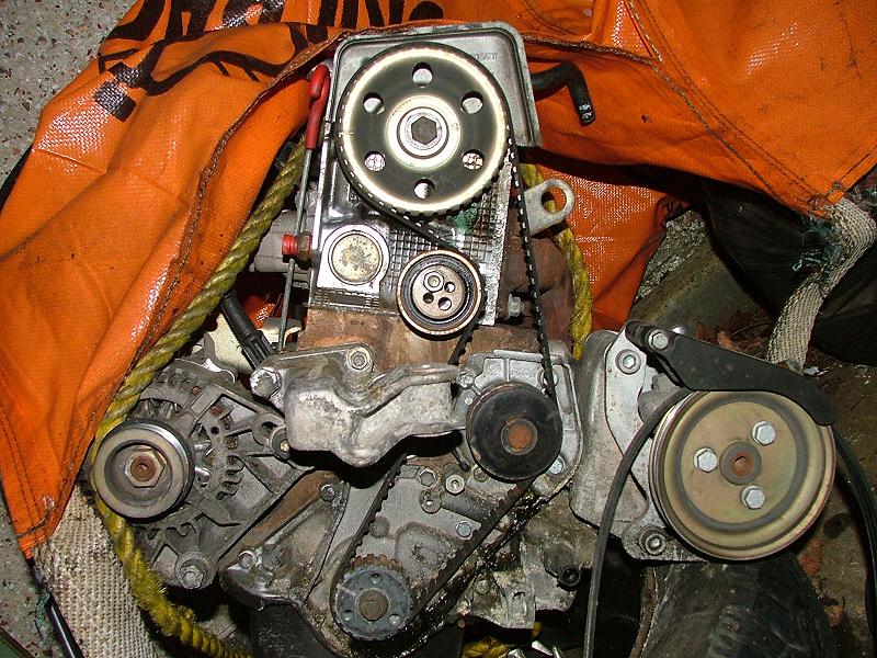

here you go hope they help, the tdc sensor is removed from this engine but there is a photo of it and of where it goes. also a photo that shows belt fitted.

Cheers Dave,
These were a great help today.
But although engine seems to tick over better the main problem still exsists

Dave,
Can you confirm that the crank pulley TDC timing mark is on the apex of the corner of that strengthening web. When i looked at the picture in the Haynes book (of lies) I thought it was halfway up the straight web, but looking at your picture and then looking back at the Haynes manual it would seem to be right on the corner , just as the web changes direction/angle.

Interesting. I have the same engine in my Doblo and I also could not figure out where the crankshaft timing mark was. I also wondered if it was the corner of the strengthening web. I actually set TDC using a clock gauge when the head was off and the pulley mark didn't quite line up with anything so I'm still not sure. Does anyone know the correct precedure for tightening the cylinder head bolts on the 1.2 litre 8 valve engine?

hi, thank you for this information, it was perfect and so easy to follow

i was just wondering whether the diagrams are accurate for a 1998 fiat seicento sporting, 1108cc 8v.
The timing mark on the crank pulley lines up nicely with the apex of the casing (using your pictures) and the 2 out most pistons are at TDC, which leads me to believe that your timing pictures work for my car. But i am struggling to find the mark for the cam pulley, if it is where the pictures show then my timing is out by about 20 teeth! this confused me as the crank timing marks appear right.... and on top of that the car runs (very rough) it will tick over and rev to about 3k rpm, is that possible with such bad timing :S.

no one mentions that the pulley that drives the alternator onlys goes on one way theres a tiny dimple and a hole to line up the engine wont run if this is wrong took me an hour to work this out

:confused: the big photo in the post above this with the pin circled in red :rolleyes:
