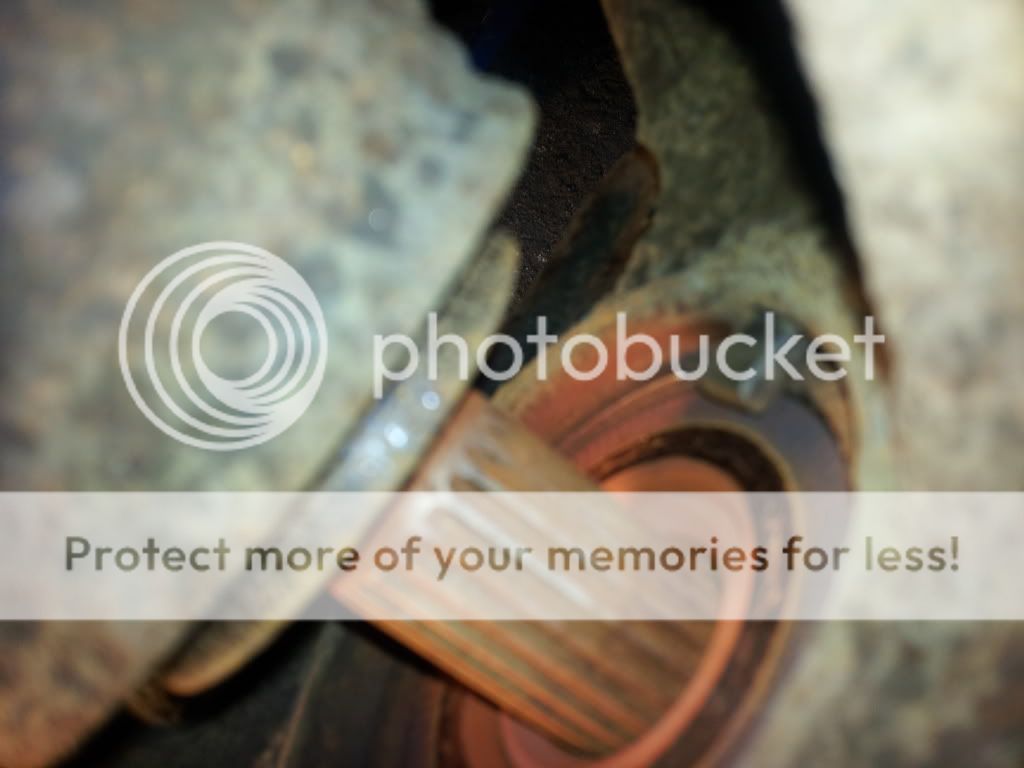

1. The ABS will kick in at low speed (under 20mph) at the small of touches on the pedal, not every time the pedal is pressed though. At first I thought it would be the rear bearings/hubs as I discovered the handbrake lever had been rubbing on the hub. After replacing them both the problem still persists, so I decided to move onto the front.
I expected (well hoped) to find a broken ABS ring on the outer CV joint but after initial investigations I am proved wrong - see photos - as it doesn't have an ABS ring. I assume this is correct as its a magnetic sensor?

I've been doing some more digging, surely I should be working, and think that I've came to the conclusion that the sensor on the front picks up the signal from the back of the wheel bearing. This may or may not be at fault, not sure how I establish which side is at fault though.
you might have a restricted brake hose causing brake inbalance especially at this age
the abs pickup does indeed collect its signal from the back of the hub bearing ,maybe its dirty /well corroded/ or a combination of both these things

there isnt an abs ring type pickup on the punto
driveshaft
therefore if he thinks theres an error its the pickup connector which i have successfully removed by duck oiling having a cuppa then returning to and with proper fitting mole grips very slowly wiggled side to side to clear the rust build up in the hub hole before withdrawing to replace with another free s/h one from the scrappies
