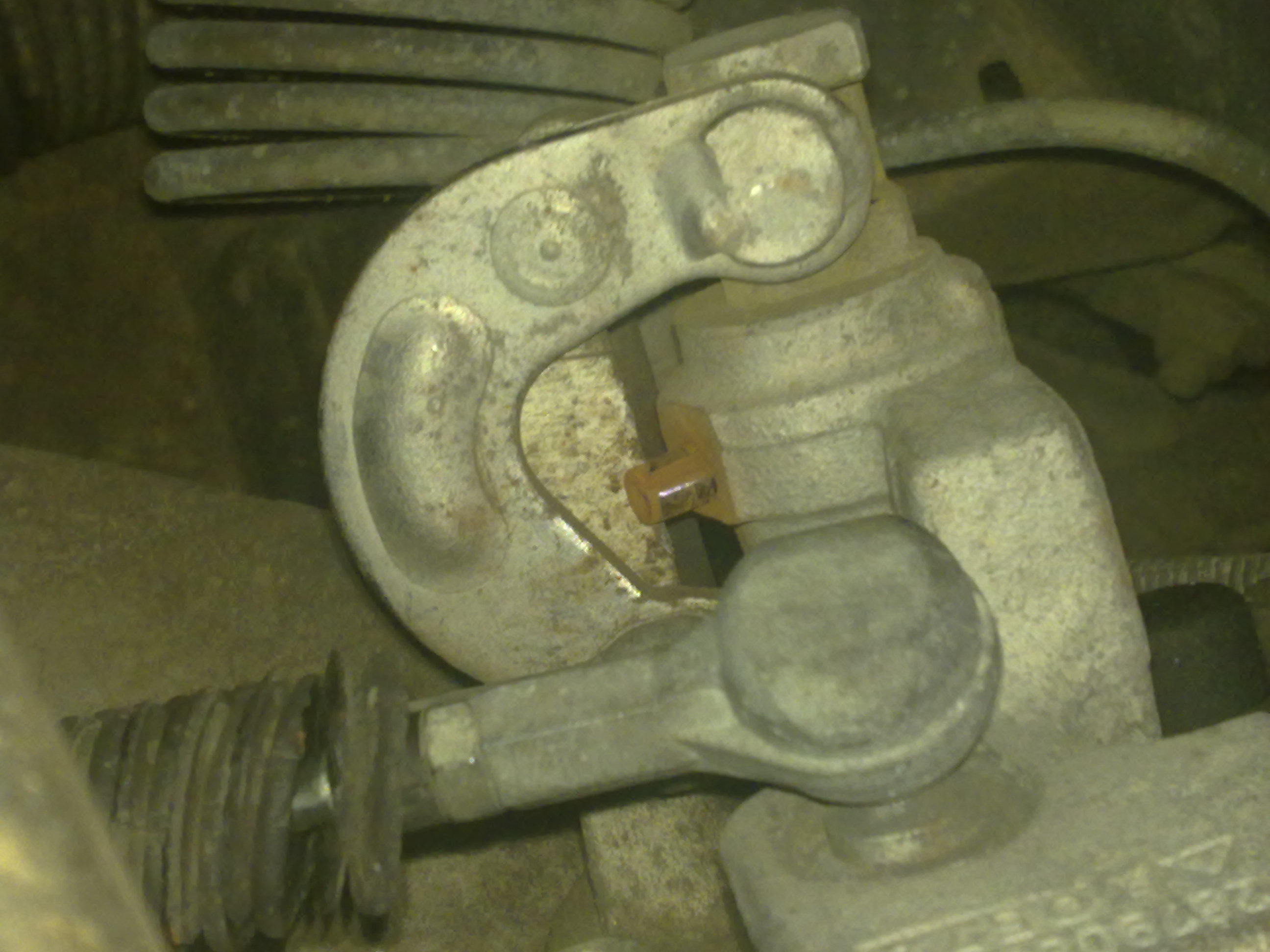

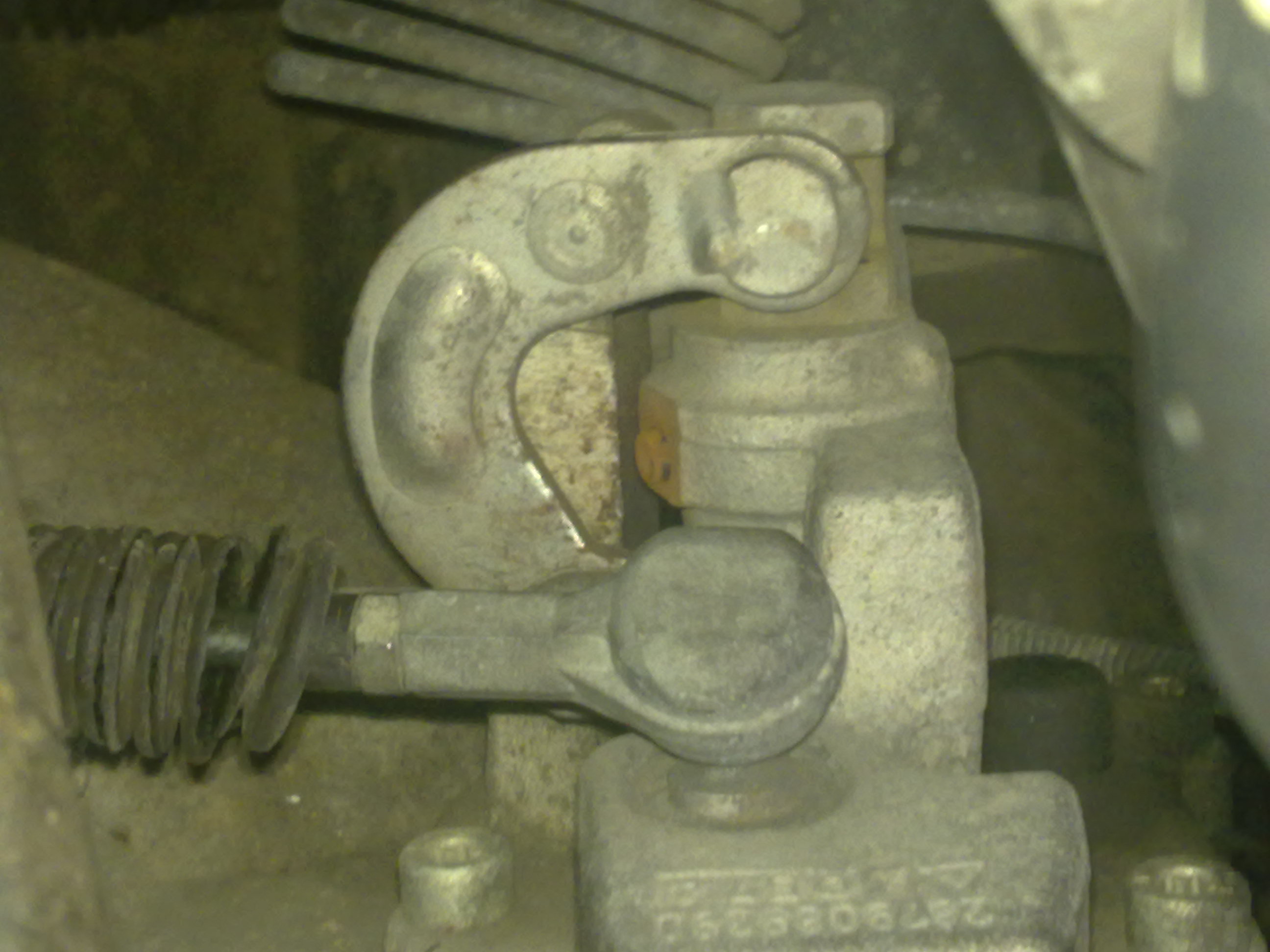

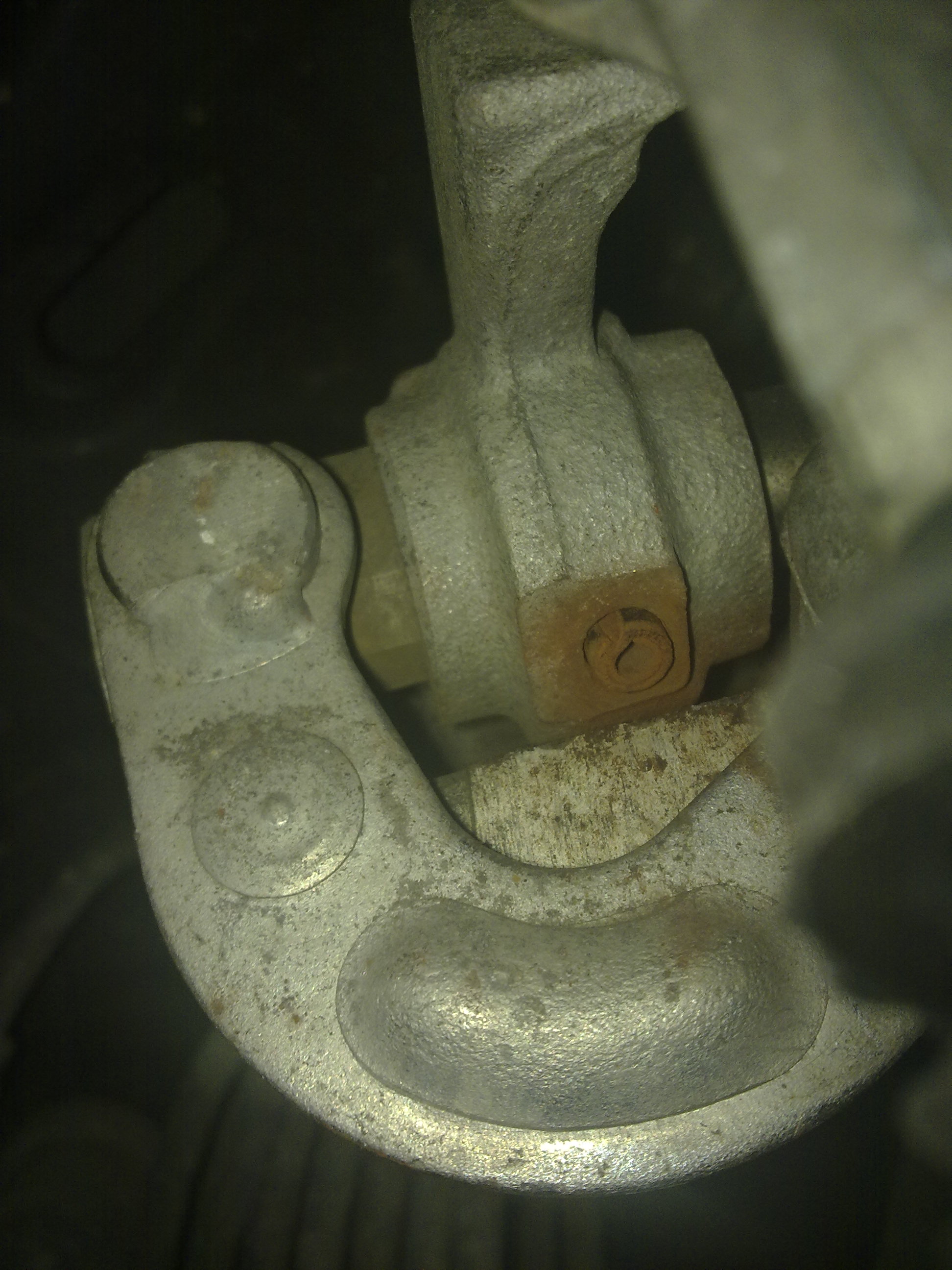

Right.. this is my problem..
That little thing there is coming out and getting in the way of the mechanism.

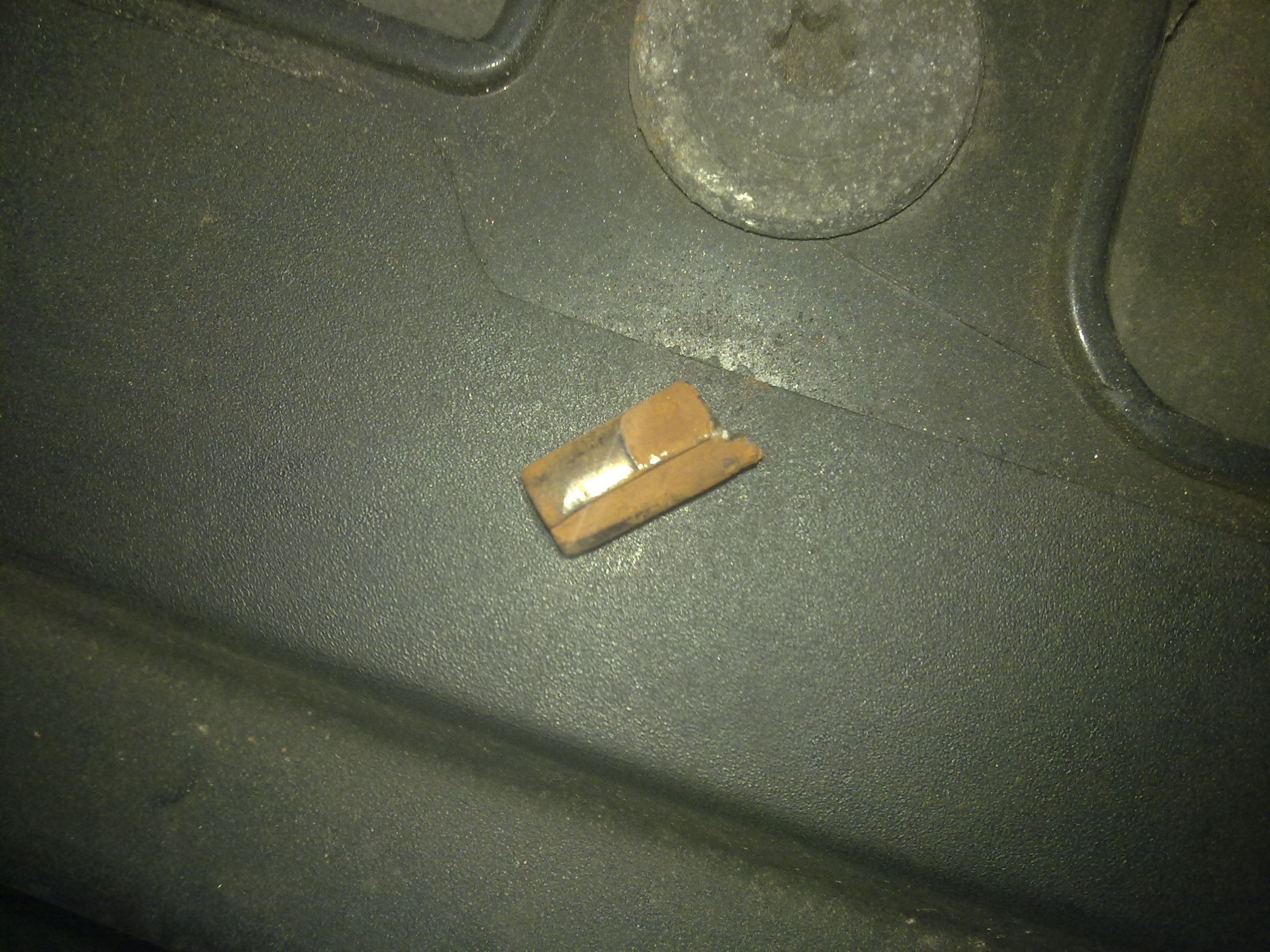

noticed it was sticking out a bit, so pushed with finger and it went straight back in, all gears present, YAY, its not a big problem :)
So anyhoo, it just pulls straight out and is snapped off half way down.
So what is it for exactly?? nothing seems wobbly or anything without it there :confused:

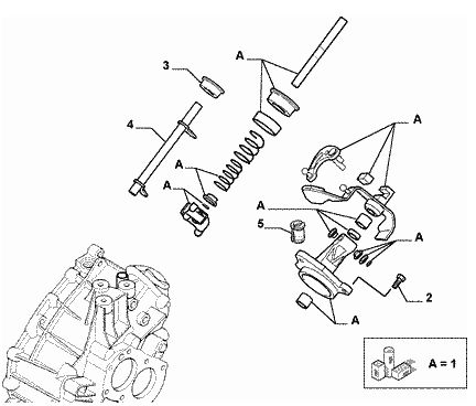

Looks like a retaining pin for the external selector shaft. The fact that you could pull it out means it's loose and the rest of it is likely to come out again. Probably when you really don't want it to.
Fiat do a repair kit for the external selector (part number 71733577) consisting of all the parts marked 'A' in this diagram but it's £159.63 +VAT. If it were mine, I'd be pulling it apart to see how it worked and making something to repair it with.
Bet your really glad you didn't buy that gearbox now.
Dave

Just looked at this again and I think item 5 in the diagram may be the pin. It's supplied seperately and is not part of the kit.
If you cant see anything else in the vicinity of your selector that looks like it, there's a fair chance that this is what you need. It's part number 71719553 and only costs 85p. It's described as a plug but ePER descriptions, and diagrams, are seldom very accurate. Would be worth checking if your local Fiat dealer has one in stock to compare with your broken bit.
If the dealer has to order it, they're only supplied from Fiat in multiples of 5 and you may have to buy all 5.
Dave.
i have removed the broken bit, so i am back driving for now.. Thats top stuff though mate (y) i will order one but i'm gonna leave it until it it/if it falls out. tried to move the remaining bit and its solid as anything so i'm happy with it for now, i will systematicly check it
edit, i'm pretty sure it is one of the pieces marked 'A' tbh though
