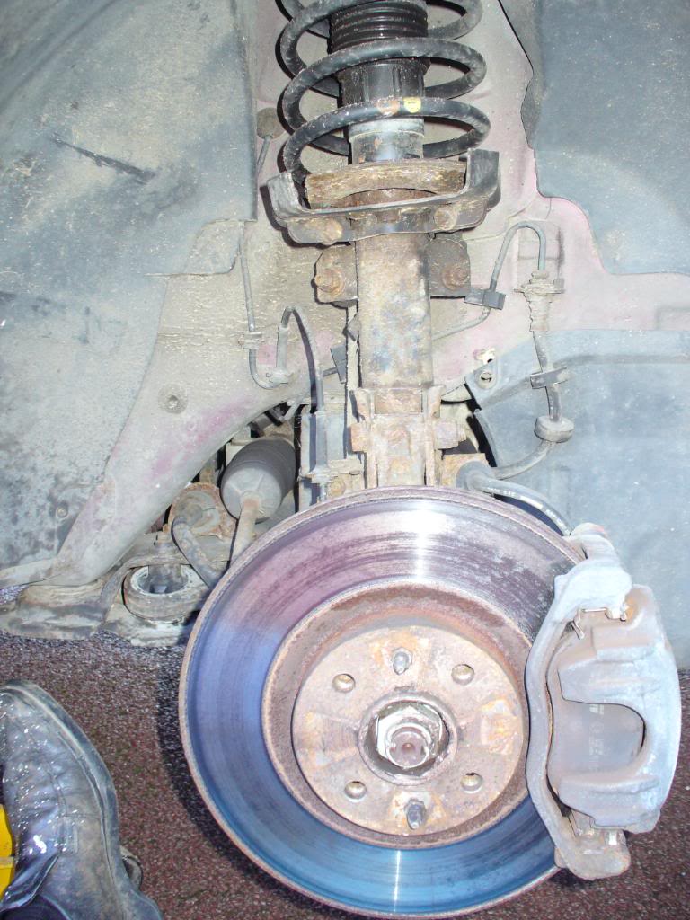

Now, why change brake discs? Well I changed mine because the discs were scored, worn wel down and tatty looking. I installed a set of Mintex discs and pads, this is how my brakes looked before the change.
And new disc next to old!

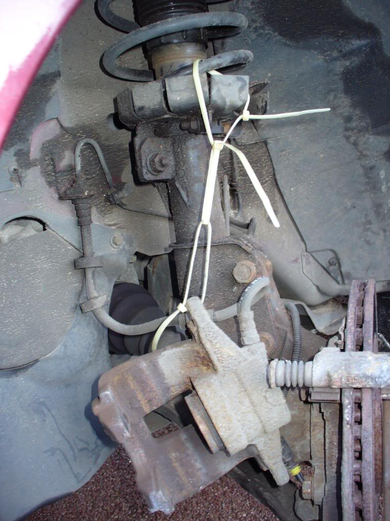

Then string up the caliper using some string, or some wire, or some zip ties like this

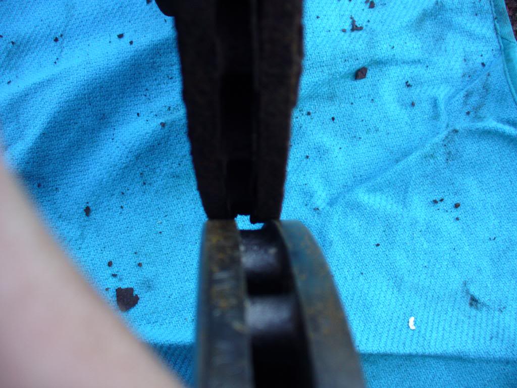

You'll notice the caliper piston is right out of the caliper. This needs pushing back in. Some bods do it by hand. I use ahuge G clamp. just slowly ease the piston back into the caliper slowly, it only needs to go back until the piston head is about level with the inside of the caliper body.

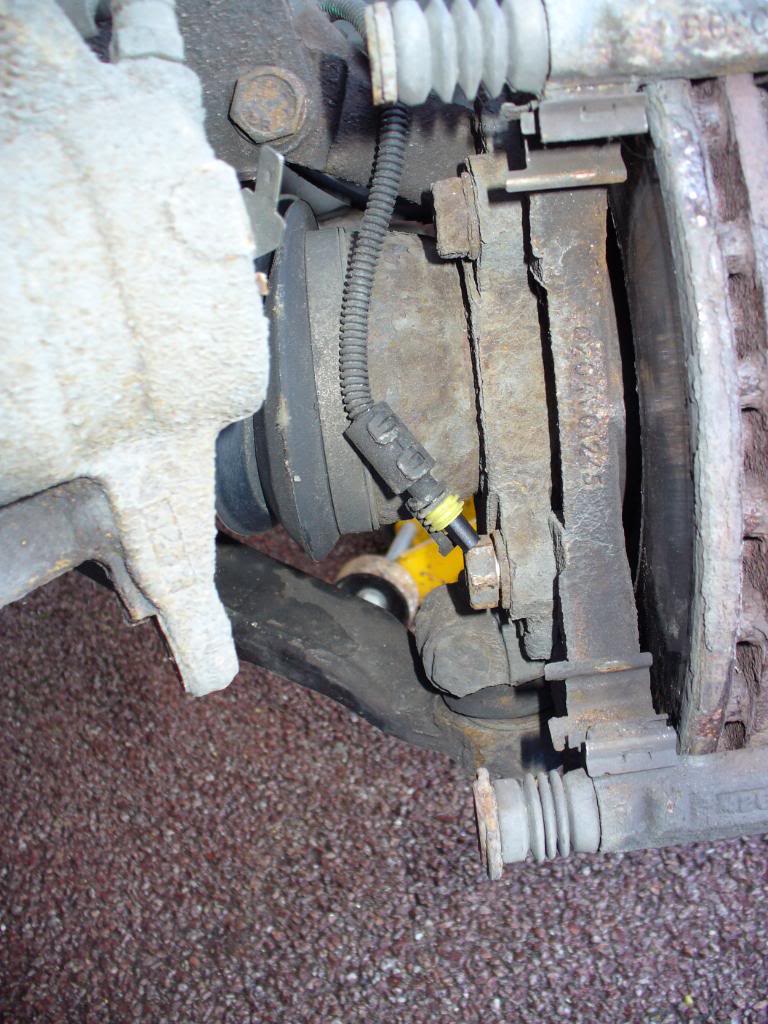

Next, off comes the caliper carrier. This is bolted on with 2 big menacing bolts that 'should' be replaced with new each time they are removed. In reality I reuse them, just pop a dab of thread lock on them before you screw them back in. These bolts will be mighty tight. I think they are 19 or 21mm heads, but a breaker bar, or a lot of muscle will be needed to shift them.
You can see them in this pic.

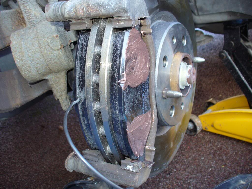

Then copper grease the caliper slides, the pad retaining clips and anything else that looks like it could squeal (metal on metal that will move. Obviously nowhere near pads or discs!) Then pop the new pads in the caliper carrier. Slather the pad backs with copper grease.

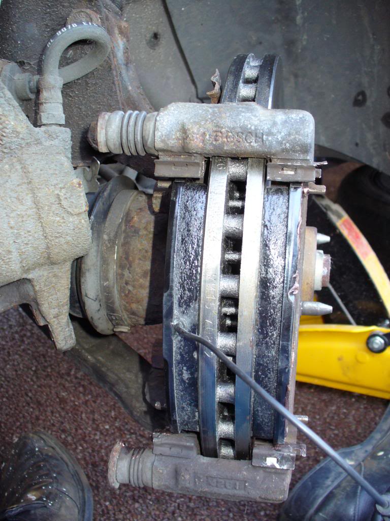

When its all put together it should look like this.
Last step is pop the caliper over the pads. Remember to copper grease the sliding pins that connect the caliper to the carrier. They don't actually fix the caliper, they allow the caliper to slide back and forth, so lots of grease on them as they go back in. A put a dab of thread lock on the bolt threads as they go back in, I shouldn't but I do, old habit.
