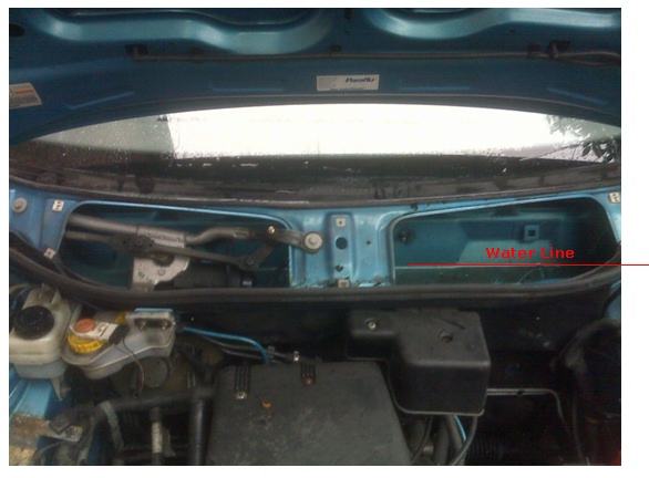

see water line (picture)
Drain Holes (usually Blocked) - (pic)
4) You will now see a puddle and the wiper motor is visible. There are what look like two rubber bungs in the bottom of the scuttle pod. Using a screwdriver or a 1" paintbrush push the gunk through to release the water. Now would be a good time to test the wipers and listen to make sure it is the motor.
