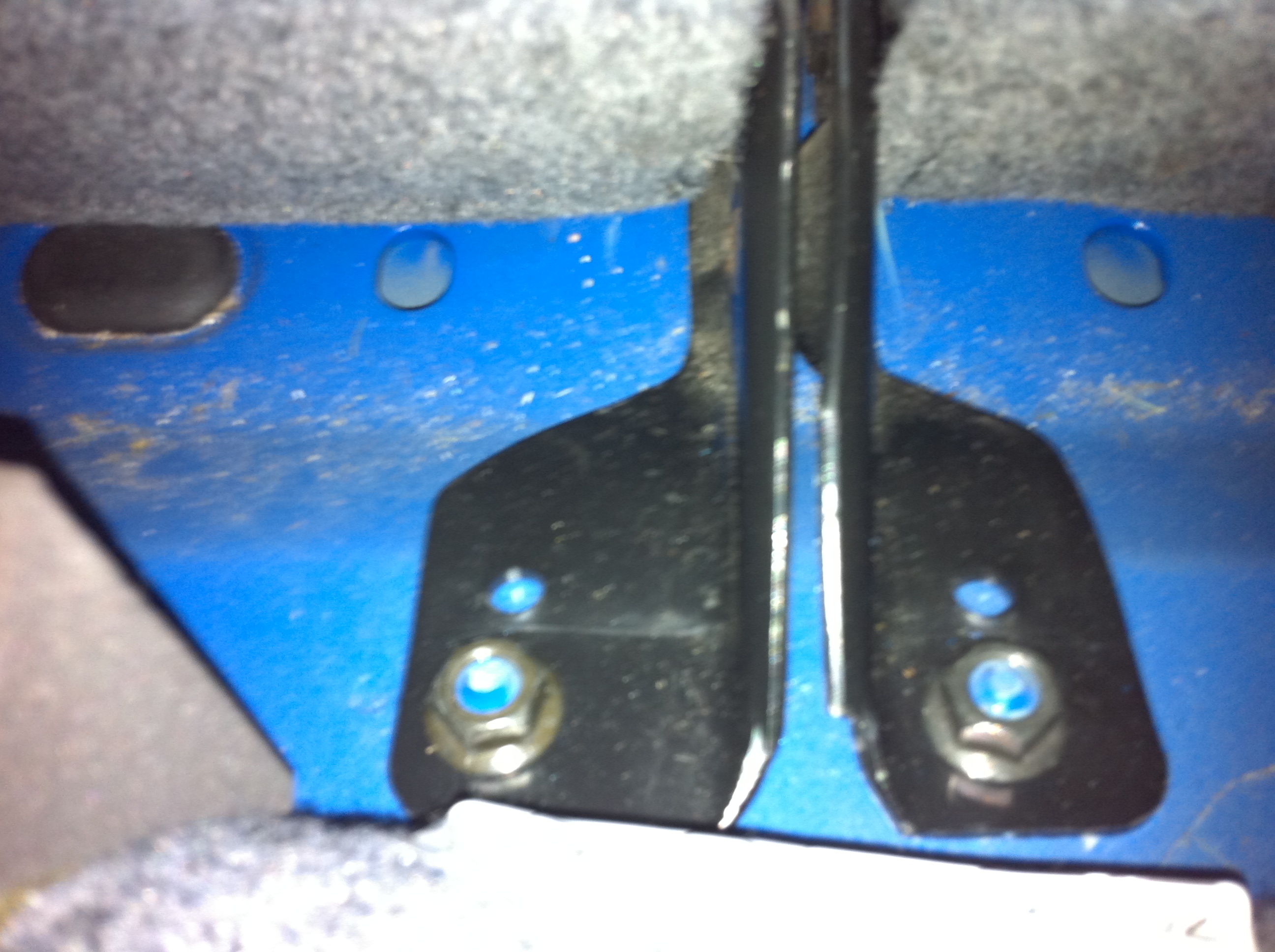

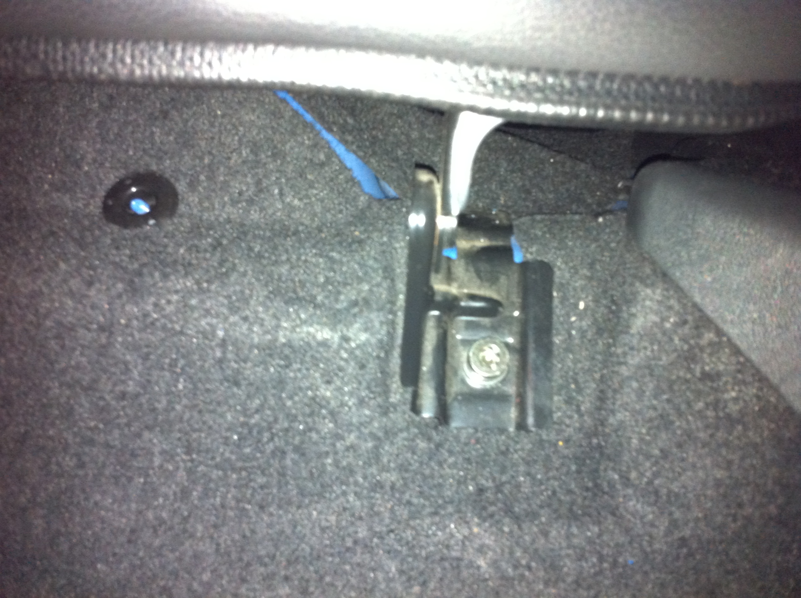

Start by removing the four bolts located under the front of the rear seats in the footwell, these are also six mm hex screw bolts.
Then the seat base's can be removed, now the backrest part of the seat, there are another four six mm bolts at the base of the backrest and in the boot underneath the carpet four nuts (12mm) These all need to be removed.
