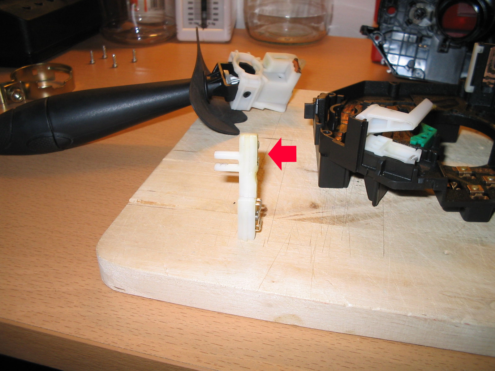

This plastic case holds 3 metal pieces which act like switches as the lights stalk is operated.
![03.JPG 03.JPG](https://cdn.fiatforum.com/data/attachments/24/24704-8aead11db37721c6032621497b430e5e.jpg)
In this my very case, one of the metal pieces had gotten stuck in its place so that it didn't close the circuit. Probably some bad surface connection caused heat (I guess!), eventualy ended up melting the case around the metal bridge.
![04.JPG 04.JPG](https://cdn.fiatforum.com/data/attachments/24/24715-9137f9ee3b3c62007c3373ad4a48a549.jpg)
The same stuation from a different angle. Compare the faulty one to the others.

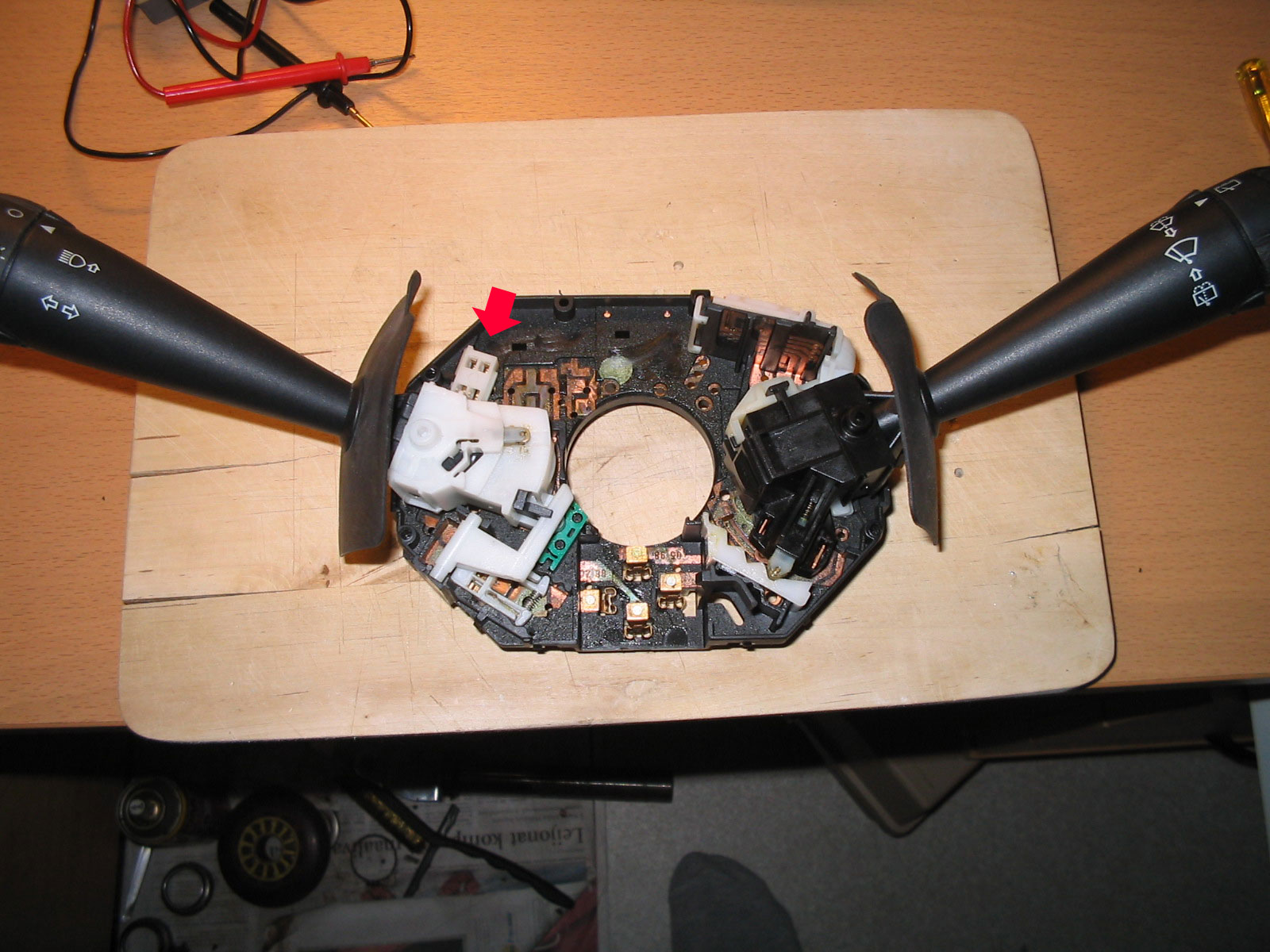

![ext1.JPG ext1.JPG](https://cdn.fiatforum.com/data/attachments/24/24791-5e127eba4735c96e1ebeb96c324f0ec0.jpg)
This one has nothing to do with the main procedure. It shows the wipers stalk in case someone is interested in.
