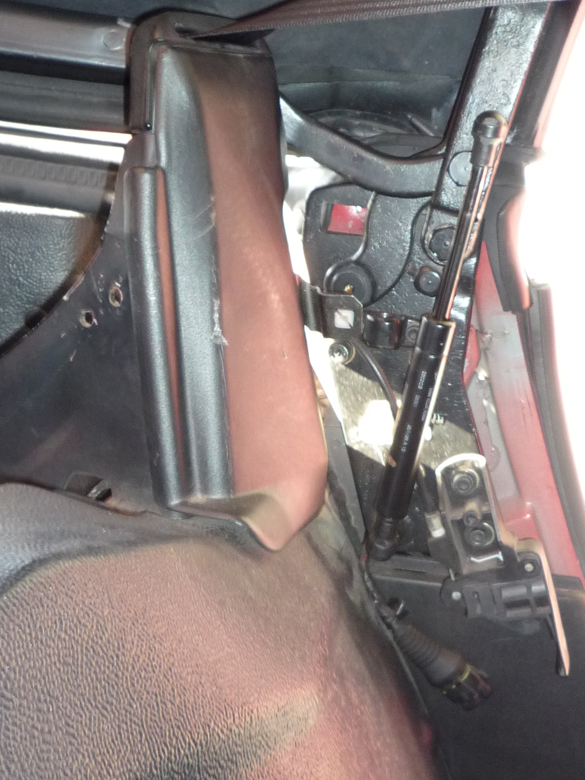

Step 1
Remove the plastic covers over the frame where it mounts to the car directly behind the doors. There are two cross headed screws. One is under a rounded rectangular cover you can gently pry out with a small screw driver.
You may need to pull back the rubber weather seal to loosen the plastic cover. The drivers side is hooked around the lever to release the hood cover.
Step 2
The old gas struts are removed by putting a flat headed screw driver under the metal clip on both ends and prying this clip out. The old struts can now be removed. If they still have pressure in them you may have to have the roof up to do this. Mine were completely shot so i did it with the roof down. Normally the strut will come off with hand pressure if the cips are released as shown in the picture but you can also pry them off using a tool such as one used to remove door panels

Step 1
Step 2
