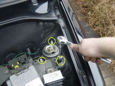

4.
Return to the engine bay and unscrew the 3 little bolts at the top of the strut.
When removing the last one, reach down and hold the strut with your free hand otherwise it will fall onto the floor.

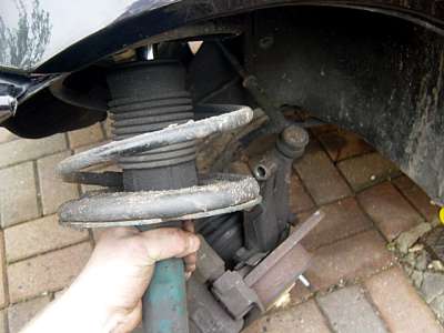

5.
The strut will no longer be attached to the car but before you can remove it you will need to detach the brake hose which is just clipped to the side of the strut. This simply pulls off.
You will now be able to remove the strut Completely from the wheel arch.

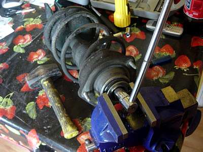

7.
Clamp the top plate of the strut into the vice. There are 2 notches on each side of the top plate. This is where you need to clamp it as it provides a firm hold on the strut. Clamp it tight but try not to dent/damage the plate.
8.
Using your trusty socket wrench, loosen the large nut at the top of the strut. This is likely to be very very tight! An extension bar might help if you have girly arms.
DO NOT Completely unscrew the nut yet, just loosen it! You wouldn't want to go and loose an eye now would you?

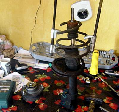

You now need to compress the springs.
For this you will need Spring Compressors. There are a few different types of compressors but they all do the same job. The type pictured above come in a pack of 2 (use a minimum of 2, 1 wont do the job) and they simply clamp onto the side of the springs. You then tighten the nut at either end to compress or decompress.
Place the first compressor onto the spring and tighten it to make it stay on. Then place the second compressor onto the the spring directly opposite the other. If you don't place the opposite, the spring will compress and bent to the side, possibly taking off your arm in the process...

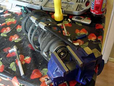

10.
With the spring compressed, place the top plate of the strut back into the vice. and tighten it.
You can now Completely unscrew and remove the large bolt on the top of the strut.
