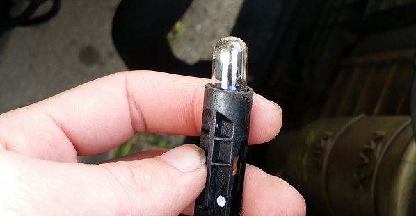

Start by popping the bonnet, and undo the 3 10mm bolts on top of the headlight. Now pull back the big cover and underneath the high beam there should be a cylindrical bit as seen underneath.
Pull it out by squeezing the 2 plastic tabs. The bulb can simply be pulled right out, and just push the new one in. The bulb in the picture is the old one.
Now simply push the cylinder back until it clicks, put the back cover on, the 3 bolts and do the other side, rinse and repeat. The left side actually is easier to do than the right side, in my opinion.
If you did it right, here is the result.
