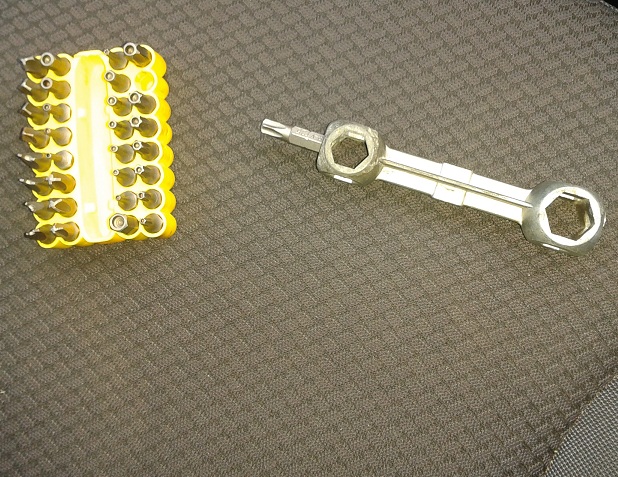

A torx screwdriver - see pic for a view of torx size.

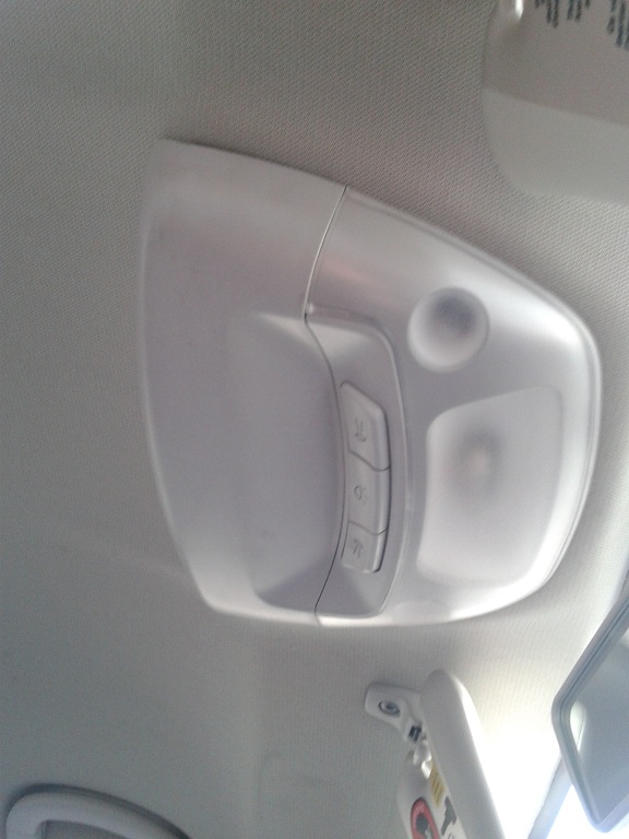

Middle bulb replacement (35mm Festoon Bulb) OR Side bulb replacement

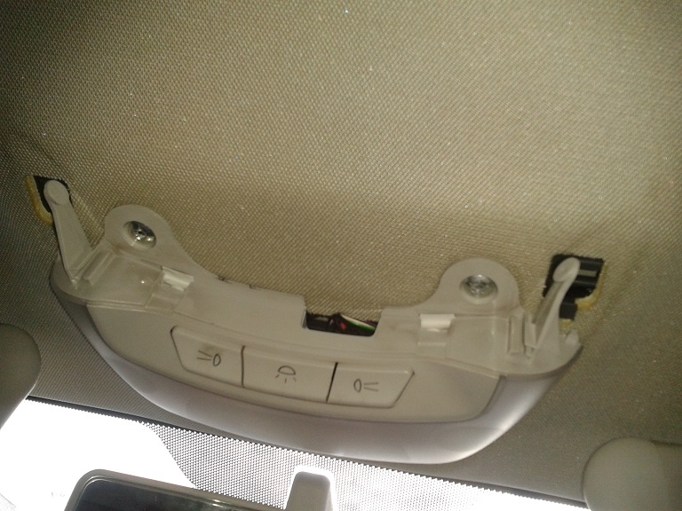

Revealing torx screws
Press in two buttons, right and left, which holds the first cover in place.
Then pull the cover towards the direction of the back of the car, slightly tricky, requires a bit of wiggling.
Remove screws and detach

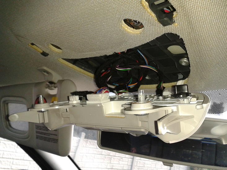

Replace bulbs
Slowly pull down light fitting without damaging/ripping wires until you can see the bulbs inside from on top at the front end.

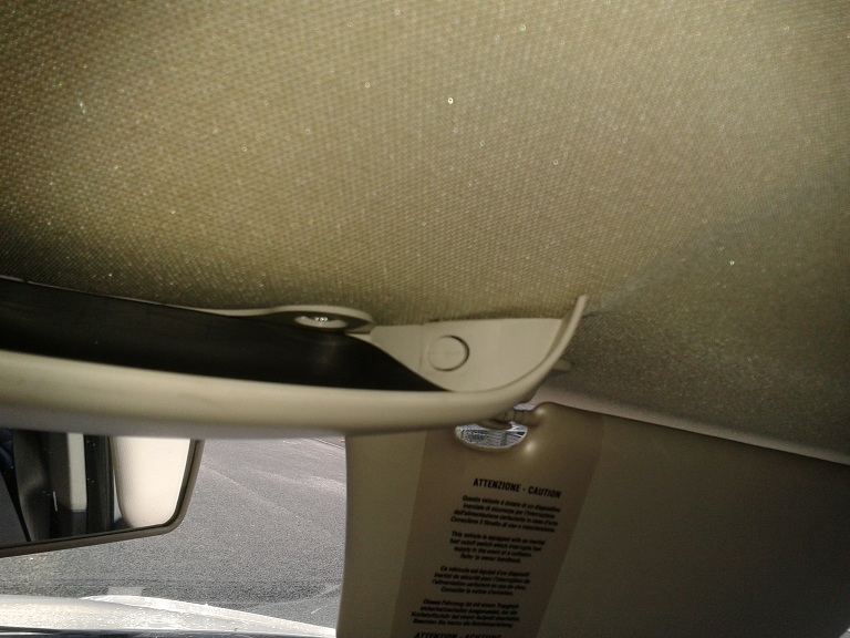

There is also one more side light symmetrical to the black one pictured above.
