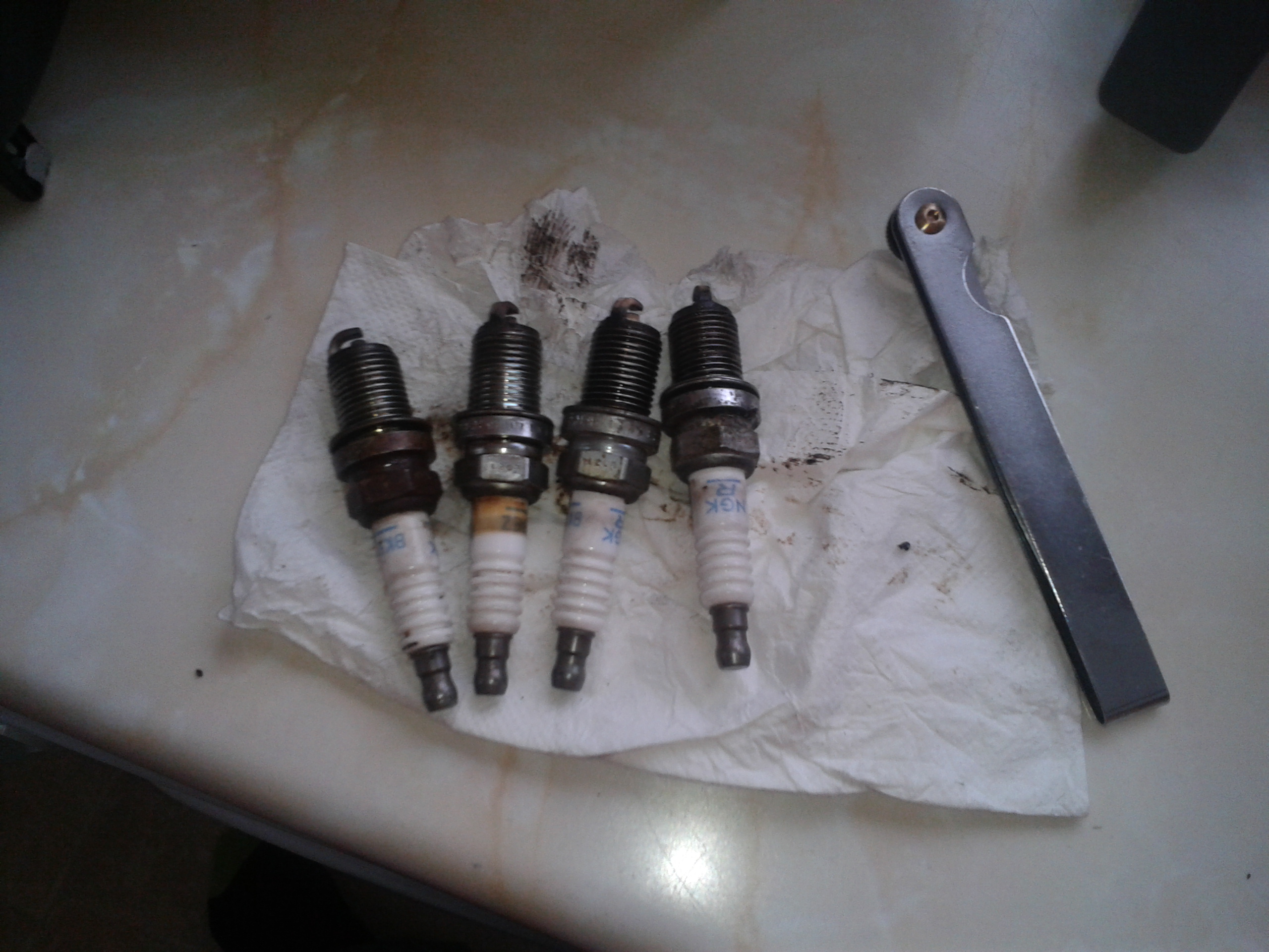

Keep these in order as they help provide a useful diagnostic
With them all removed and free - you should have all 4 in your hand
