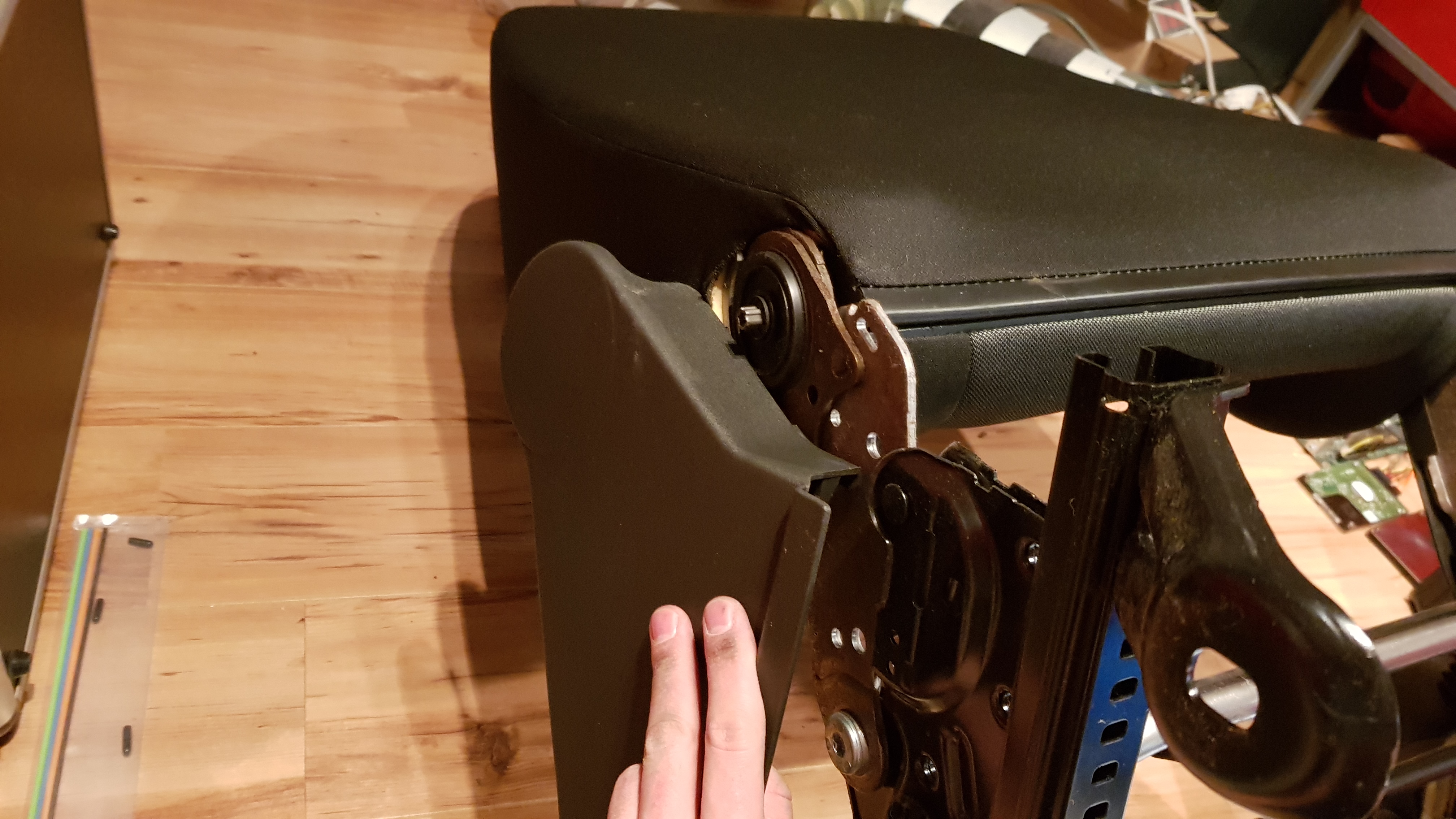

The fist thing you need to do is remove the seat, I should start with the passenger seat. If this job takes longer than expected and you need to drive, then you still can drive. Unscrew the seat with the 4 hex screws on the corners of the seat rails.
Once the seat is out of the car, remove the lower part of the seat with the two 10mm bolts on the front.

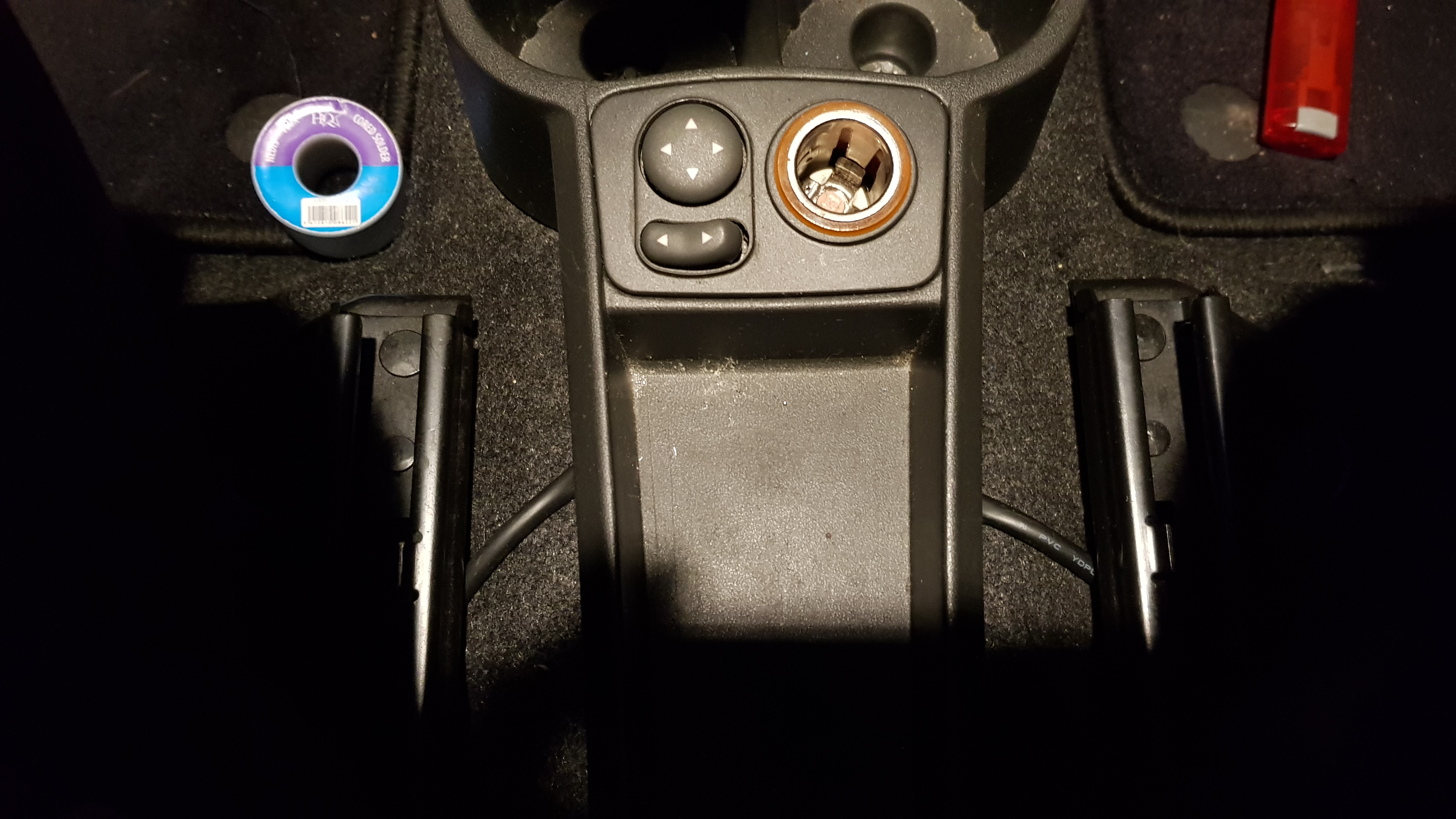

The inside of the seat is a good choise becouse you can route the cables to the center console whre the sigaret light is. You can get the 12V supply that is switched so the heated seats won't empty your battery.

I've connected the 12V to the sigaret lighter. There are three wires, you need the black (negative) and the blue (positive) wires. Cutt these wires and solder the red and black wires to the blue and black wires.
Once everything is done the cables look like this.
