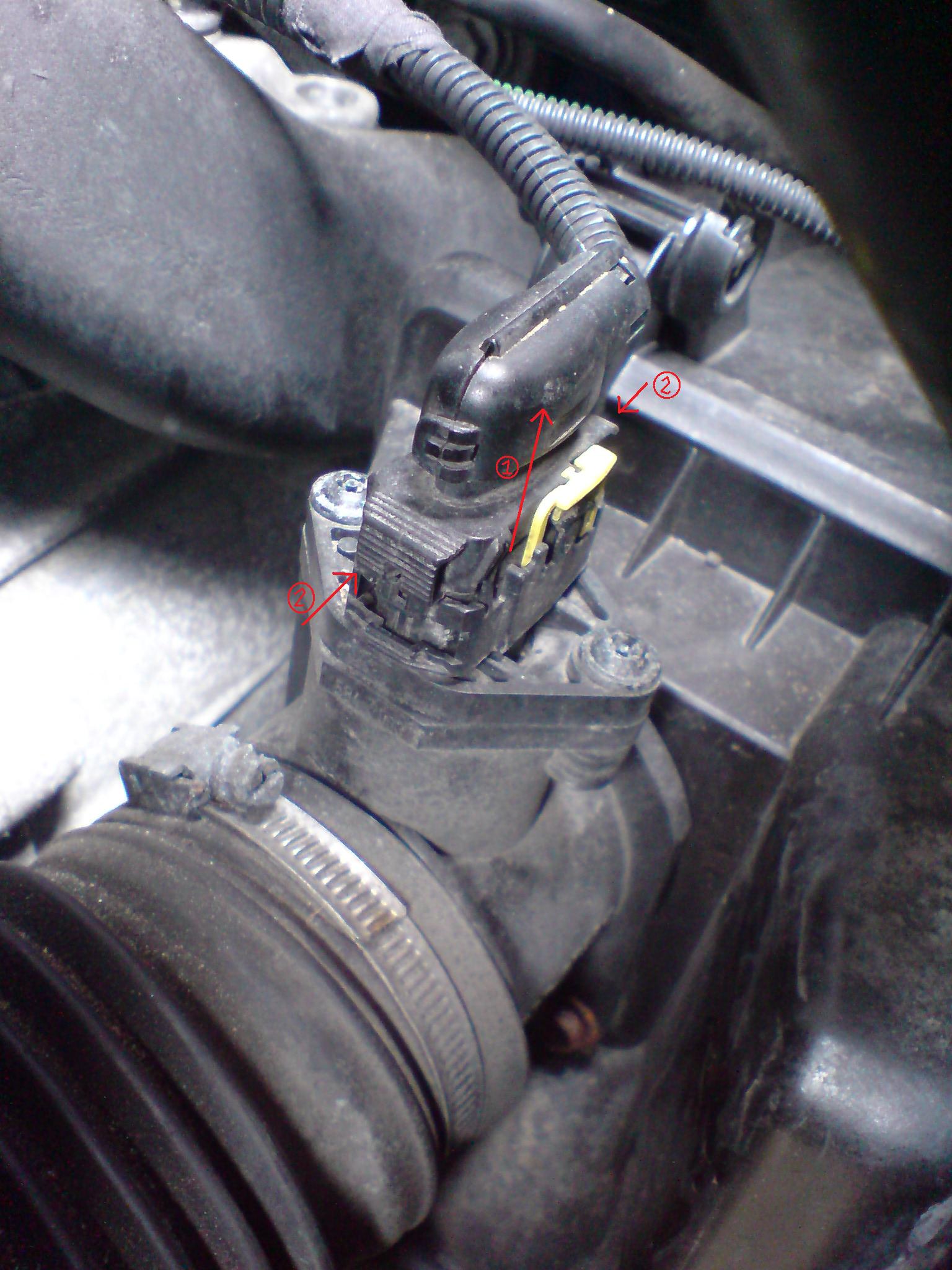

First locate the MAF housing assembly. It is very easy to see as nothing obsructs it. It is the hard plastic pipe with a plug init that is conected to the flexi pipe; that goes into the turbo, and the air box. (When looking it will be to the right of the engine.)

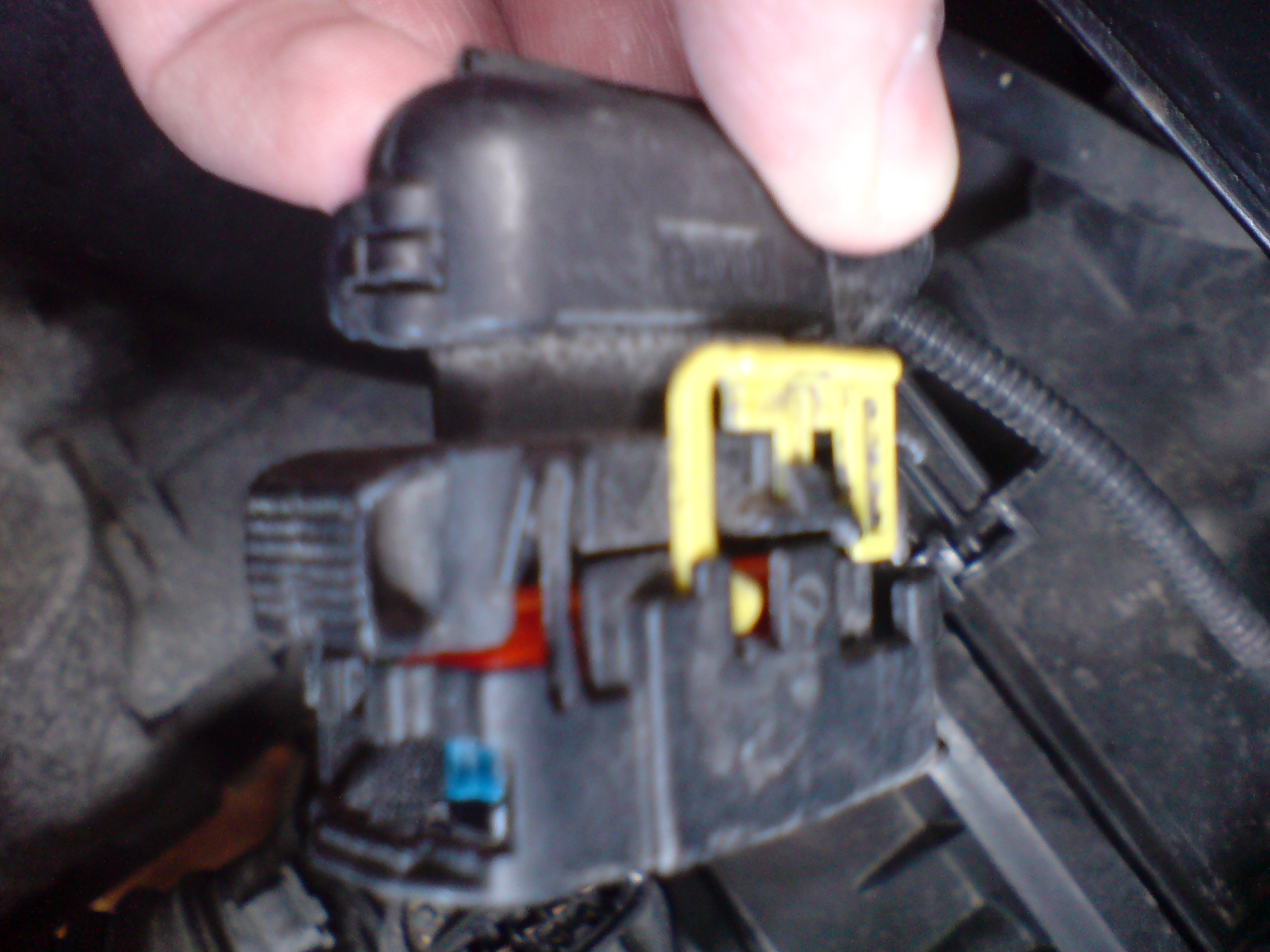

first unplug the conector pluged into the MAF. To do this you must pull the little yellow clip up towards the sky, then on each end of the plug there are compressable clips which you must squeeze together to pull out the plug. see the diagram below;
1. unclip little yellow clip
2. squeeze and pull upwards
removed conector;
