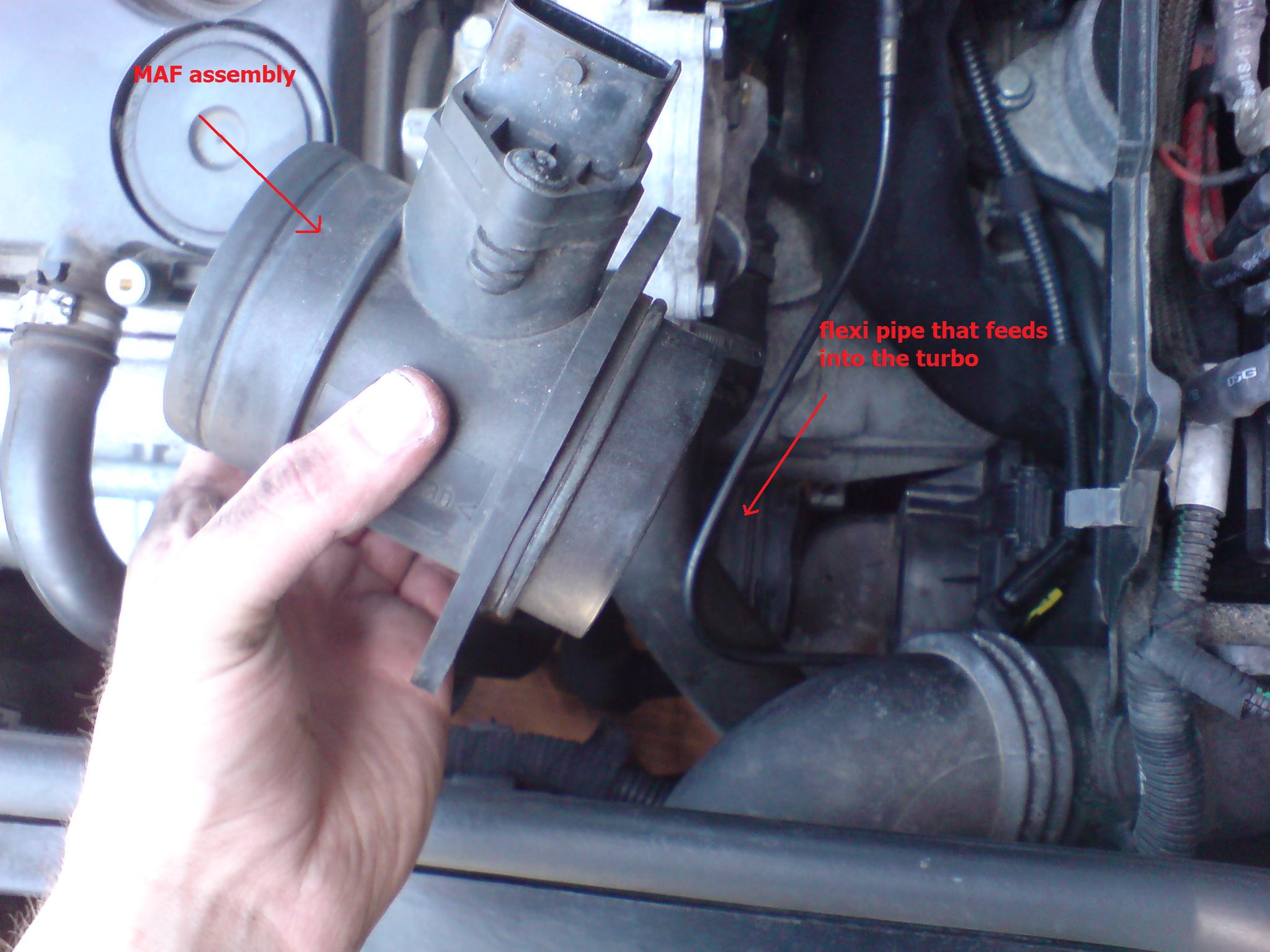

then undo the bolts that secure the plastic housing to the air box. there are two, in opposite corners. you may need to use a ratchet socet peice with an extending bar and go from underneath to remove the bottom one.
then undo the the gubilee clip/ or remove the fiat clip that holds the flexi pipe onto the other side of the plastic MAF housing. If its a jubilee clip slide it off the rubber flexi pipe and onto the hard plastic of the MAF housing as it will aid you with the next bit.
now to take out the plastic hosuing, you need to hold it against the air box with you right hand and compress the flexi pipe towards the turbo with your left which should unplug the pipe from the hosuing. then you need to squeez the end of the flexi pipe together and push it downwards and underneath the plastic MAF housing while easing the MAF housing upwards and free from the air box.
