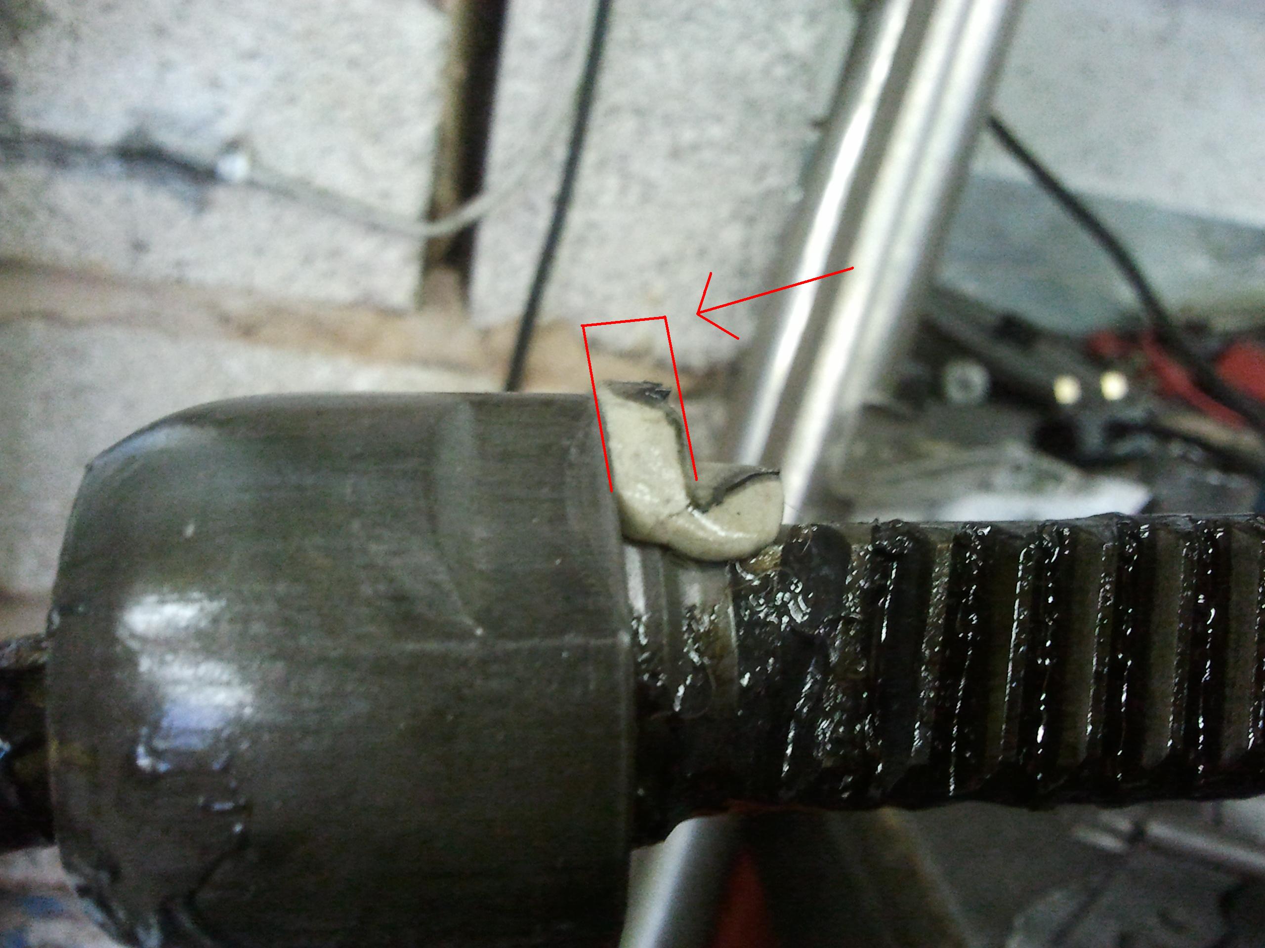

jack the car back up and you should have something looking like this:
if it has not touched inside, add a little more plasticine then try again.
once done measure the thickness of the plasticine shown here:
now contact me or an engineering shop to have spacers made(y)
