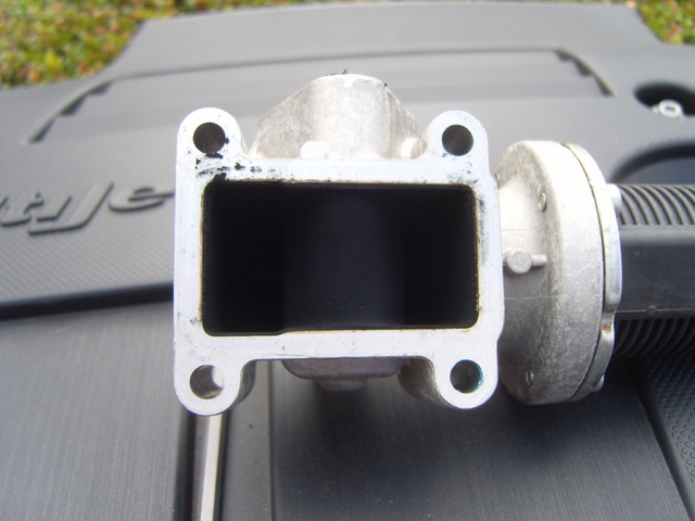

this was carbon build up in intake side of valve i was supprised for only 16,000 miles.

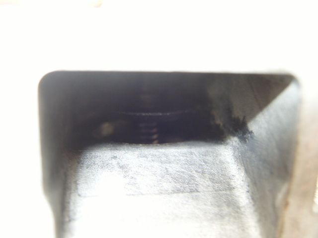

this was exhaust inlet side of valve not clear in pic but was approx 2mm of build up all over.

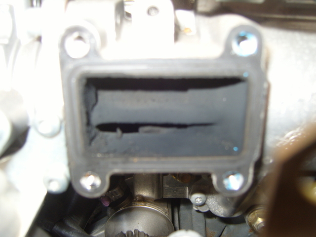

this was build up in inside of the inlet manifold looked same at 2mm or so, i did not disturb any of this as didnt want chunks going through my engine.

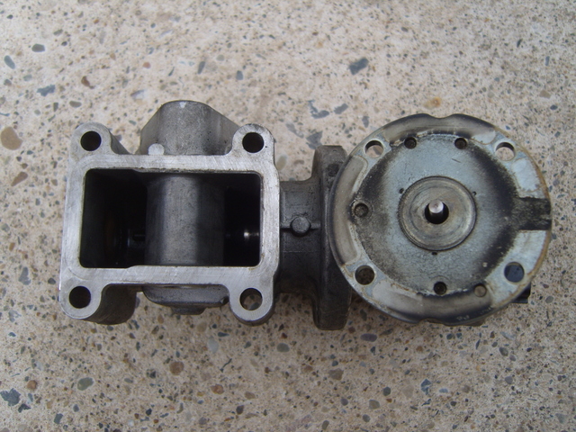

next you will need to split the valve into two by removing the 4 screws with your t25.i scribed the join of the two halves to make sure it goes back together in same position.

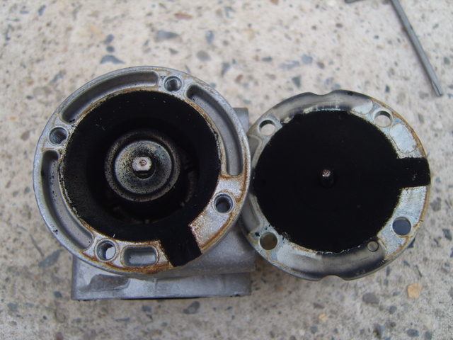

the solenoid half of the valve required minimal cleaning as its only leakage through the valve stem that gets in there.check for free movement of plunger mine was nice and free, i thought about spray lube inside but decided against it incase it gunks up so left dry.

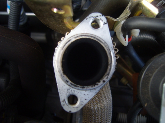

i decided not to clean the exhaust gas pipe, will leave that for next years clean but if you decide to do it it looked like a 5mm allen key is required to undo a clamp down below im guessing theres a gasket of some sort in there and would need realigning upon refitting.
