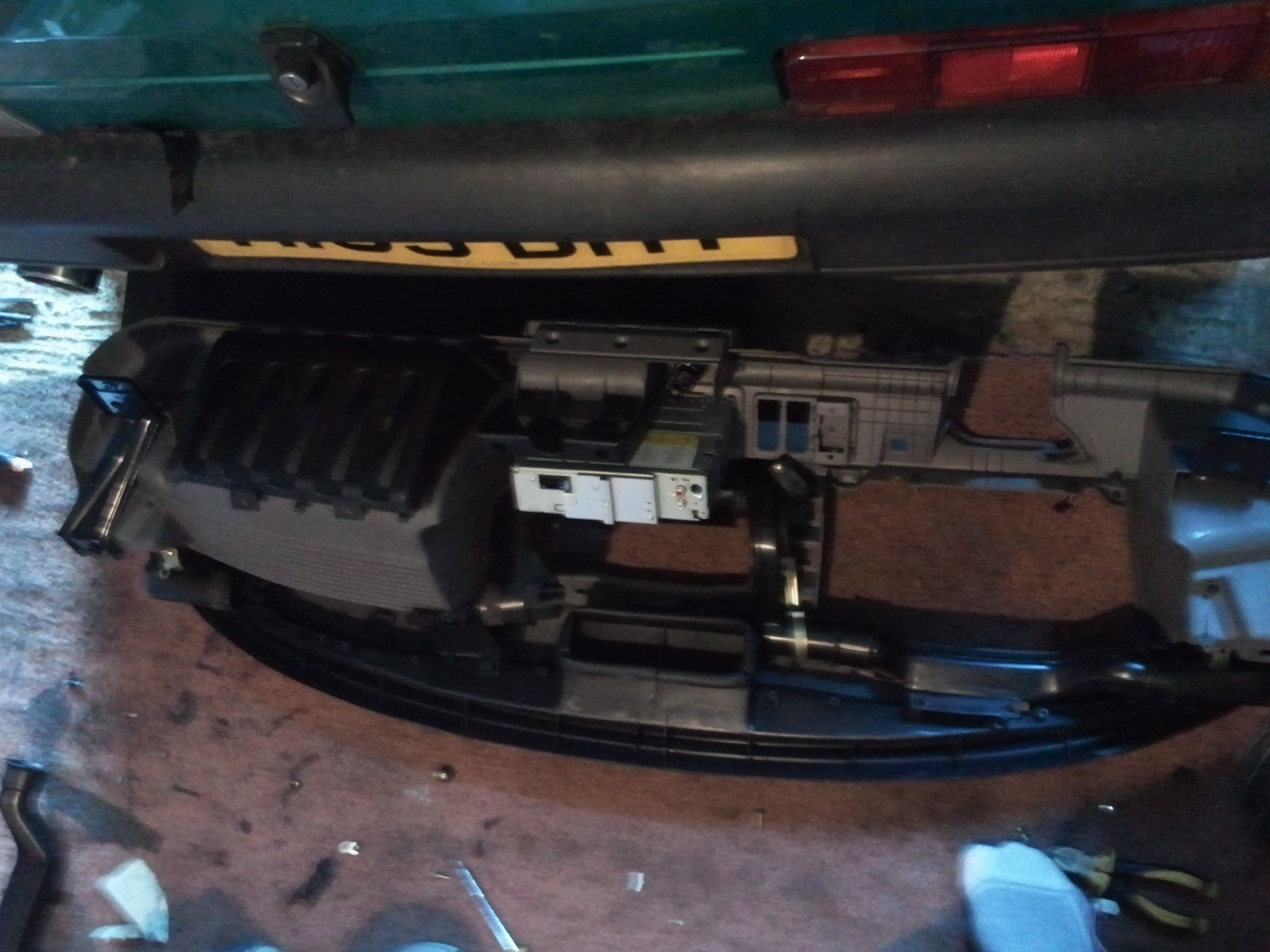

striped the 899 dash loom

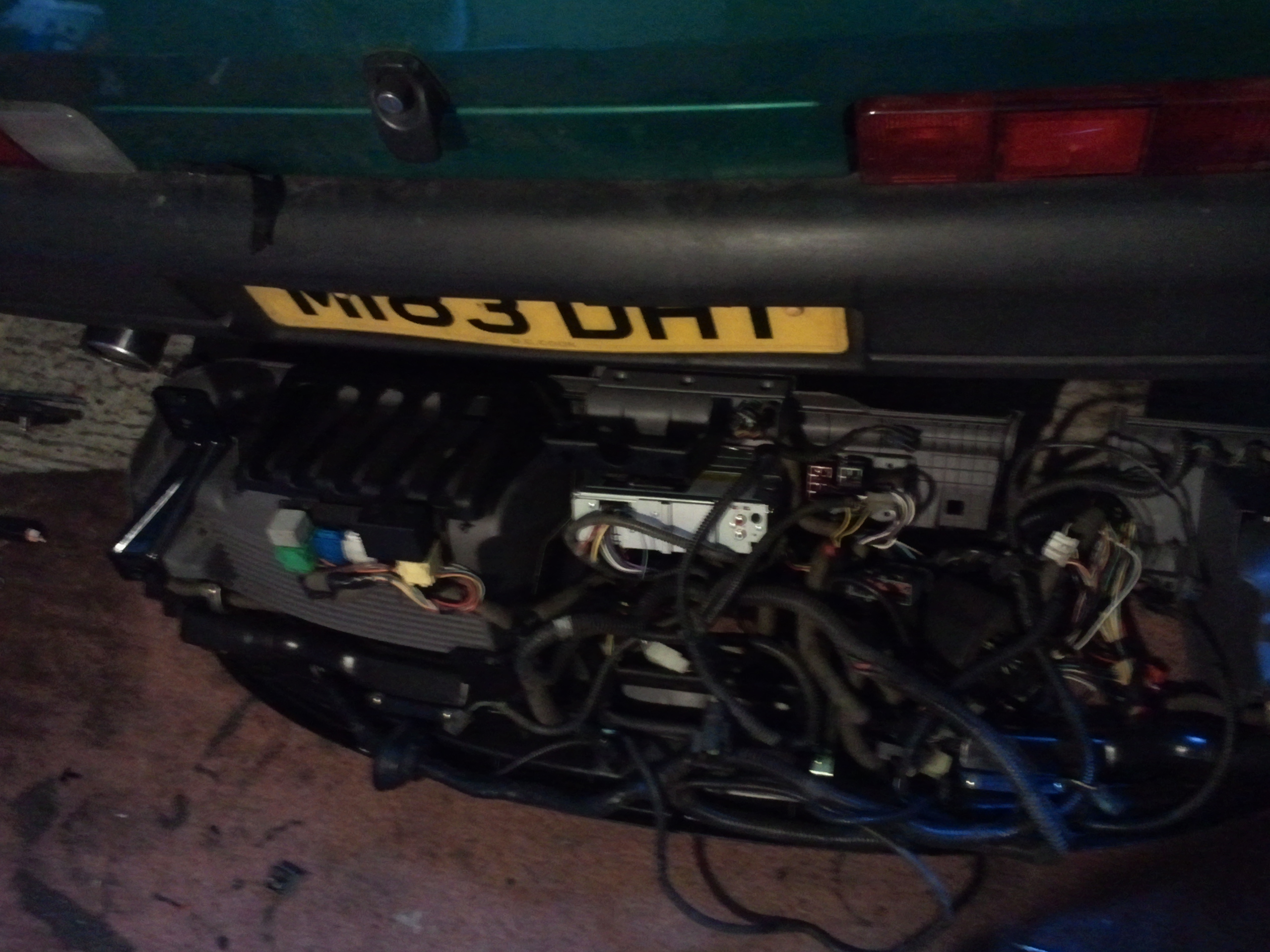

fitted the sporting one

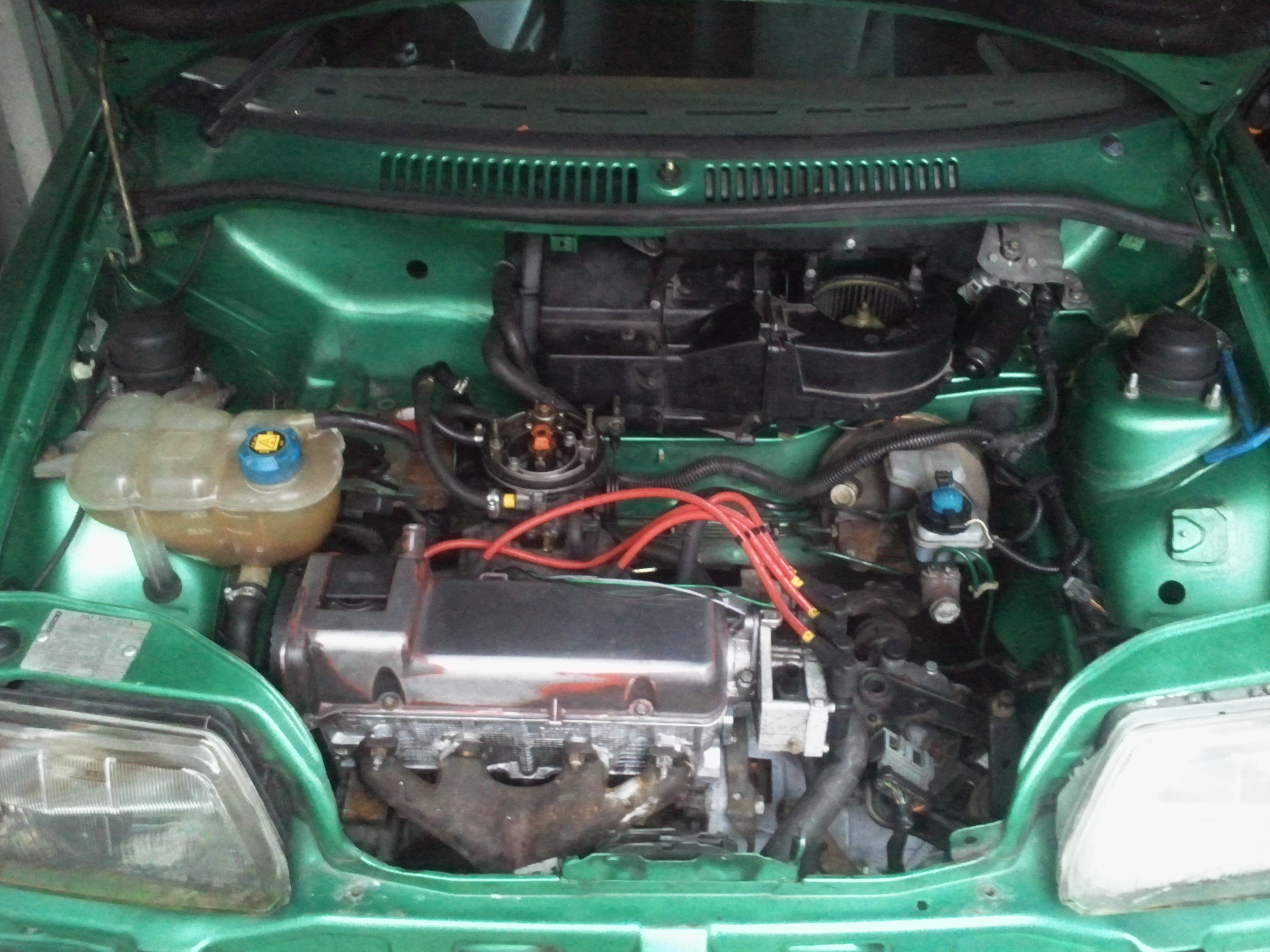

loom cooling system and heater all fitted :slayer:

The behind dash wiring looks insanity-inducing :) Are you fitting leccy windows and central locking too? Seen as you seem to be swapping all the electrics around anyway.
Also, did your top cover have paint on it, or is it weird reflections?
[edit] nm, just noticed you have the switches and loom in place, for the windows anyway.

yes timings grate and all 4 sparking good look at the video link above it may be map but it ran grate other day when my mate was round but wen wee got it to the bottom of my drive it did this problem then wen we managed to get it back up it ran perfect went to start it today and the same happened
Re: my green cinq project
Check the wiring for anything wierd -- all the stuff from the TB. My guess is something is earthing out. Also, sometimes one of the wires to the injector can get pinched where it enters the TB, causing it to either fire continually or to fire more often than it should.
As always with lumpity idle, compression test recommended.
