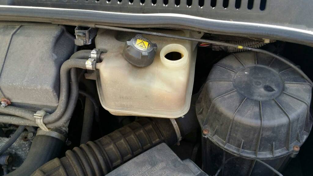

This started about a week ago.
I cleaned it up once hoping it was a once off, but it keeps coming back.
Is this related to the heater matrix?

if it is you have been neglecting it it shouldnt be rust colour, has the coolant level dropped?
check scuttle panel under bonnet it should have drain holes than can often be blocked by leaves so fill with water and over flow into cab (if you're lucky)
does it smell?
Similar to mine and many many others, crap design and even worse backup from the manufacturer, I've all the bits to modify my scuttle grill, search "water ingress" on this ducato forum and you will find the aftermarket fixes, (P Seal to seal scuttle to screen, pipe inserts & hose to improve drainage, foam expanding tape to seal around headlamps,trims & bonnet edges) just waiting for slight "oops" accident damage to be repaired before tackling the mod
thats the coolant expansion tank :( coolant goes in there ( anti-freeze water mix)
if its brown an rusty its not good should be a nice colour. go motor factors and ask for coolant that will mix with any colour, dont drive van there, if you drive it now you may do more damage.
the coolant stops things rotting away,

if its rain there is no panic, if cooling system is sound you can drive it any where to fix a rain leak even to stanford
anyone know if its dash out to fit a new matrix on these? you may need help from some one your side of the river if cooling system is leaking Davren ;);)
Also check make sure fan is kicking in when it gets hot...
keep an eye on the level whilst running,
( a torch / light behind bottle will help)
the fan cutting in + out will alter the level,
just watch the MIN + MAX of it's heat cycling..
you may of course be shifting SOME air.. if it's been LOW for long,

3 more drops of water that - if it is a leak, it must be tiny - I'll be so sad if it needs a new heater matrix, thats a 2-3 hour job isn't it :cry:
It does need an MOT next week too - so I guess if we don't get it resolved by then, I'll just get them to check it over. Obviously don't wanna spend masses of cash if I don't need to though....
I'll leave it overnight now and come back tomorrow - see where the level is.
