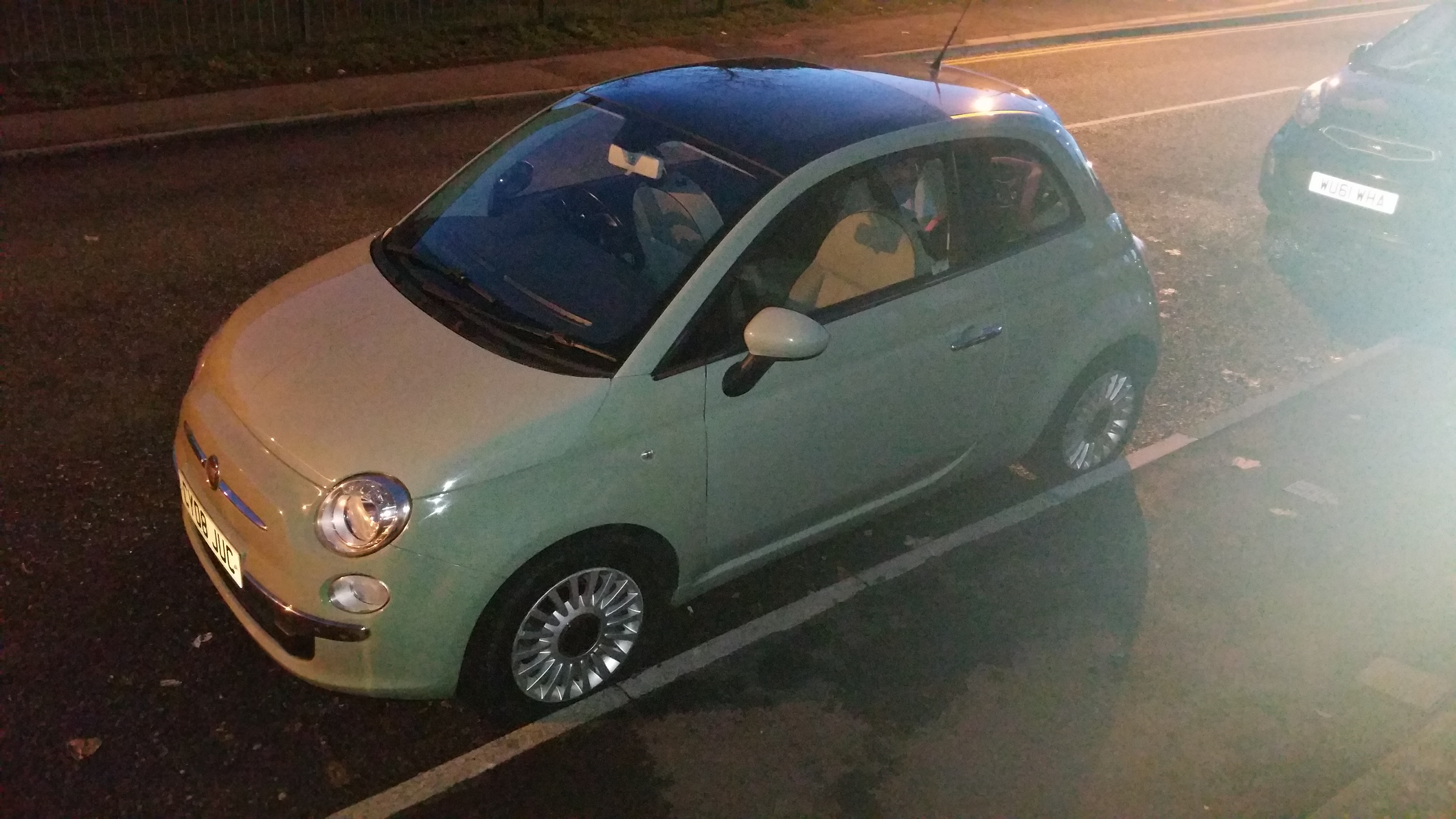

Not the best picture, been out all day in her and touch wood no further issues! ?
