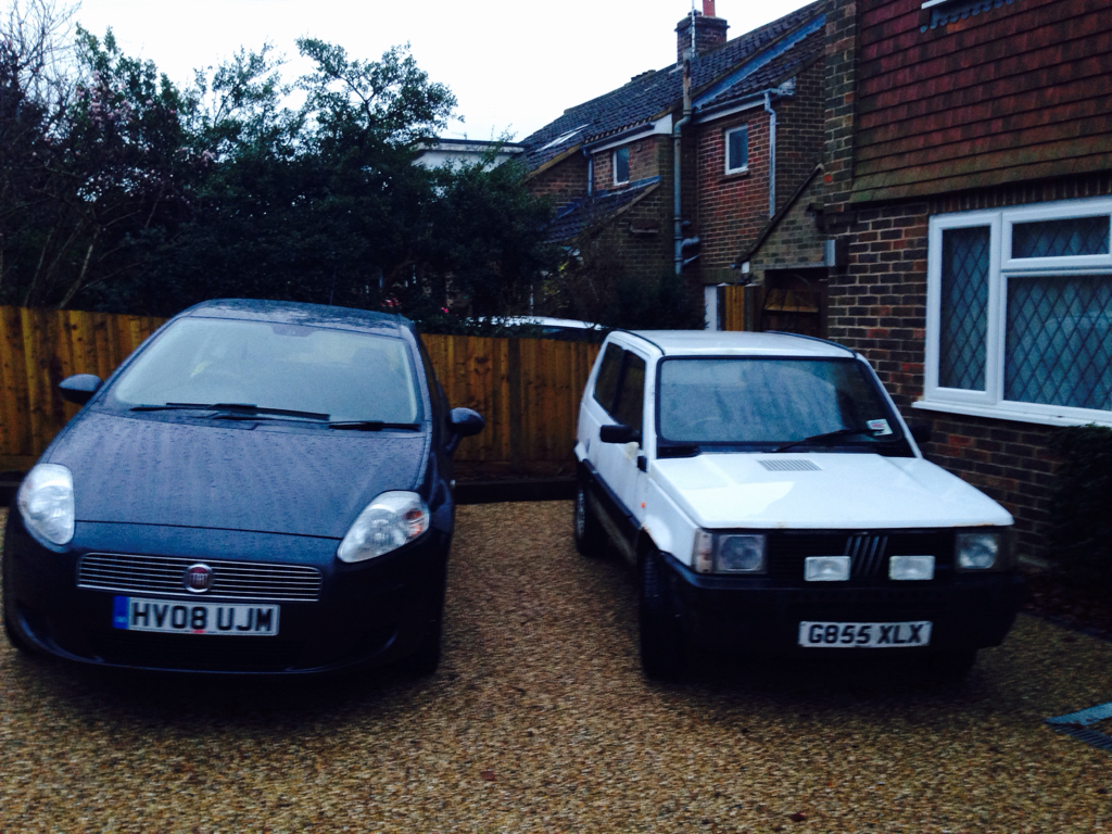

So after buying my panda as a non runner and on the way home the tow rope snapping , Genaro is now home!
With some new fuel and encouragement he is now running perfectly , getting up to temperature, the fan working, everything working as it should, even after not running for a year!
Hasn't been serviced since 2007 ( besides the cambelt being done in 2013) so a service is the first thing to do,
Gears are a bit crunchy... But looking underneath where the passenger driveshaft joins the gear box , it's weeping a little bit.... So maybe the oil is a bit low in the gear box and needs topping up along with a new gasket.... The exact same thing happened with my punto ( with the same fire engine!)
Bit of sanding and white paint here and there and it'll be ready to go back on the road!

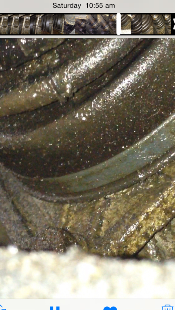

Also these are the picture of the leaky driveshaft... Time to replace the drive shaft seal and cone? ;)
ImageUploadedByFIAT Forum1421878083.564324.jpgImageUploadedByFIAT Forum1421878108.919610.jpg
i would replace the boot and the bearing oil seal.
it can be tricky and its a full drive shaft out job to replace the bearing oil seal as it has to be drifted off the drive shaft with a perfect fitting metal tube.
if you are very cute you can use a very blunt chisel to drift it on and "walk" it down the shaft but its really hard to do. the chance of damage to the new oil seal is high.
remember that the CV boots hold in ALL of the gearbox oil. when you fit the new one, not only zip tie it on but also use some instant gasket around the lip each end just so it makes a perfect seal.. and also make sure theres no oil around where you are sealing.

Thanks I'm sure I won't be too bad to sort out
Hopefully everything will be done and back on the road by mid/end of March? Optimistic? We shall wait and see ;)
euro car parts.. they will have them in stock too. will cost about £24 though but its not too bad as you get a nice quality cv boot and a good bearing.
give them a call as it does not show up online.. :rolleyes:
Spoke to eurocarparts and they told me it's now £89 excluding vat and they are going to stop selling them soon and that's the best price they can doo ???
Everywhere else doesn't do them
Thanks no idea how I didn't seee that, so I'm right in thinking the kit also includes the oil seal?
Yes it does.
This Inner Drive Shaft Boot fits into a three bolt metal flange and has a clip to hold the other end onto the drive shaft
It comes with an inner bearing/oil thrower which fits onto the shaft
This Kit comes with a new Rubber Boot, Bearing & Clip (No 3,14 &15 in the diagram)
