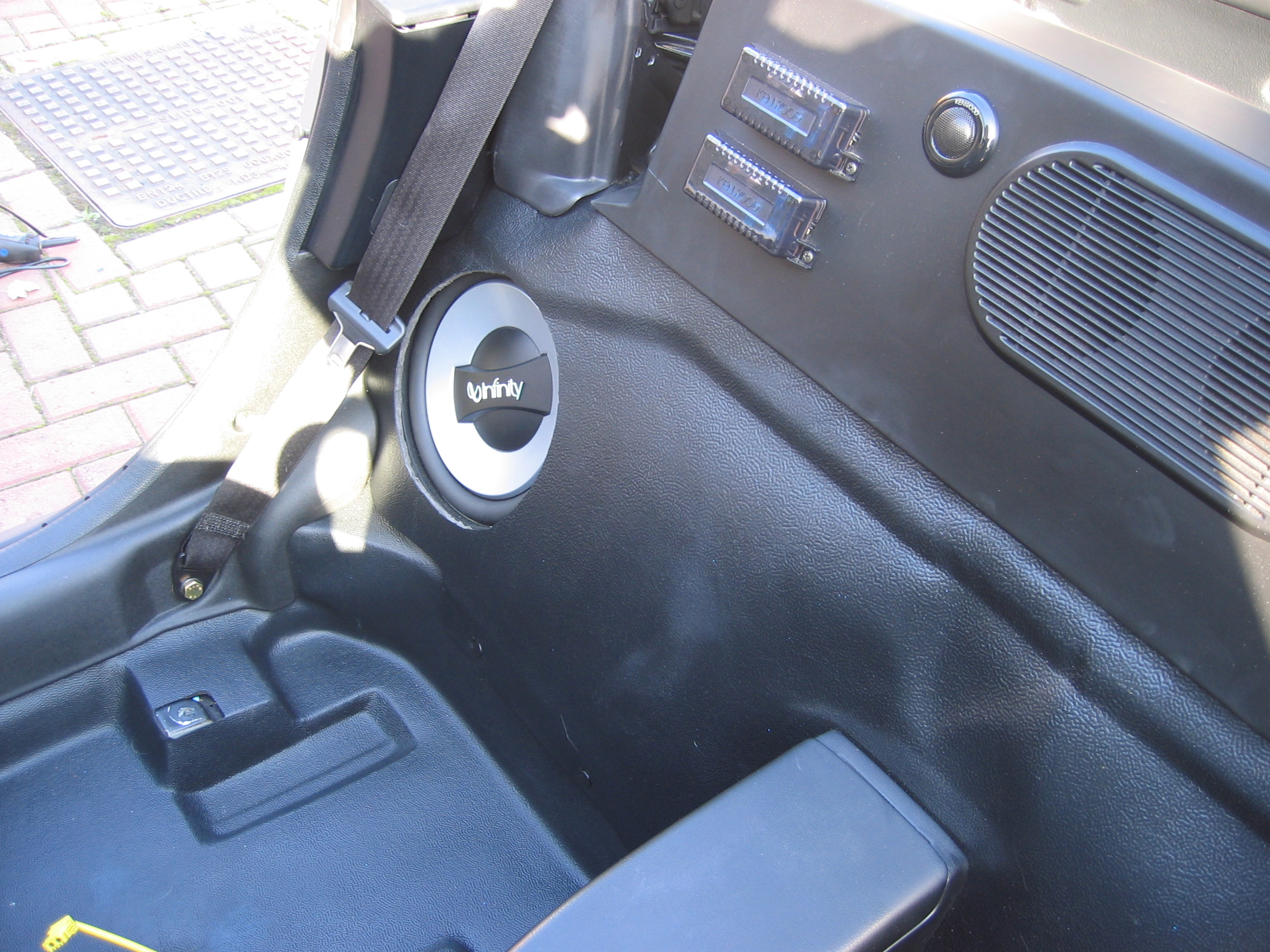

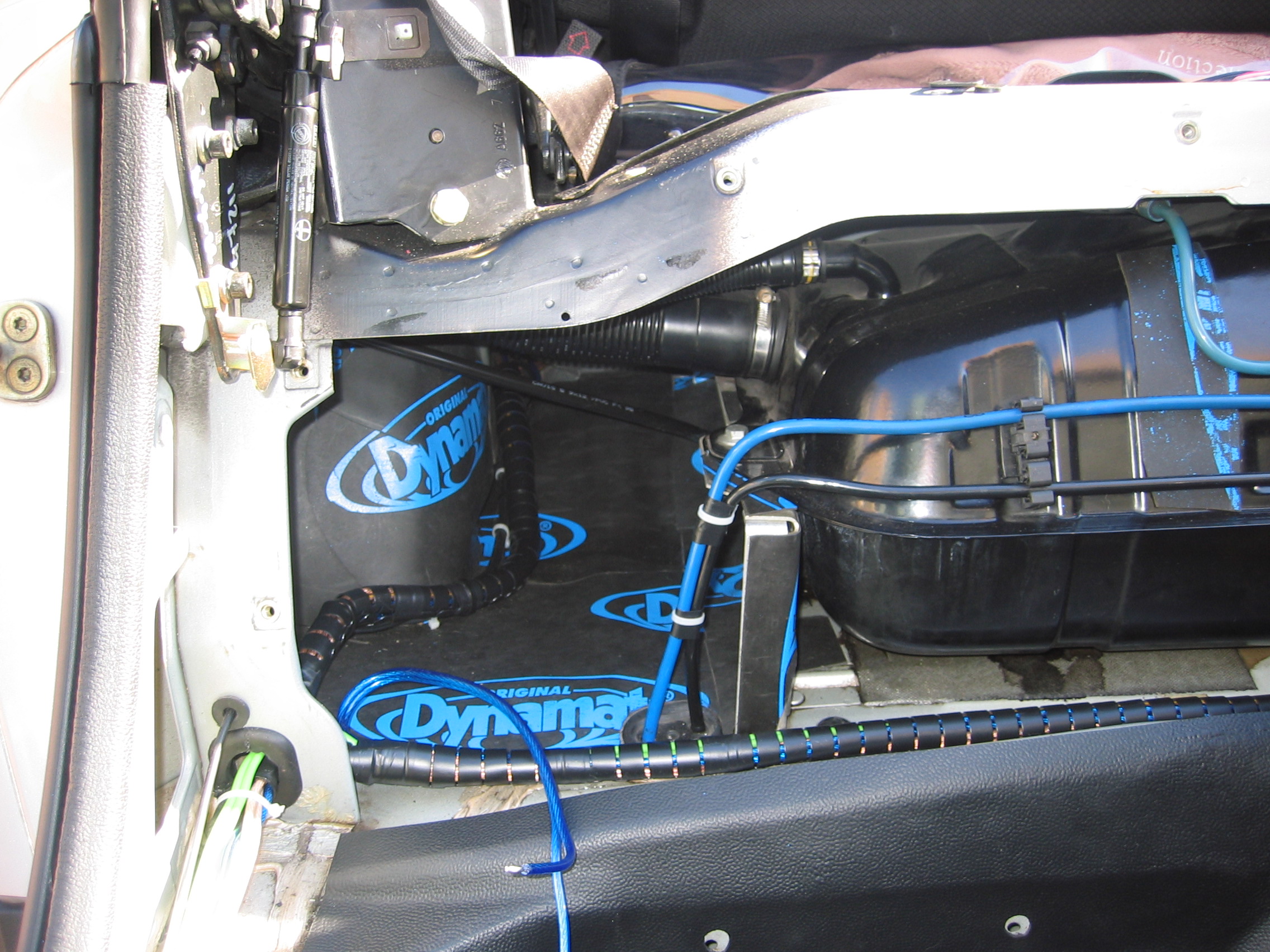

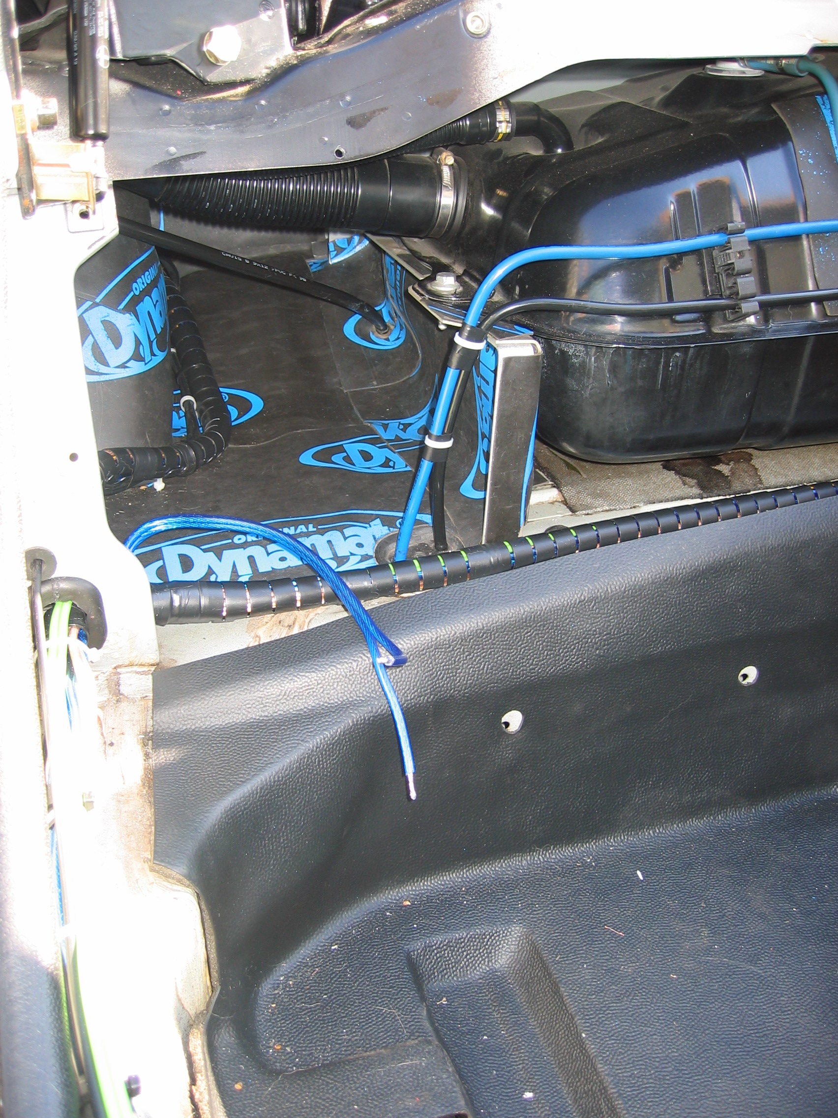

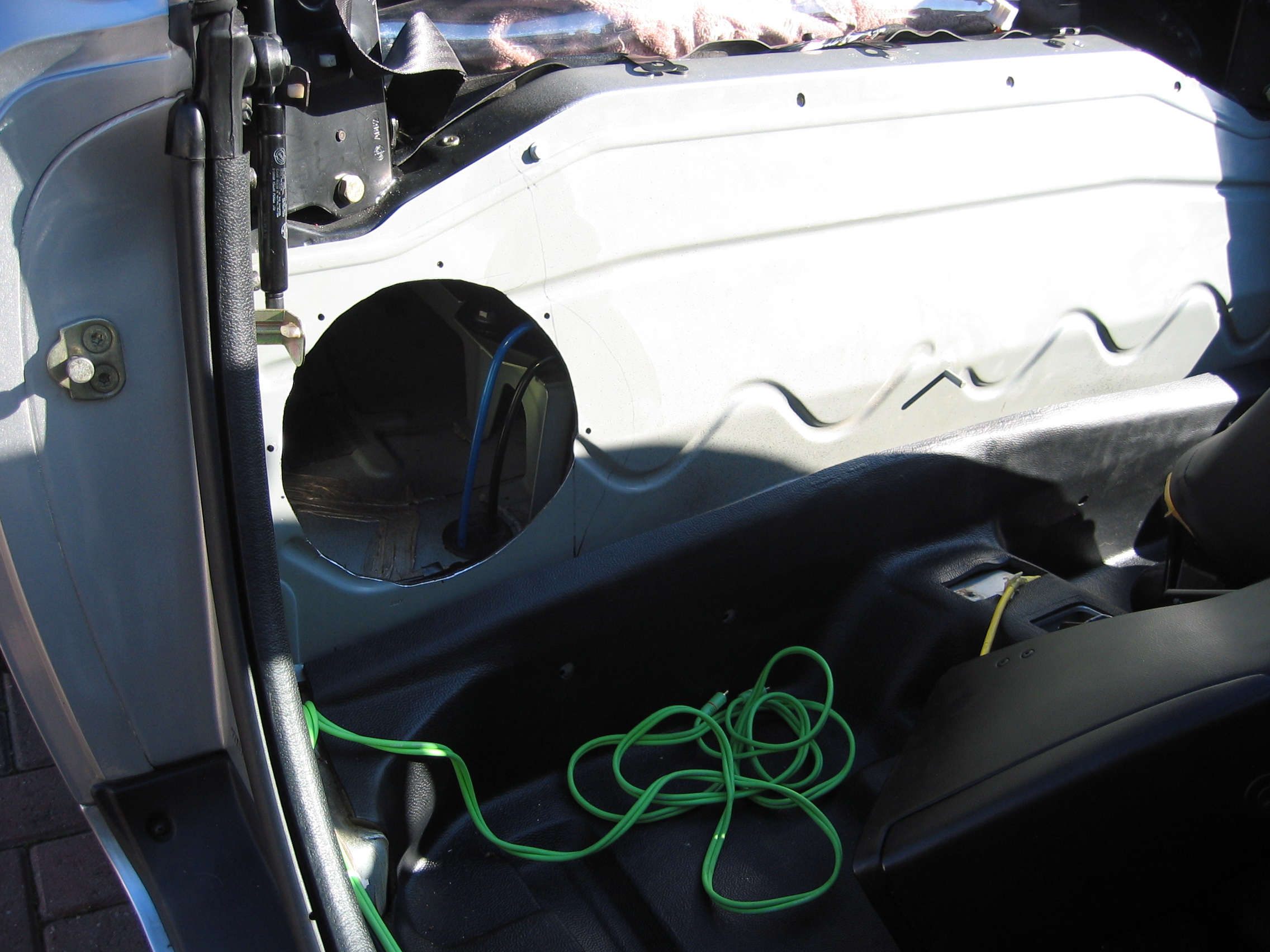

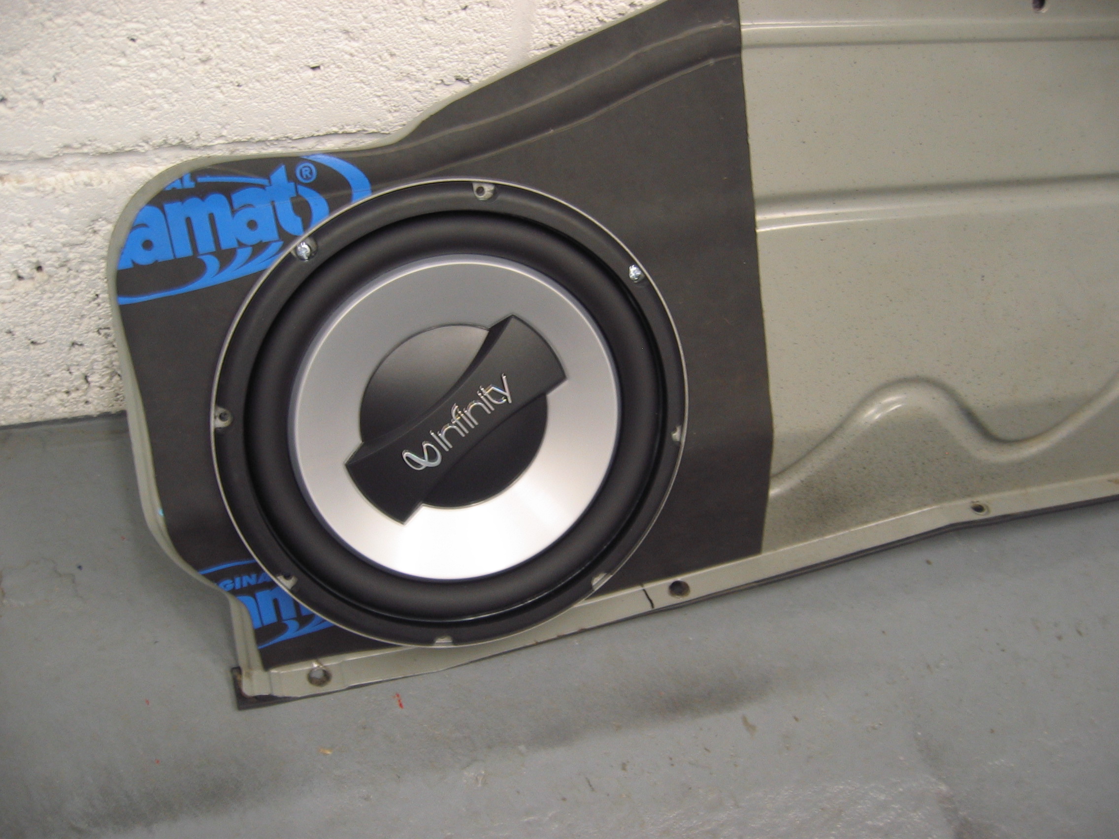

I mounted the sub behind the passenger seat in the bulkhead panel. I fitted Dynamat and speaker acoustic foam around the sub back to help with the response but at some point I will go back and try and make a box for it. The problem is the lack of space behind the speaker for a nice box.
The best place for the amps and CD changer is the boot but getting power and speaker cable from the front of the car into the boot is a nightmare job. :bang:
