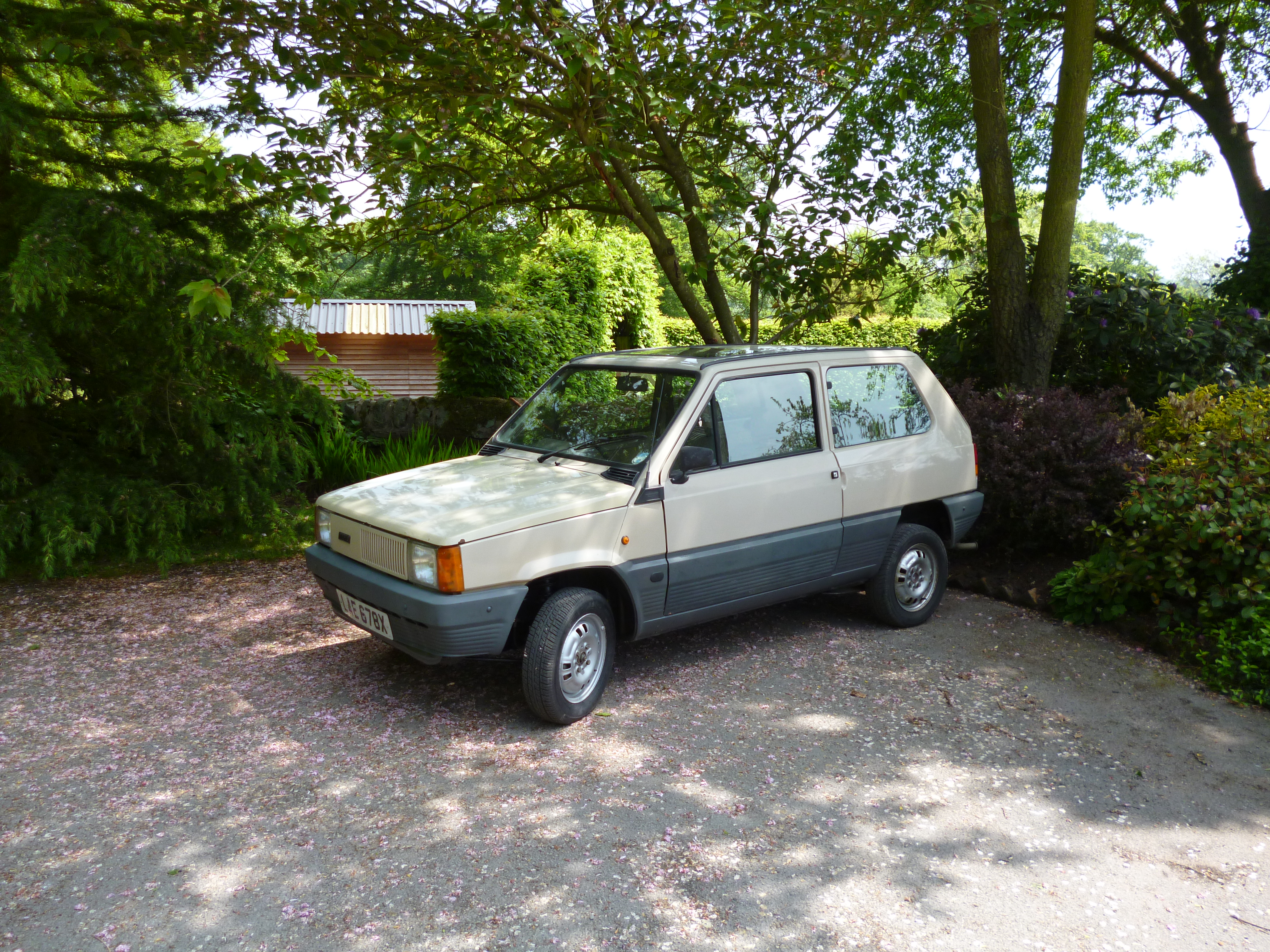

I'm pretty sure most of the Panda section regulars will know this car, but I thought I would post a few photos of the latest edition to my fleet.

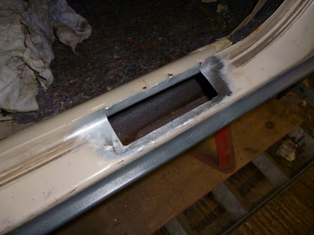

It is a early 1982 Mk1 45, previously owned by forum member Cacciatore, and is possibly the second oldest Panda left in the UK. Unfortunately it has failed its MOT on a couple of bits of welding and a few other things, but I am very impressed at how solid it is especially for a 30 year old Fiat!
We picked it up last night and I was a bit worried it wasn't going to fit on our trailer! Luckily it did, just!

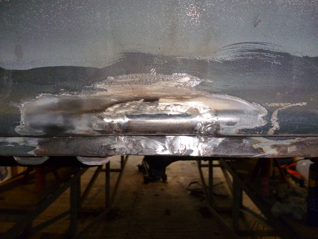

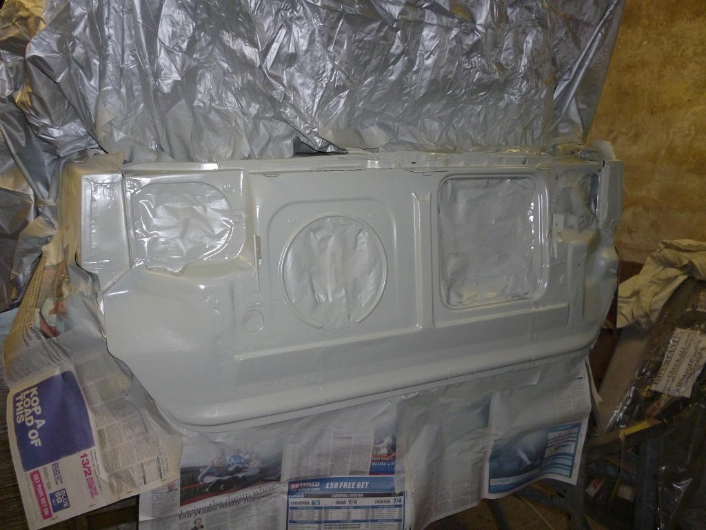

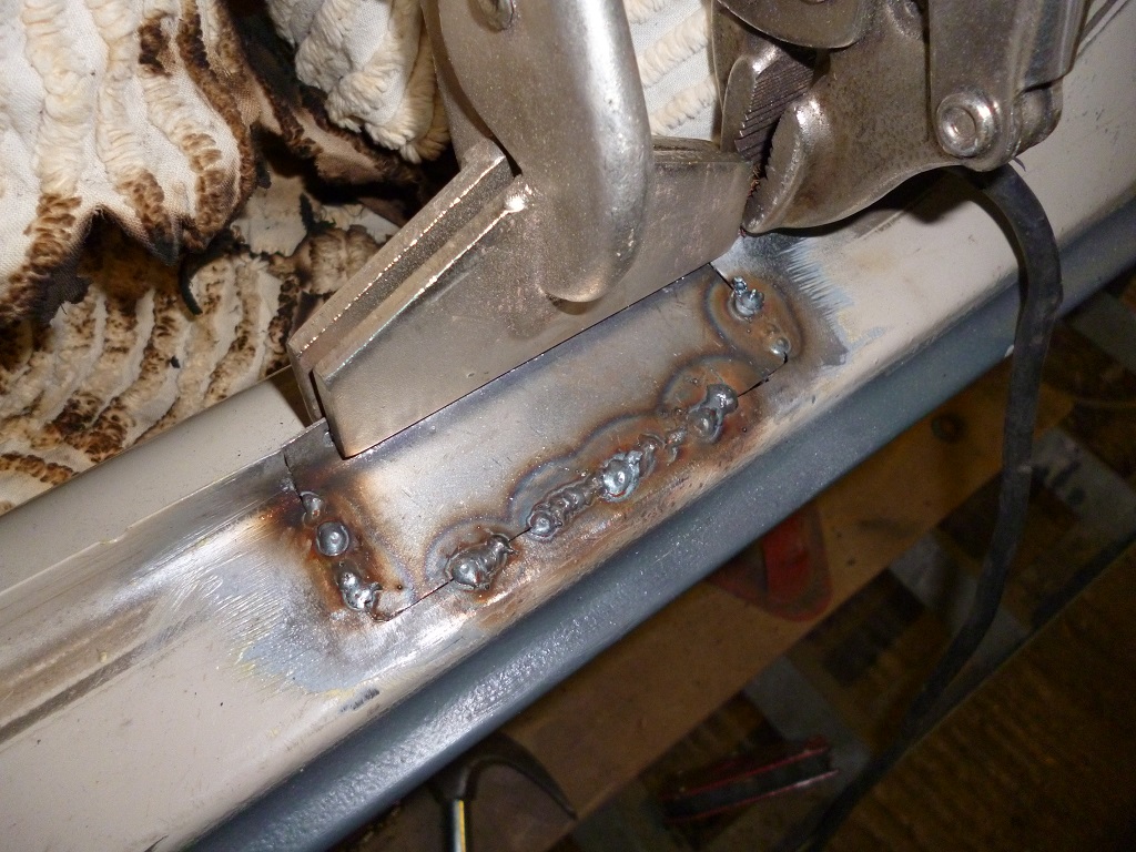

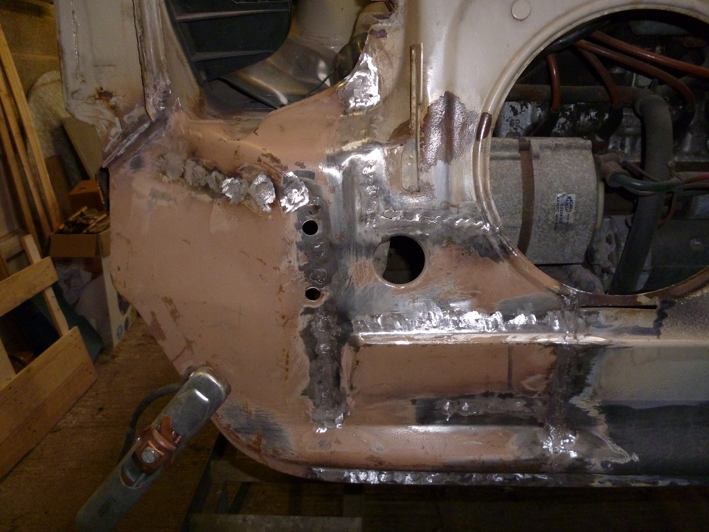

More photos, I've finished welding in the front panel section on the drivers side, done the same to the passenger side and also a small hole in the middle, I've also repaired the hole in the drivers side door jamb/sill and I've now started to paint everything. The front panel is in primer, which is surprisingly close to the colour of the car!

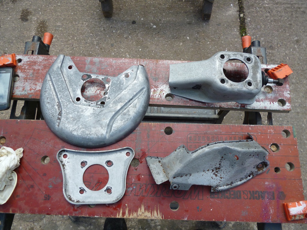

I've stripped the suspension, de-rusted with Deox-C and then painted with black epoxy mastic.
Yes, those are the original 31 year old brake disc guards:eek: Infact all of the suspension appears to be original and is all still perfect, apart from two balljoint gaiters (damaged by the person who changed one of the wheel bearings it seems(n)) and both shock absorber protectors.

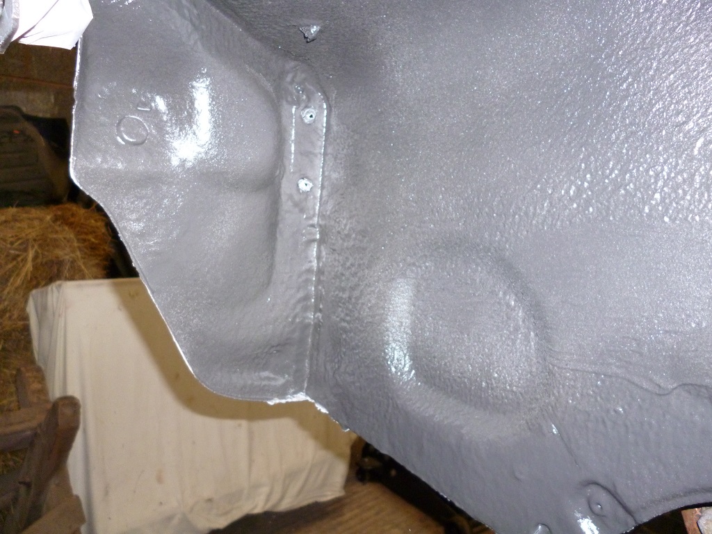

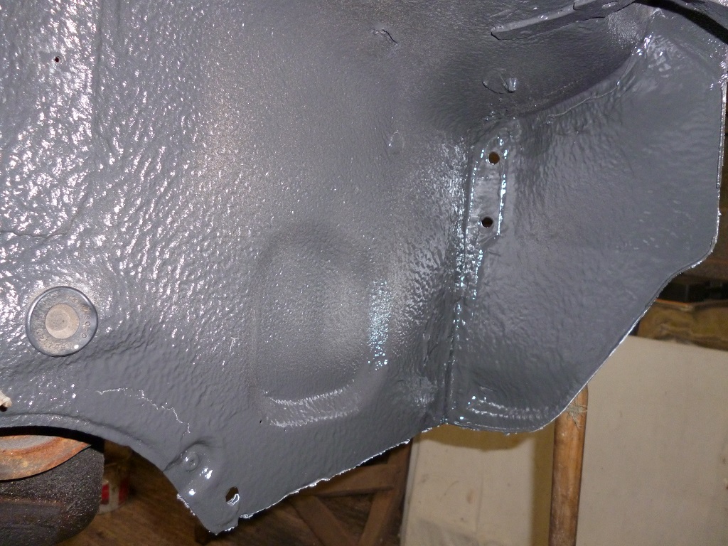

Its now all back together but no photos of that, looks good with the freshly painted inner arches though(rears done also)

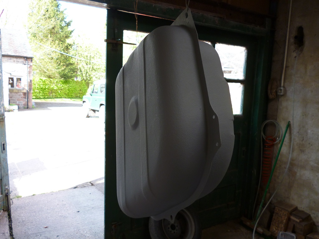

Also took out the fuel tank as it was looking abit sad, all cleaned up ok though and was given a coat of Hydrate 80, zinc primer and then stonechip. Think I will give it a coat of the hurricane grey I used in the inner arches to finish it off as I have some left.

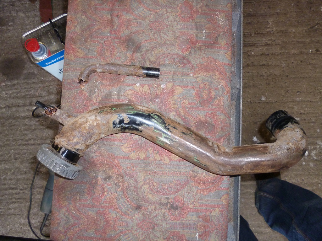

Unfortunately the filler pipe is not so good, the breather has gone rotten and snapped off, hopefully it can be repaired as I don't think I'll find a new one in a hurry.

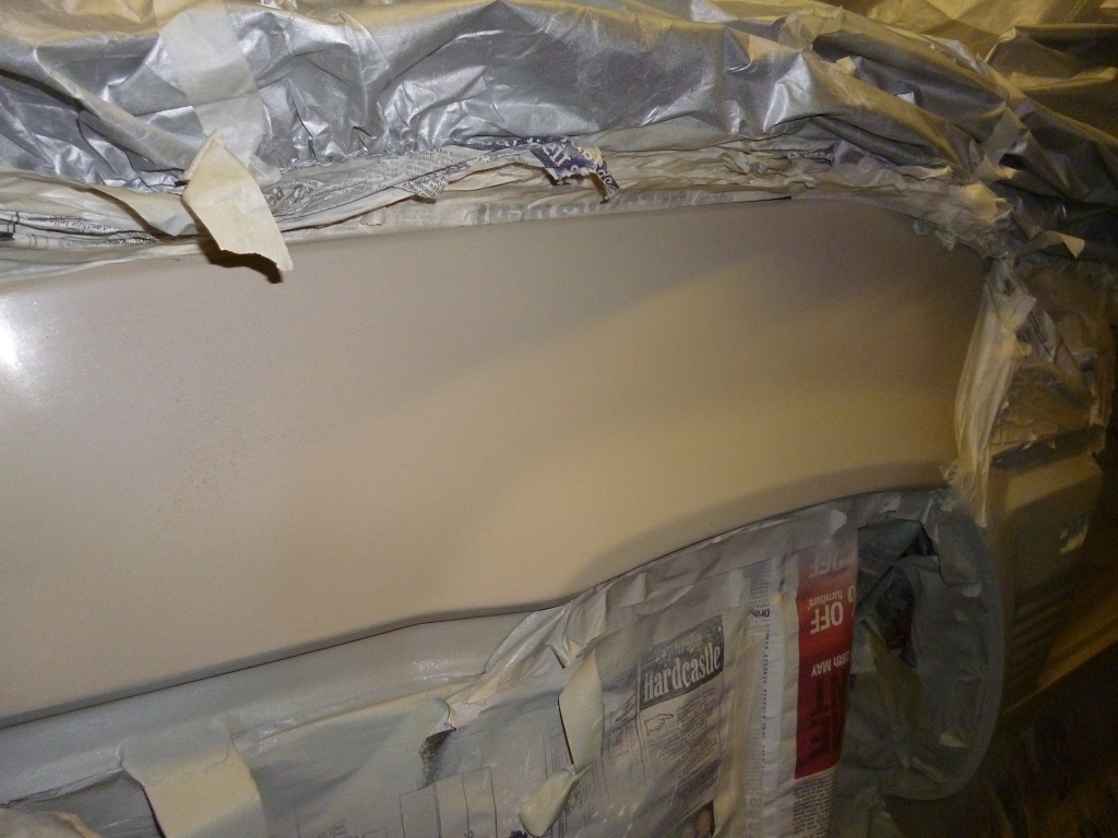

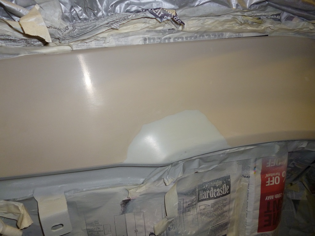

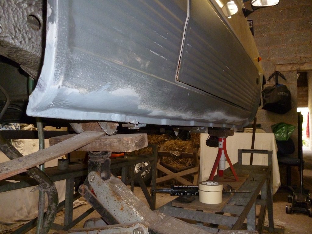

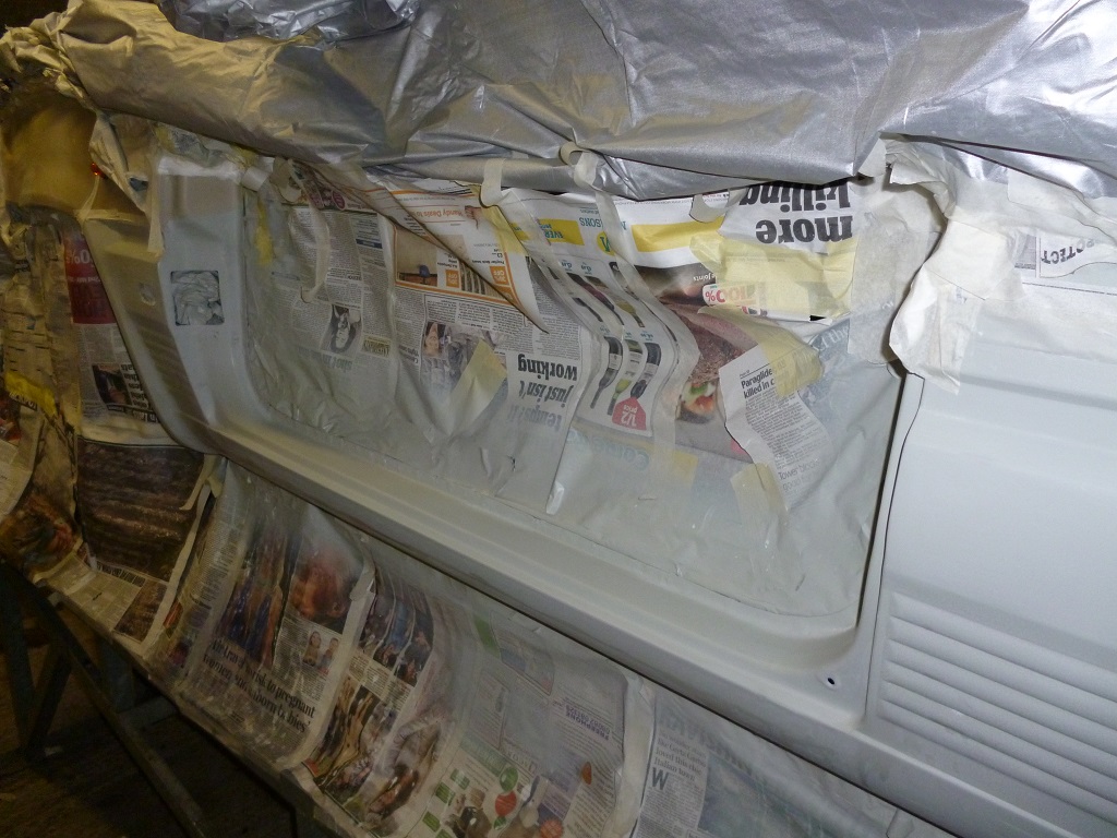

Today I have finished painting the sills, which I am very pleased with
I have also done a 'blow in' on the the front arch as there was some surface rust, turned out pretty good I think, the colour match is spot on.

My thought was to remove the bit that has snapped off back at the main pipe and get a new 180 degree bend that can be brazed in. I'm waiting for my Uncle to come back from holiday to do it for me though as I've never done any brazing, I think the metal might be abit thin to weld:(
