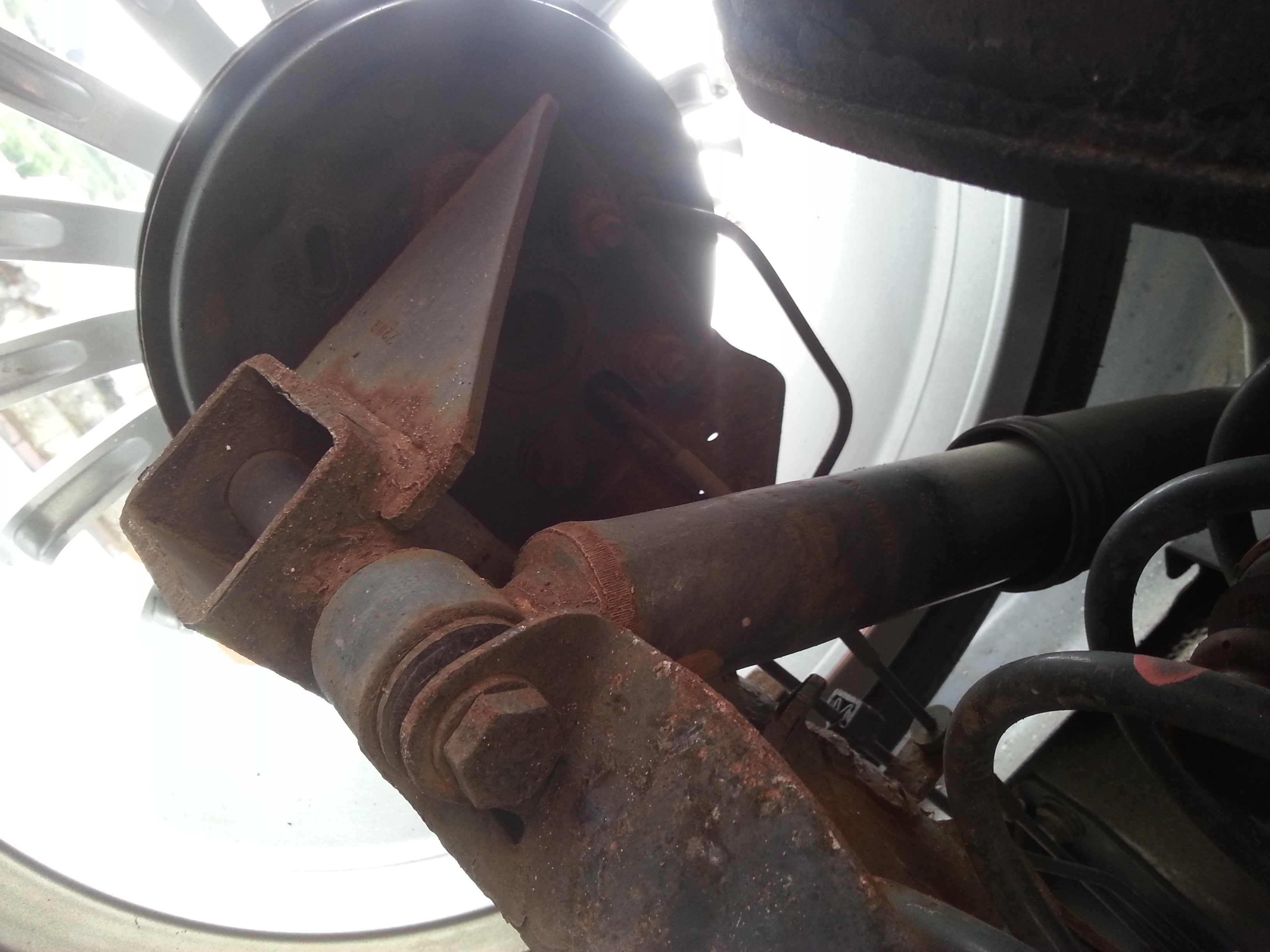

Here we have the beam axle, it's got surface rust on it, not an issue at all. To the right you can see the fuel tank poking out, it's plastic so it's not going to rust or get the mythical crud that fuel tanks apparently get in the bottom :)

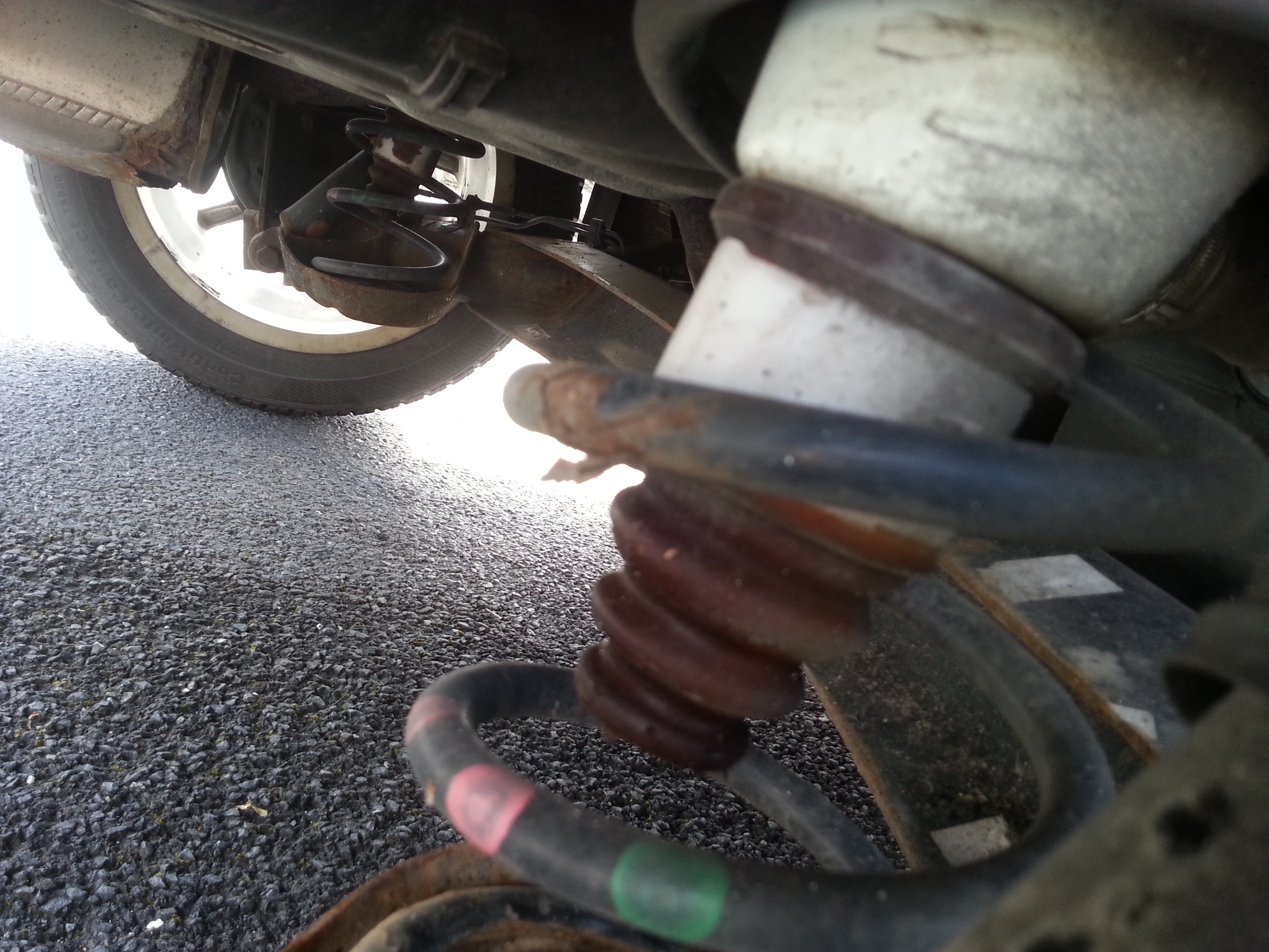

Here's a spring, the paint/powercoat has come off. This is actually an issue as it will create a weak point and will crack one day.

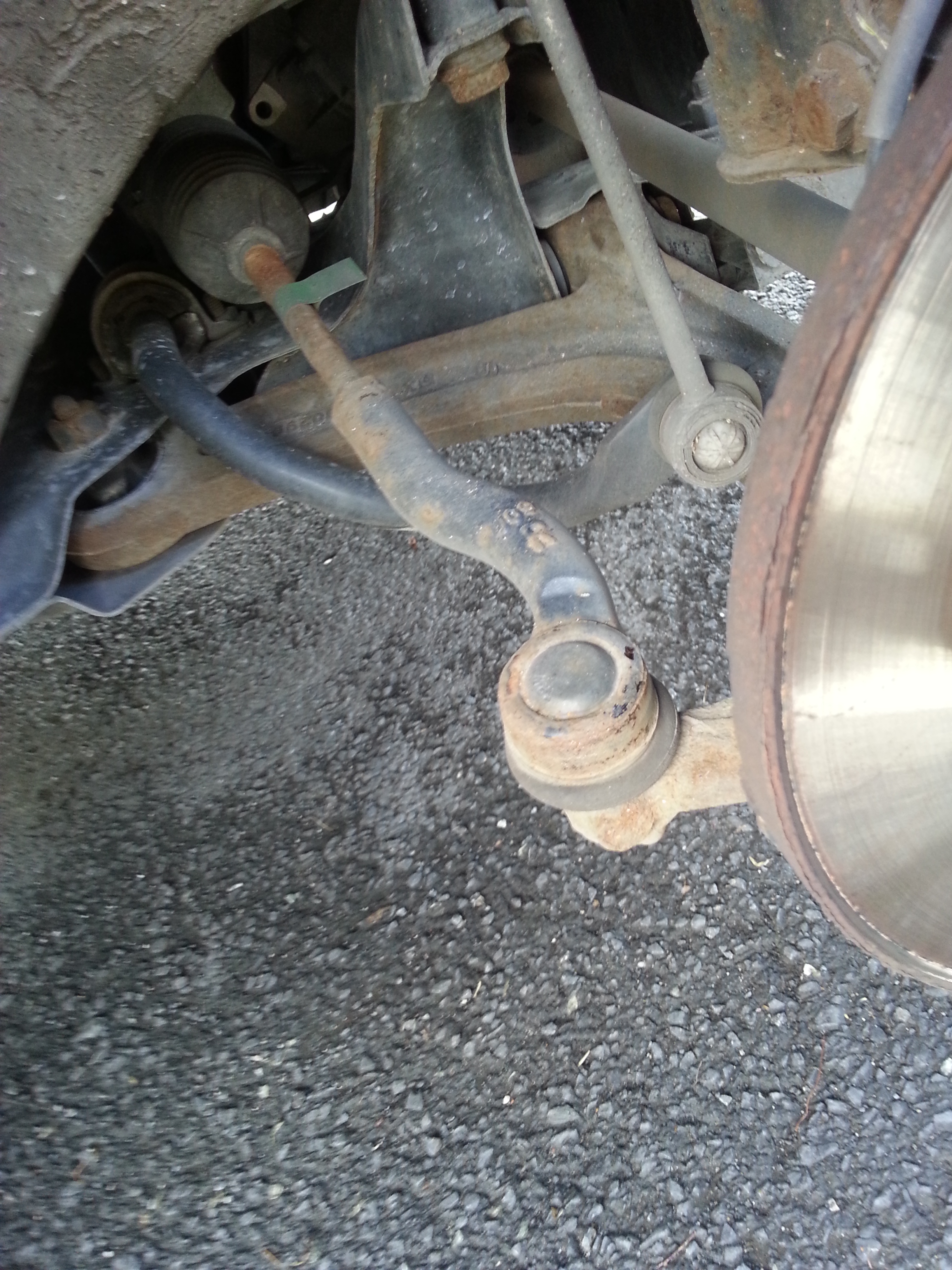

here we've got the front suspension arrangement. Bit of surface rust on all the fasteners, the bottom of the strut and the rack end (the bit that the tie rod end attaches to) is rusty, but nothing to be concerned about :) The silver thing running from top to bottom in the photo is the droplink, a common failure on 500's and Panda's and very easy to replace. Check that the rubber boots on the balljoints are not damaged, open or missing.

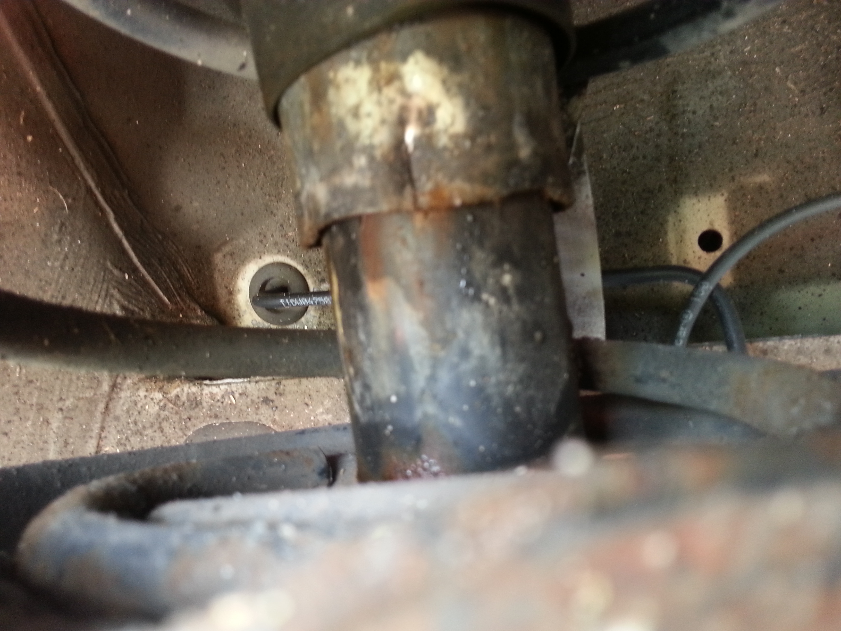

This is the base of the spring cup on the front strut. You don't want to see moisture here ordinarily, we had torrential rain here last night and the car hadn't really dried out properly, I suspect there's a tiny weap from the front strut but nothing to worry about. If it's wet and oily here and it's not water then you've got problems.....

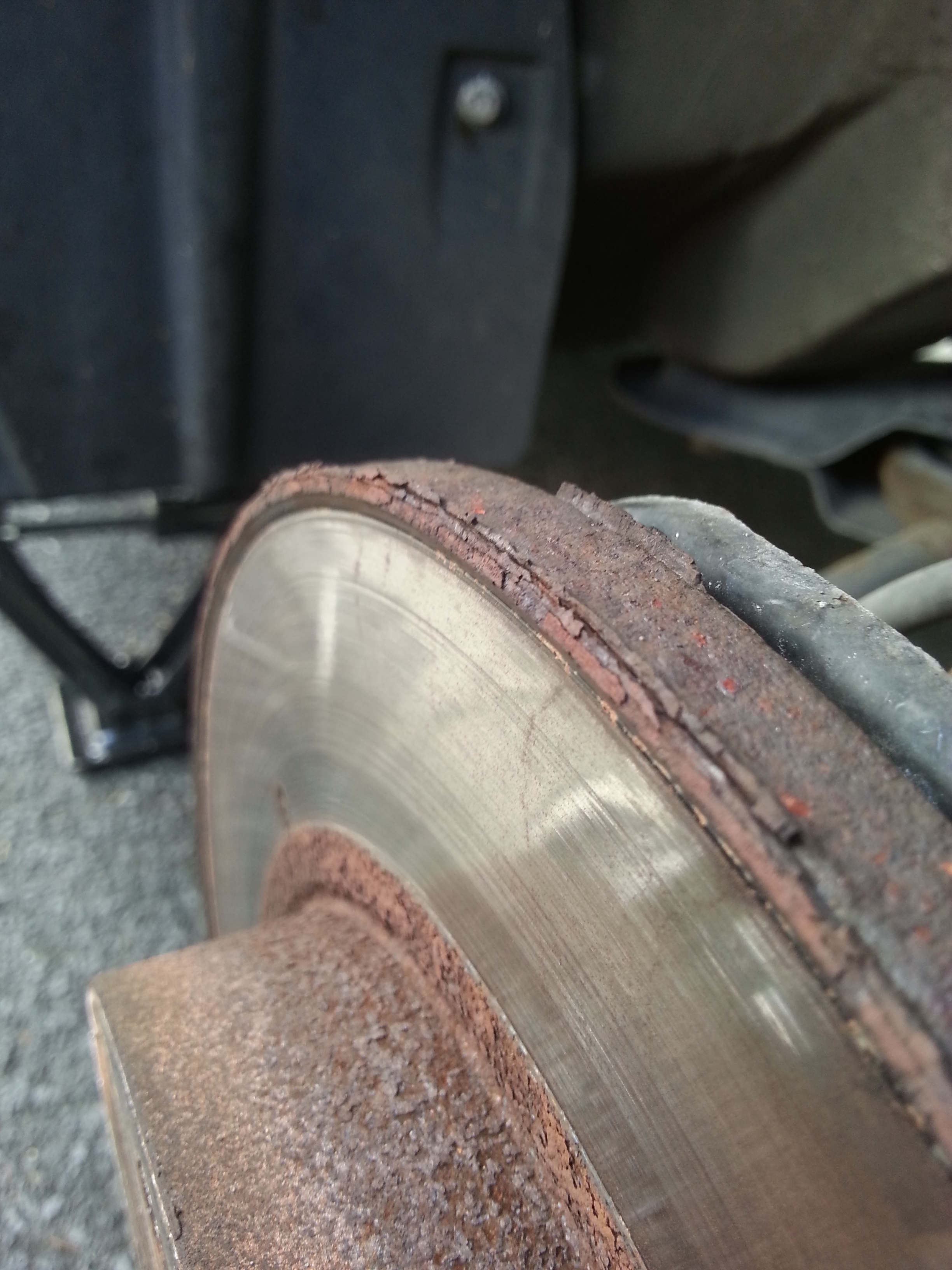

Here we have the front brake disc on a 1.2. These are not the original discs, they're Brembo's so they have 2 dimples on them, 1 which disappears when the discs are half worn and another that disappears when they're completely worn. I've done 40k miles on these and they're not even half worn.
There is rust and a slight lip but it's just cosmetic and not an issue.

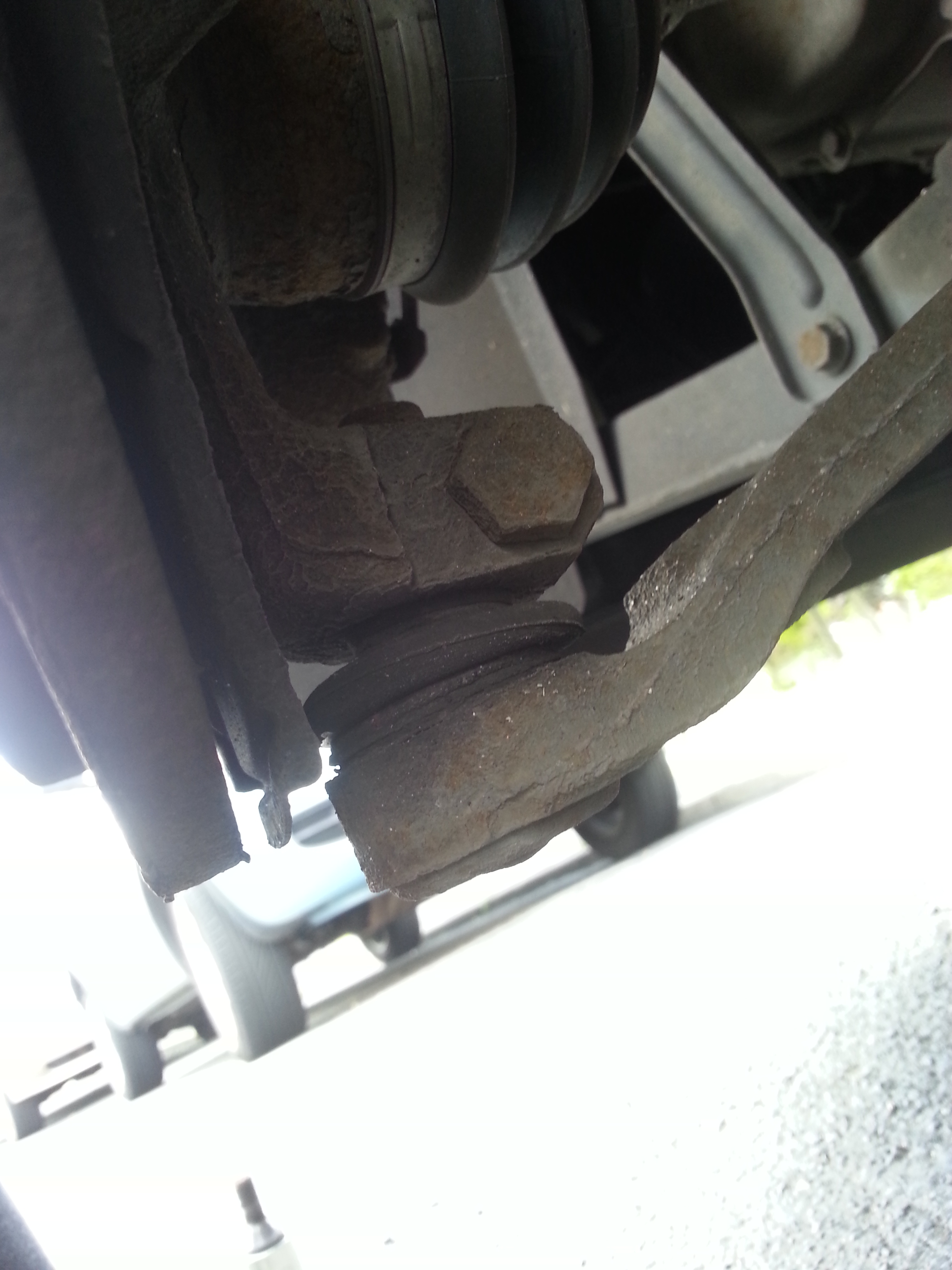

Balljoint on the front suspension arm, check the boot isn't torn, detached or missing, if it is it's an MOT fail. CV boot is the accordion looking thing at the top of the photo, same rules as the balljoint boot, if it's torn, detached or missing it's an MOT fail, but if it was torn or missing then you'd soon hear it.

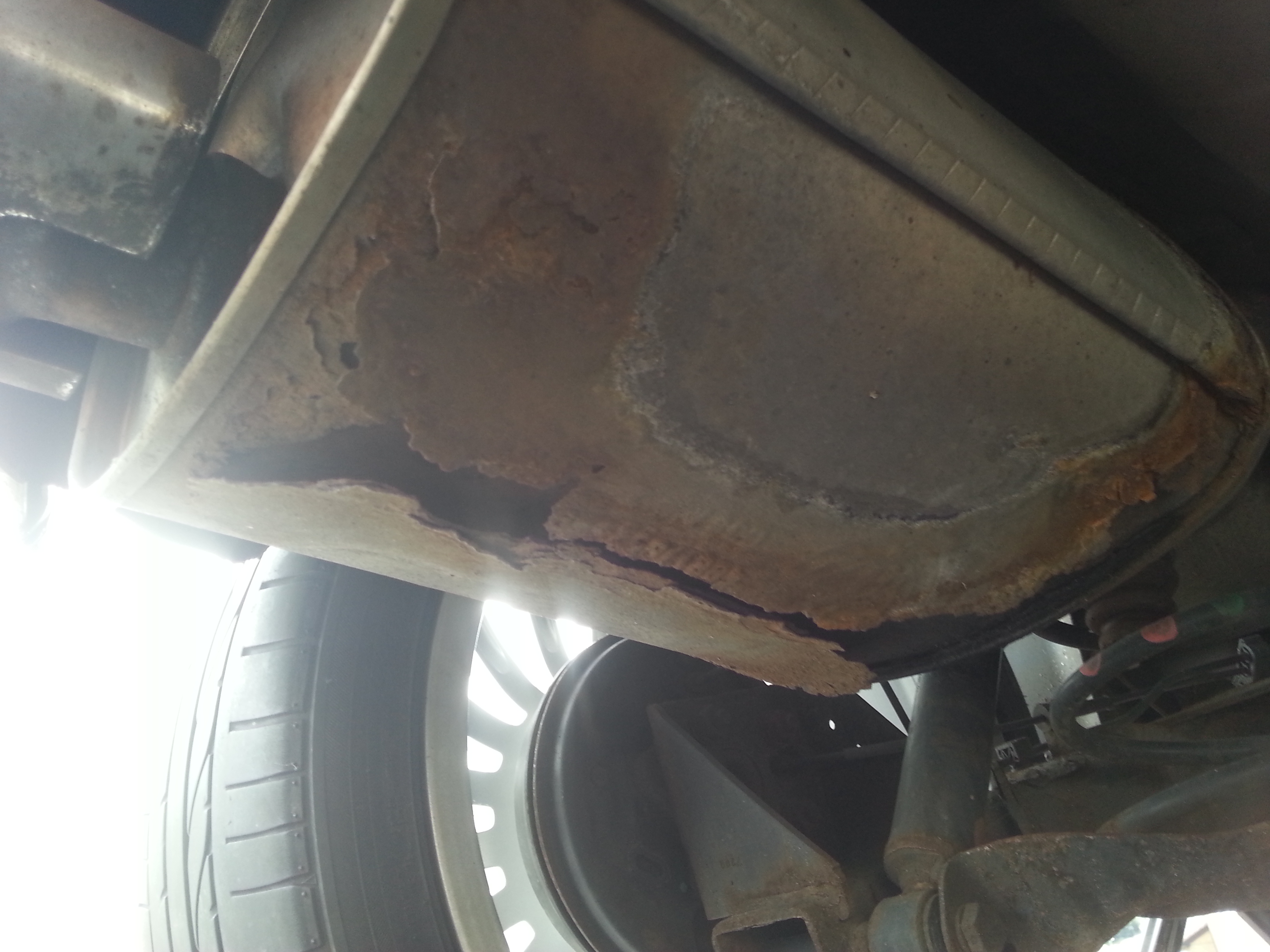

Here's the exhaust backbox and she is quite crusty, as it is it should get an advisory for being significantly corroded, but as you can see in the second photo, the inside is still intact so it shouldn't fail. When it get worse and start to leak then it'll get replaced with a stainless steel box which will last the lifetime of the vehicle. 5 years and 65k isn't terrible though, on the other hand neither is it fantastic. Also note the ridiculously clean wheels ;)

View from behind the passenger side rear wheel. Lots of surface rust as you'd expect but the bits that are important like the brake pipes are still fine and all the cables are attached to the rear beam as they should be. Wheels are nice and clean aren't they! :p Damper isn't leaking which would be an MOT fail. Somehow I've forgotten to take a photo of the bush at the top of the rear dampers. Common issue and usually fairly easy to spot as the bush separates from the metal sleeve in which it sits.
Yeah maxi my exhausts looks better than that but it must be the fact that it really doesn't rain so much in Greece. The UK's climate is much harsher on cars in terms of rust.
I'd be surprised if yours doesn't last past 10 years
Firstly, some bloody good photos for all of those who never, ever bother to have a look under their car. I'm one of those 'freaks' who has the wheels off regularly on both my cars, wiping down coil springs, control arms, brake pipes, you name it, anything accessible and visible. As ahmett has pointed out and which we Brits all know, our winters do no favours to the underside of cars with the amount of road salt chucked down year in year out.
I picked your coil spring photo out for the reason that I just recently replaced both front coil springs (including shocks and top mount bearings) on my other car because of corrosion and pitting which as you are very correct in saying, will eventually snap, often in mid winter when the temperatures have dropped and the metal is really cold. For those people that don't believe coil springs snap often on cars, you only have to look at the side of many A roads, dual carriageways and motorways to see bits of broken coil spring.
Yeah, poor quality steel and rubbish quality paint/powerboat sadly does that to a car. I had a front spring break on my 406 when it was about 10 year old with 100k miles on the clock. Subaru still has its original springs and is twice as old with more than twice the mileage.
When suspension bits go on the 500 it's getting b14's which will last far longer :)
My other car has only done 40k and just the offside coil was pitted, powder coating had come off a treat. Obviously, it is best policy to replace both coil springs at the same time, so that is what I did. Thankfully, I am a very competent home mechanic, so I changed both sides myself, just over 1.5 hours each side. Saved a fortune doing it myself. :)
