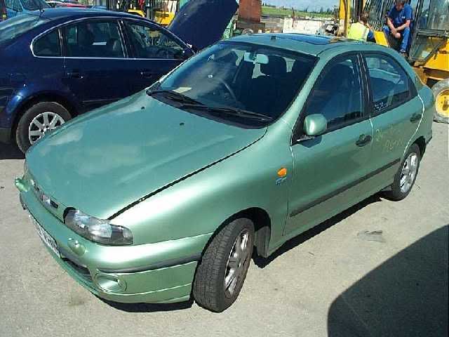

finally got my paperwork and now im the proud owner of my brava elx, unfortunately the remote only locks and alarms but doesnt unlock when de-arming nut its fantastic and fun to drive
p.s hope someone can help with the remote issue
