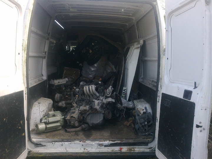

And a Ducato full of engines
All revealed just this once! ;)
