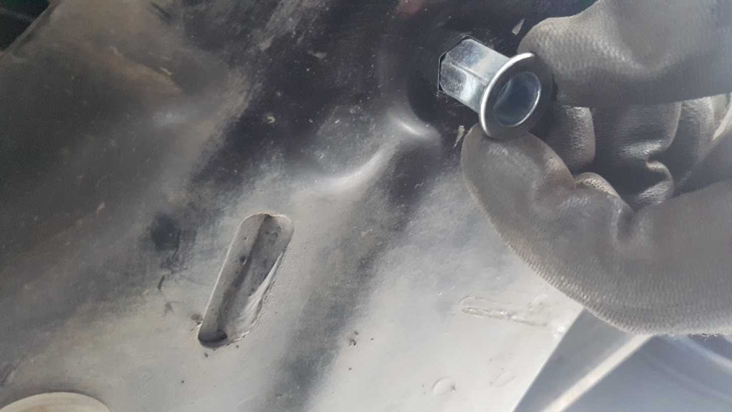

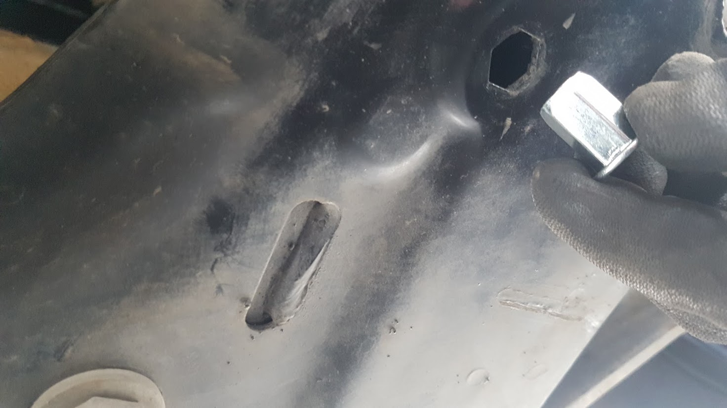

I have also a 2016 ducato motorhome & I raised the issue with Fiat but its not fitted to most ducatos coming to the UK so I bought a new set online & it seems that they have like a hexagon insert that pops into the passenger wishbone but you cant get it to fit from the top... I will be looking and a two part glue to secure them in as there are about three that will need to be done. I might just have another bash at it this weekend.
meureire They look like rivnuts, If they are they need to be fitted by crushing them in situ to create a captive nut in a place that you can only access one side, like a blind rivet.
see video
https://www.bing.com/videos/search?...C1E01AB0486448122A1FC1E01AB04864&&FORM=VRDGAR
Mike
what a star you are!!!! Brilliant.... ive now fitted the under trays last night.. so thank you ever so much!!!!
