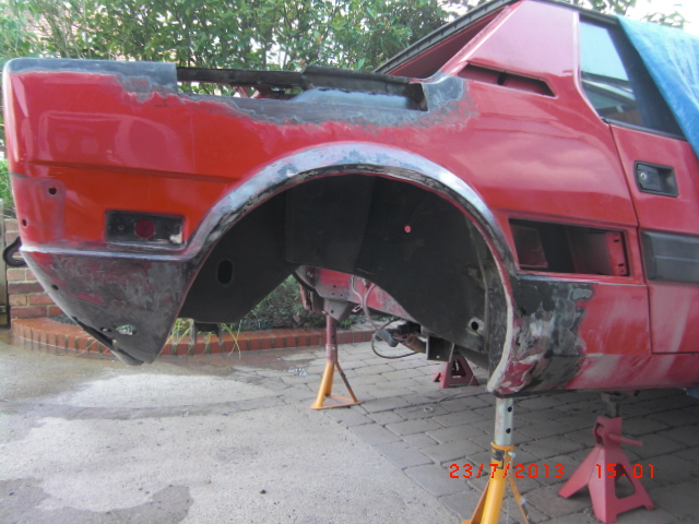

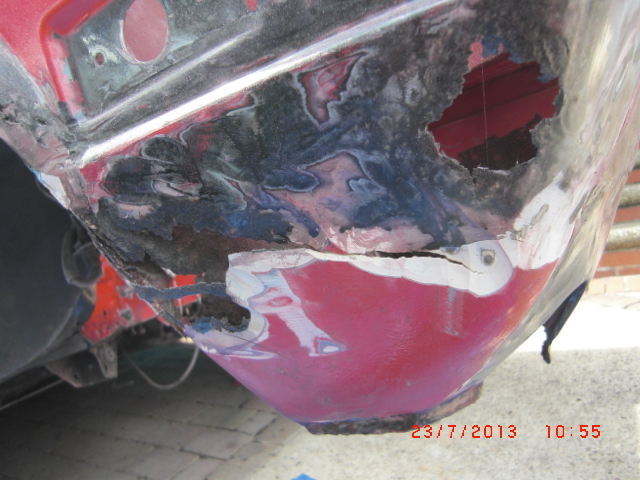

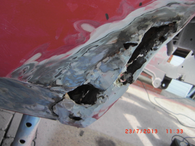

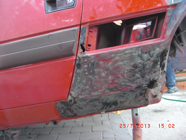

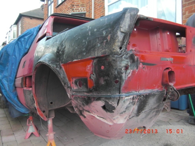

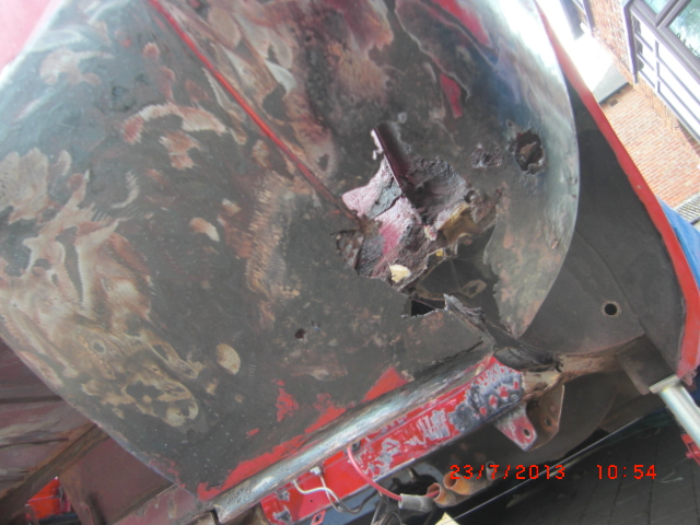

Well if you like the look of those pictures have a look at these, once we stripped some more paint off both rear wings we discovered the need for more metal work.
See what you think!!!

These are all I have of this area at the moment, but I'll post more as we progress.
Yes I can weld and fabricate but I only have a small work shop and space is premium at the moment.

That's a lot of filler covering a multitude of bodges and we know that the person who had the work done was more than likely well and truly taken to the cleaners, that's going to be a long project I've had my project up or the roll over jig for 5 months now and am still fabricating and welding on the last wheel arch then I've still got to make new floor pans and fit them but i did have to take time out to weld up and spray my Rover 220 turbo Coupe so guess i'm not doing too bad!
Hope you can stick with it and bring her back to health.
It sounds like you have a fair bit on yourself that rolling jig also sounds like a good idea I wouldn't mind one of those myself.
I don't think I've landed myself in it, it was something we chose to do so we'll keep plodding away it's just sad that previous owners didn't apply a bit of TLC.
