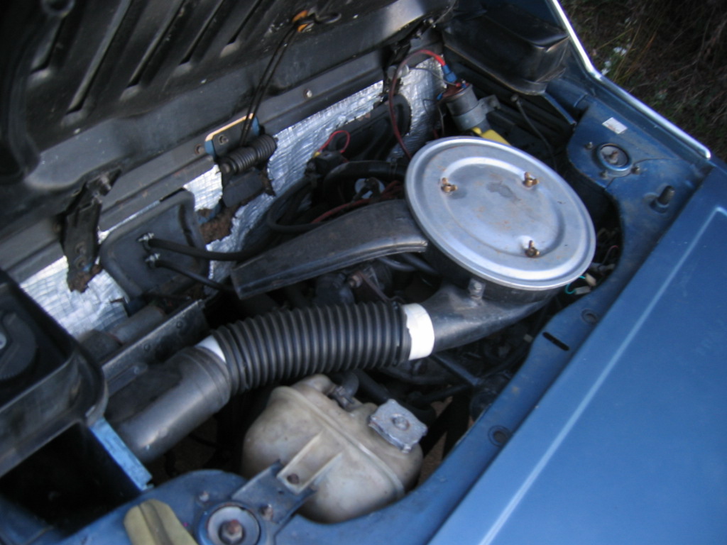

I have also built a catch can now - mostly out of random bits that I have found in my garage :)
The bits I found;
Tube - random leftover exhaust tubing. This isn't as thick as it looks, it is just the way it looks after my veeeryy cheap 2" pipe cutter (that has been slightly modded to cut 3" pipe) has been at it..
The endcaps are made from computer case (which also saw use in the dizzy inspection plate mods), the smaller tube is from the fuel pickup from a Lada stationwagon, the larger tube is the dipstick guide from the original X1/9 engine.
I did have to buy some stainless steel wool that is packed down the bottom between the two tubes, but my wife bought that while she was shopping, so effectively free :rolleyes:
O and I did buy a wee air filter thingy for $8.75 to stick on the top.
Weldy weldy weldy...
I also found some Festo push in right angle fittings..
Once it was all fitted up, I had to chop a bit off the can to clear the air filter, but other than that it is not too bad a fit.
You can just see the can behind the air filter in this shot...
And one last shot for posterity;
