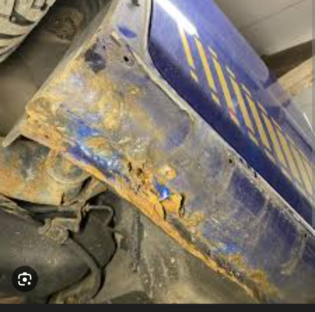

Look carefully at the rear axle
Also check for bubbling paint on seam where the outer sill meets the floor pan especially the passengers side about 3" from the rear wheel arch,

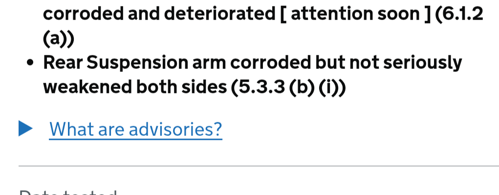

Struts, suspension arms, exhaust also advisories on the MOT
Don't worry, I am aware about the corrosion and I know how to treat it. Thanks for the heads-up though.
