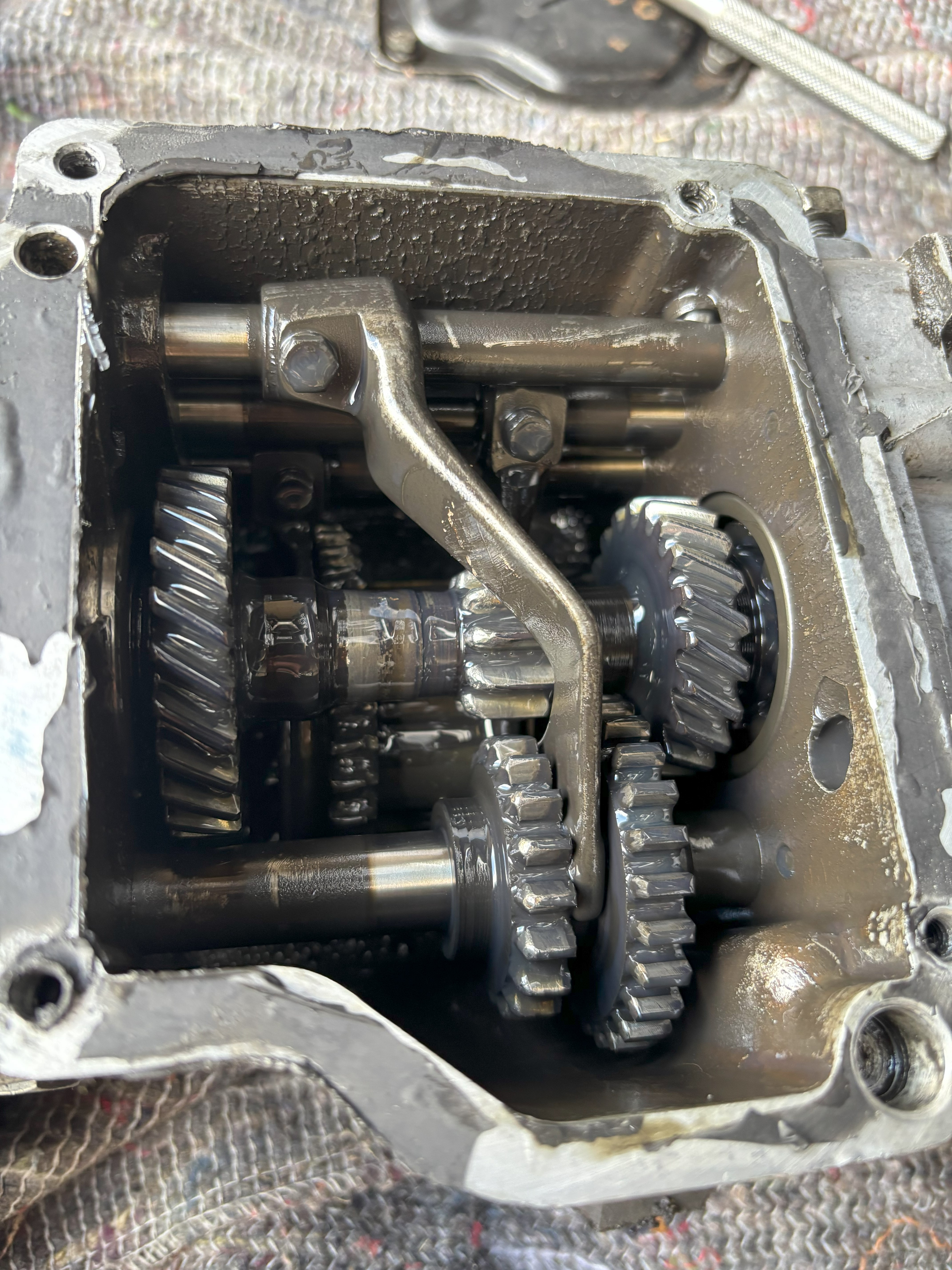

Sorry to hijack this topic from last year, but I have the same question that is only partially answered.
I have a 3 bolt starter motor on top (1968 500L).
Since I'm having issues with a few gears it is hard to tell. First gear and reverse need to be replaced, but for the other gears I am able to shift up without double clutching. I am not sure if I coincidentally do it at the right moment, or if the gearbox has been synchronised.
What other ways are there to determine this?
You can shift up without double de clutching in both gearboxes. The non-synchros box just needs a little pause on the way to be smooth.
It’s the downshift where double declutching is really needed.
So if you can downshift ‘normally’ like a modern car, you have the later synchronised box.
Downshifting without double declutching works, albeit with a some resistance. I assume that is because it is simply not a modern car, but if double declutching would be "really needed" then I'd notice I guess.
Anyway to tell by looking on the inside? I have the gearbox removed at this moment to renew first and reverse gear.
