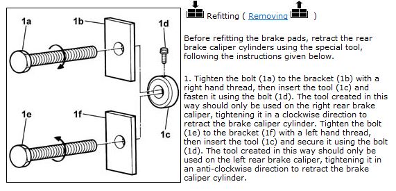

Also changed rear discs n pads other day and did fronts today, didnt see a need to re-bleed as not let any air into the system and half used a bleeding kit bit by when winding and pushing pistons back to take the excess fluid out of the resevoir (as the pistons went back).All feels good and sharp, may try bleeding it all next week if i start to notice any sort of brake fade / spongyness (as had this before, but only after a week).
So, a big thanks to the info on this forum, oh to point out, both rear calipers wind back clockwise, not as someone said different on here... Both mind winded back clock wise.
