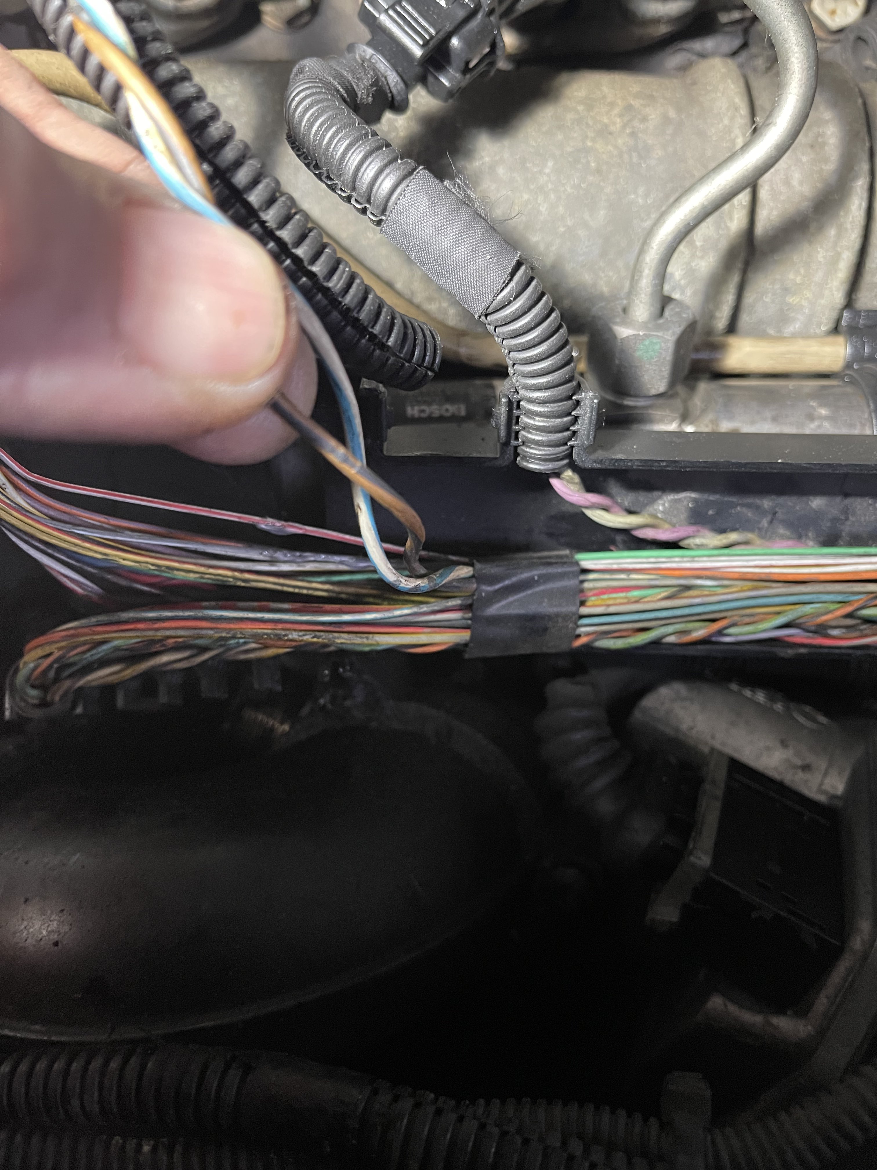

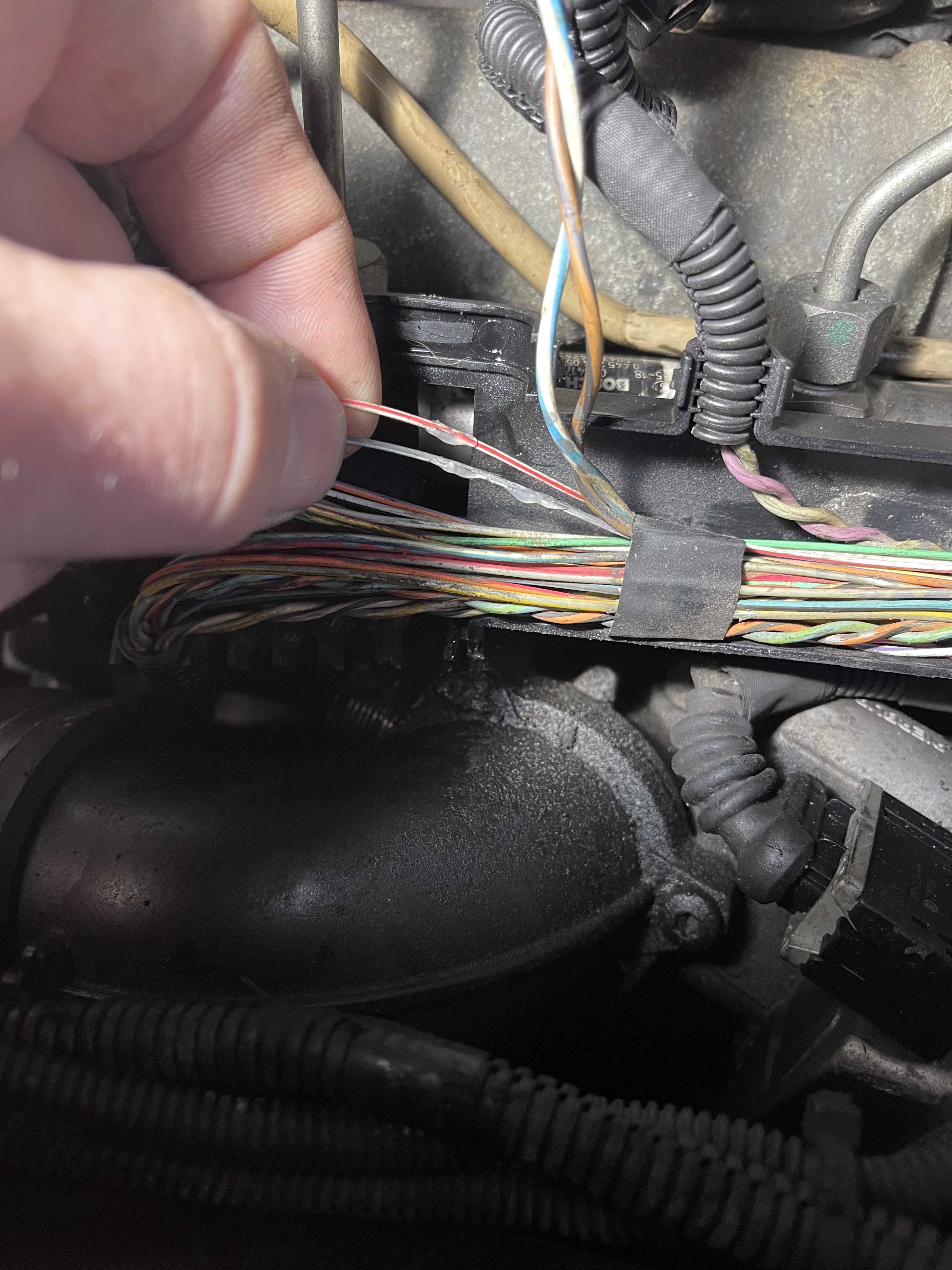

Hi Anthony found 2 chafed wires in loom next to injector 1 if it is on the left of engine ?😂 plugs on injectors seem perfect I sealed and insulated the 2 wires and insulated the injector wire put it all back together and it’s much worse makes me think I’ve unearthed the fault??

Hi
You might think that's a bad result but at least you have made a difference which means you are zooming in on the cause. If you have had any chafing then the finger of suspicion points at ALL the wires, not just the ones that look bad on the outside. It's quite possible to get broken strands inside the plastic sheath due to repeated strain and flexing.
One way to test a wire is to remove the connector from each end, then rig up a testmeter in a "hands free" manner using small sprung probes which can grab onto the relevant connector pins. Switch to an audible ohms/continuity range (i.e. with a bleeper), then work along the loom giving it a good tug and bend and listening for the slightest wavering in the bleep. However, be aware that if a high current feed wire to an injector is down to its last one or two strands, it might "buzz through" OK on the meter but the small extra resistance won't be helping.
A garage might try replacing the whole loom, but that's a long expensive job. DIY is possible with care, remembering that you don't necessarily have to bridge immediately either side of any break. There's nothing wrong with isolating a long bad section and putting in a long new wire starting near the beginning and finishing near the end. I recommend the use of soldered joints and heatshrink sleeving for this. If you have several wires to do, stagger the joints so you don't end up with one big lump. Even if you need to buy all the tools and parts it will still be a lot cheaper.
Happy Hunting !
