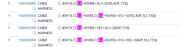

FIAT in the x250 has 3 wire looms in the engine compartment with the 2,2 engine. 11 different looms marked as 1 and 7 marked as 3. Depending on the van options. The FIAT part numbers are blue on the screenshots. I assume you're looking for the one marked as 3. If the diagram is relevant.
But I'm quite sure the parts shall bear two numbers for both computer systems in both factories.
EDIT: And I've just realized there are 3 different power versions of the same 2,2 engine. 74, 88 and 93 kW. That shall help narrowing the choice a little bit. Unless yours is 88 kW :D
